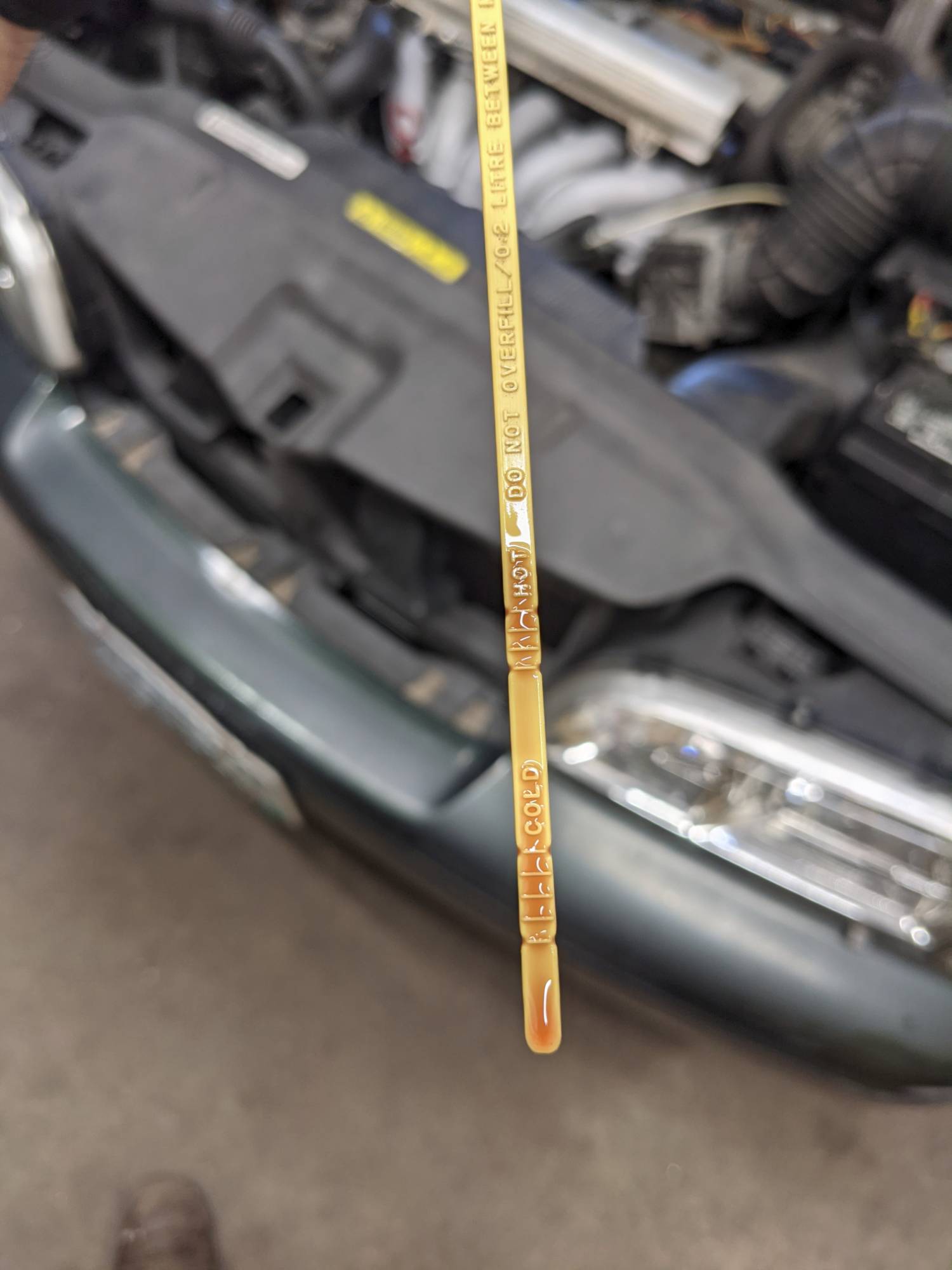

My transmission fluid appears to be quite overfilled (my fault). With the transmission at 80 C, the dipstick level was almost at the word "Do" in "Do Not Overfill". The next day with a cold transmission, it was at almost the same level. Both checks were with the engine off. When warm at idle, the transmission got to 87 C instead of the Haynes recommended 80 C.

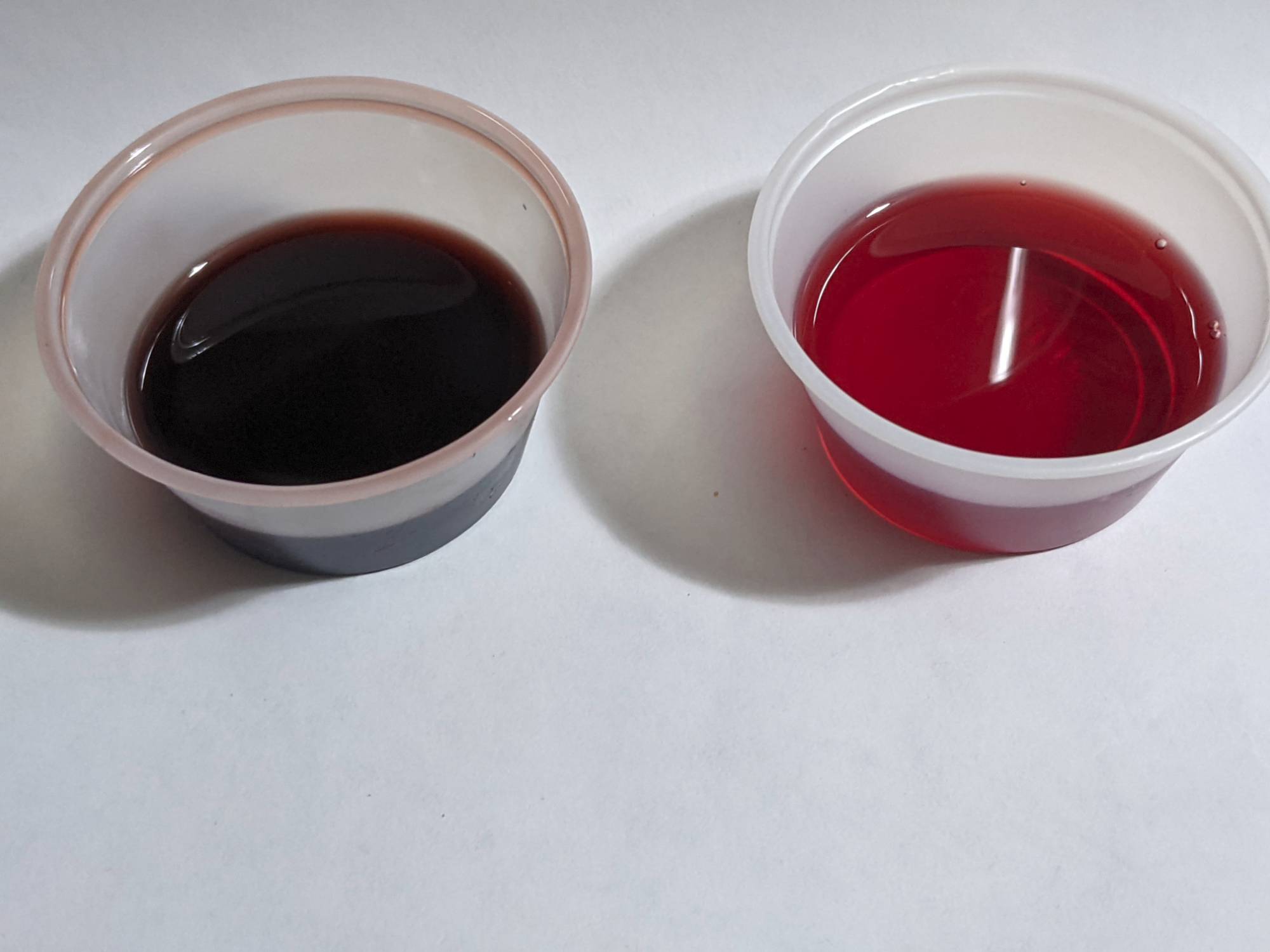

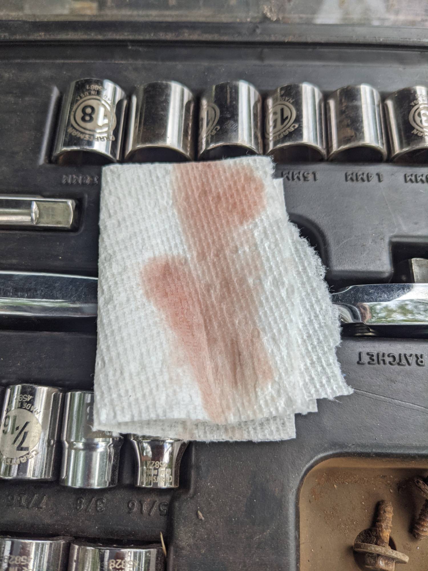

The attached picture shows the color of my transmission fluid (unknown brand and age) after the first drain. It's compared to new Aisin fluid, of which about 3 Liters was added. When wiping the dipstick on a rag, the fluid appears a decent red.

Overfilling will froth it and lead to shifting funnies. Definitely take your time, get the temp right, get the level right, idling in park after selecting all gears.

The color indicates that a drain n fill would be a very good candidate for What To Try™ after getting the level fixed up.
