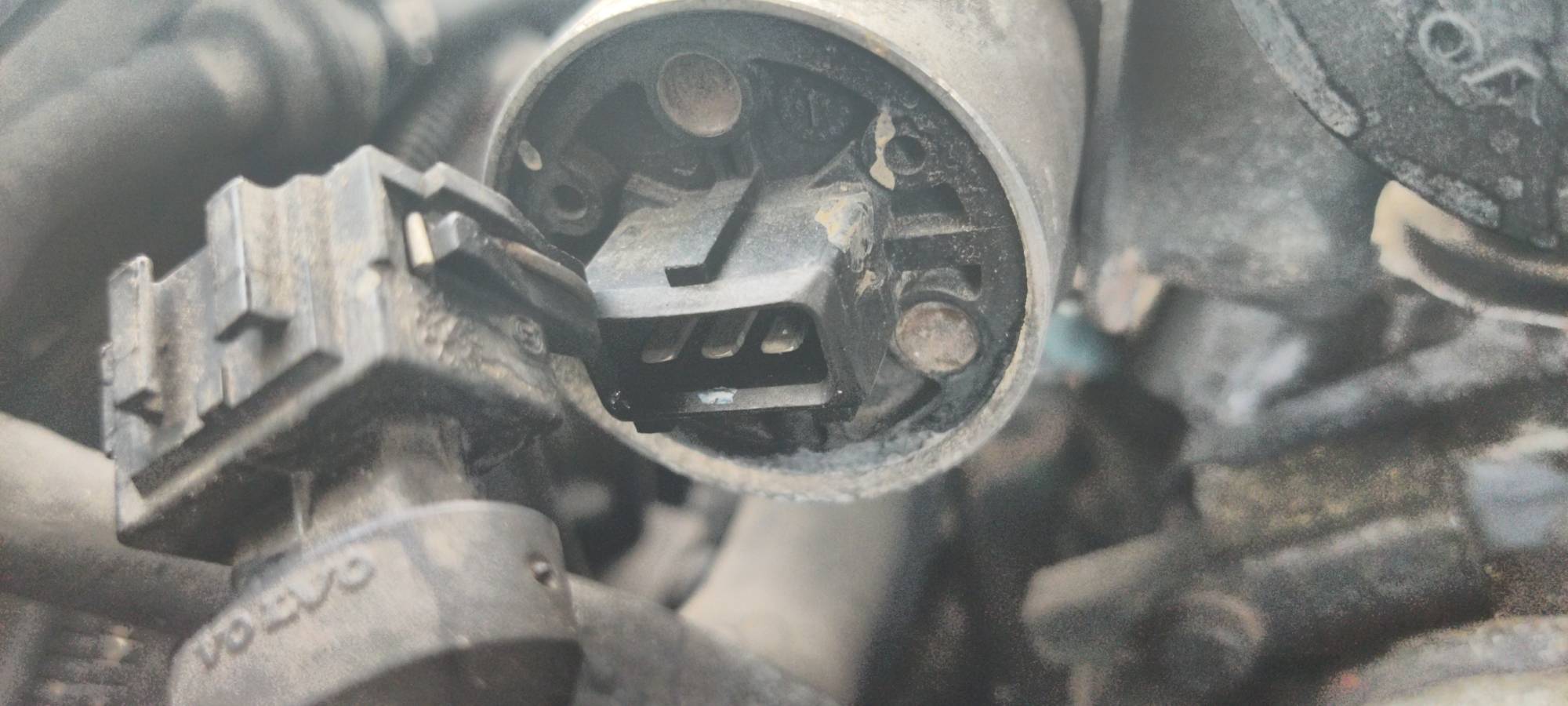

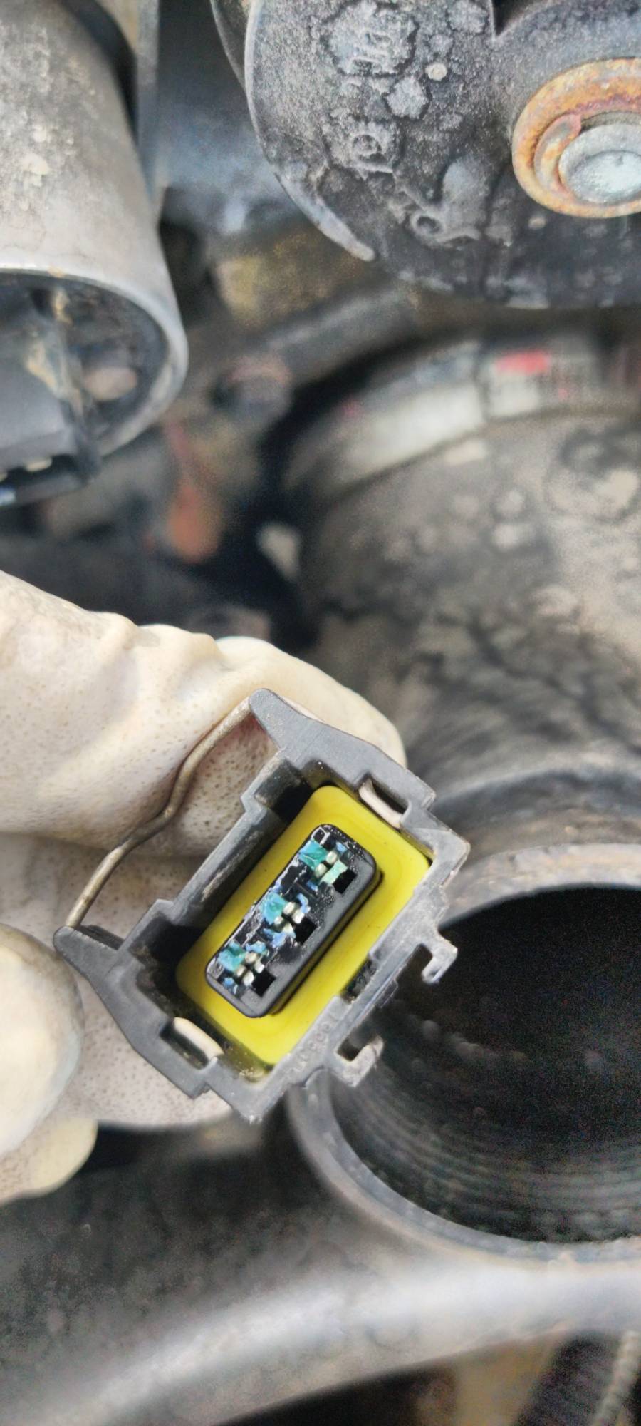

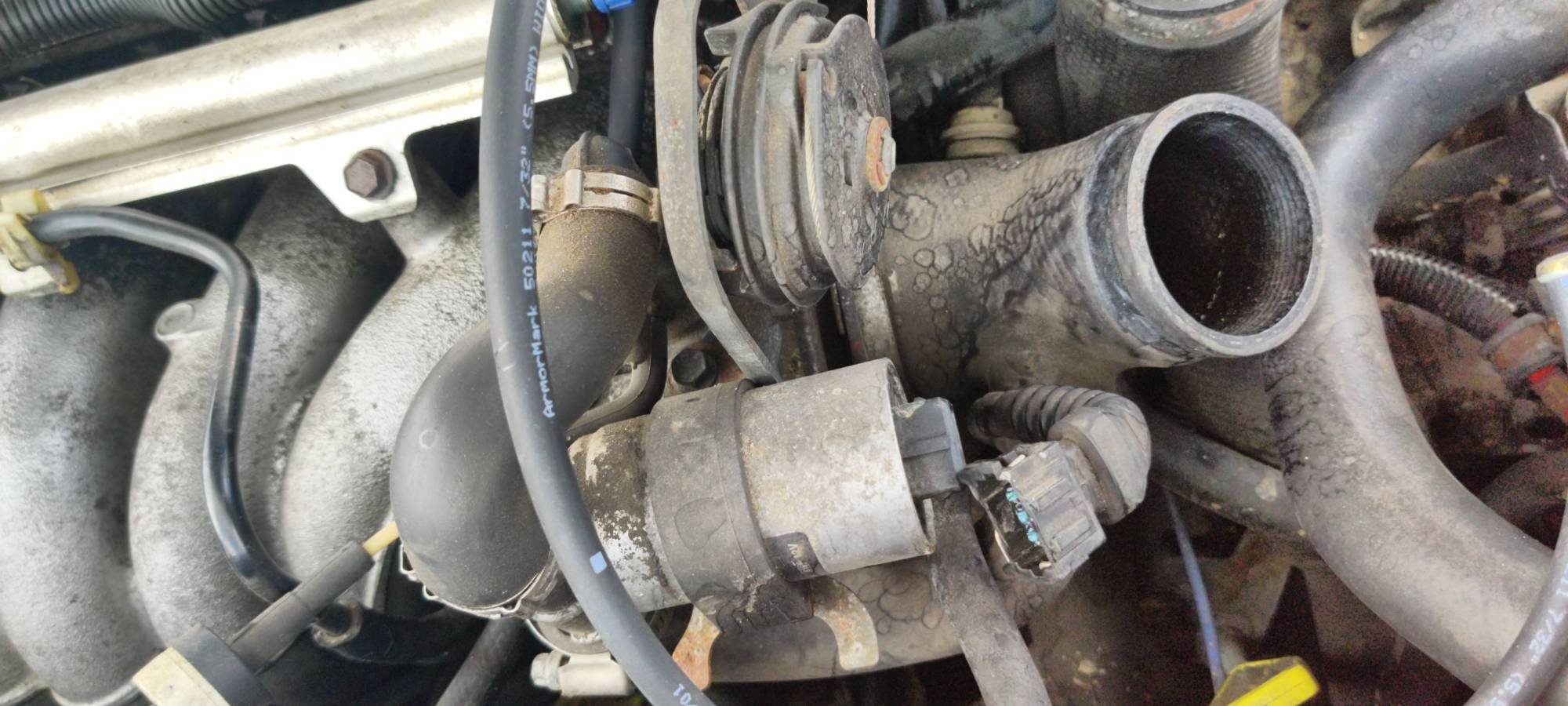

Ok so I replaced that little bit of hose.
Looking at other things
I found this connection (I think it's the IAC idle air control valve) that has a bad connection
Cleaning it with contact cleaner now.
Here are some pics.
Looking for other things, then may reassemble and test.
Here are some pics.
After I clean the distributor and the rotor. And yes I do have the little plastic thing that keeps the rotor and inside the distributor dry...
Hopefully one day...I can get the piping for the straight intercooler pipe over the cylinder head modification...and then rip in and (rip kit I think it's called) rip into everything and replace with silicon hoses
Ok, lemme keep working and see what happens.
