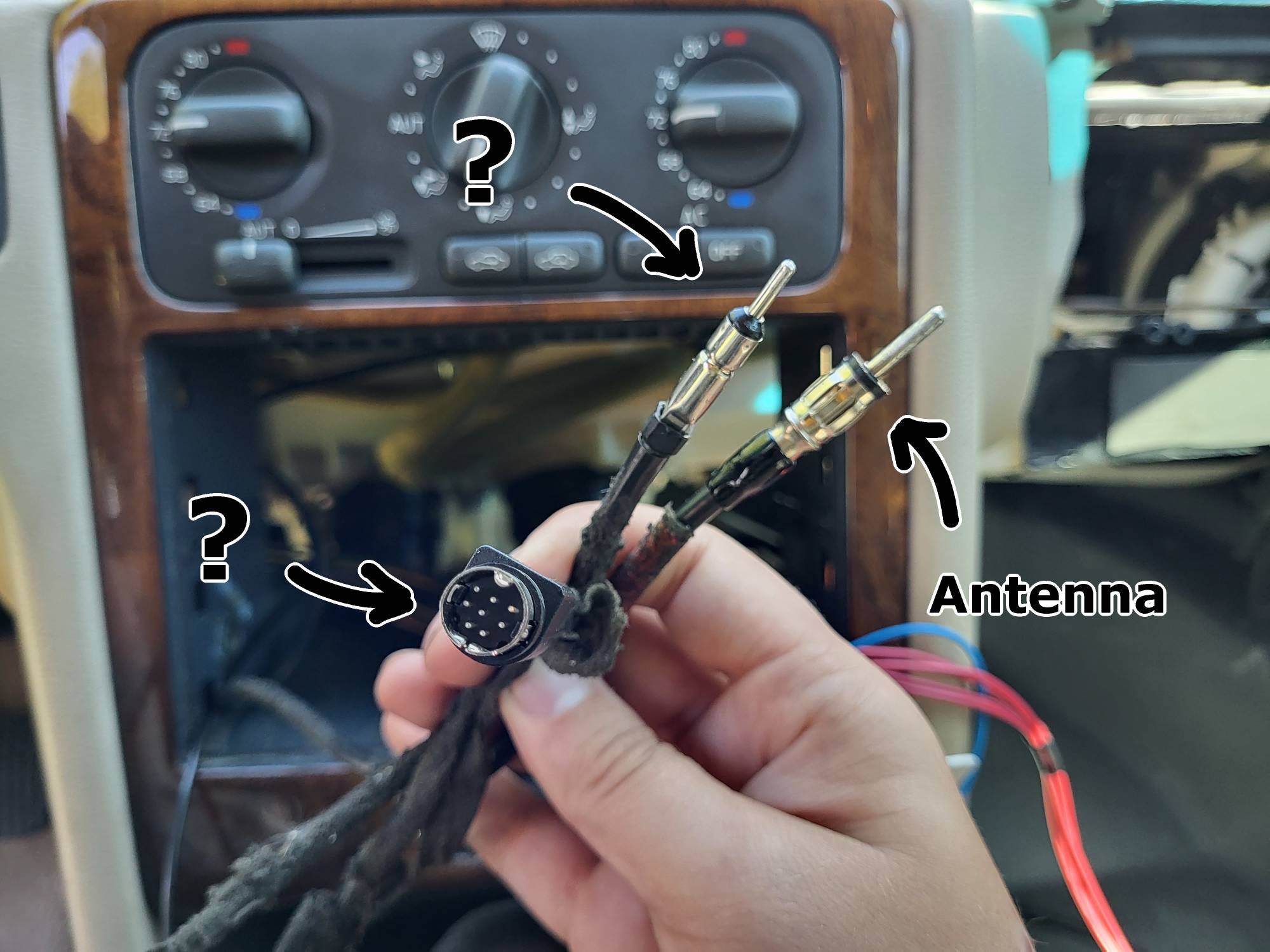

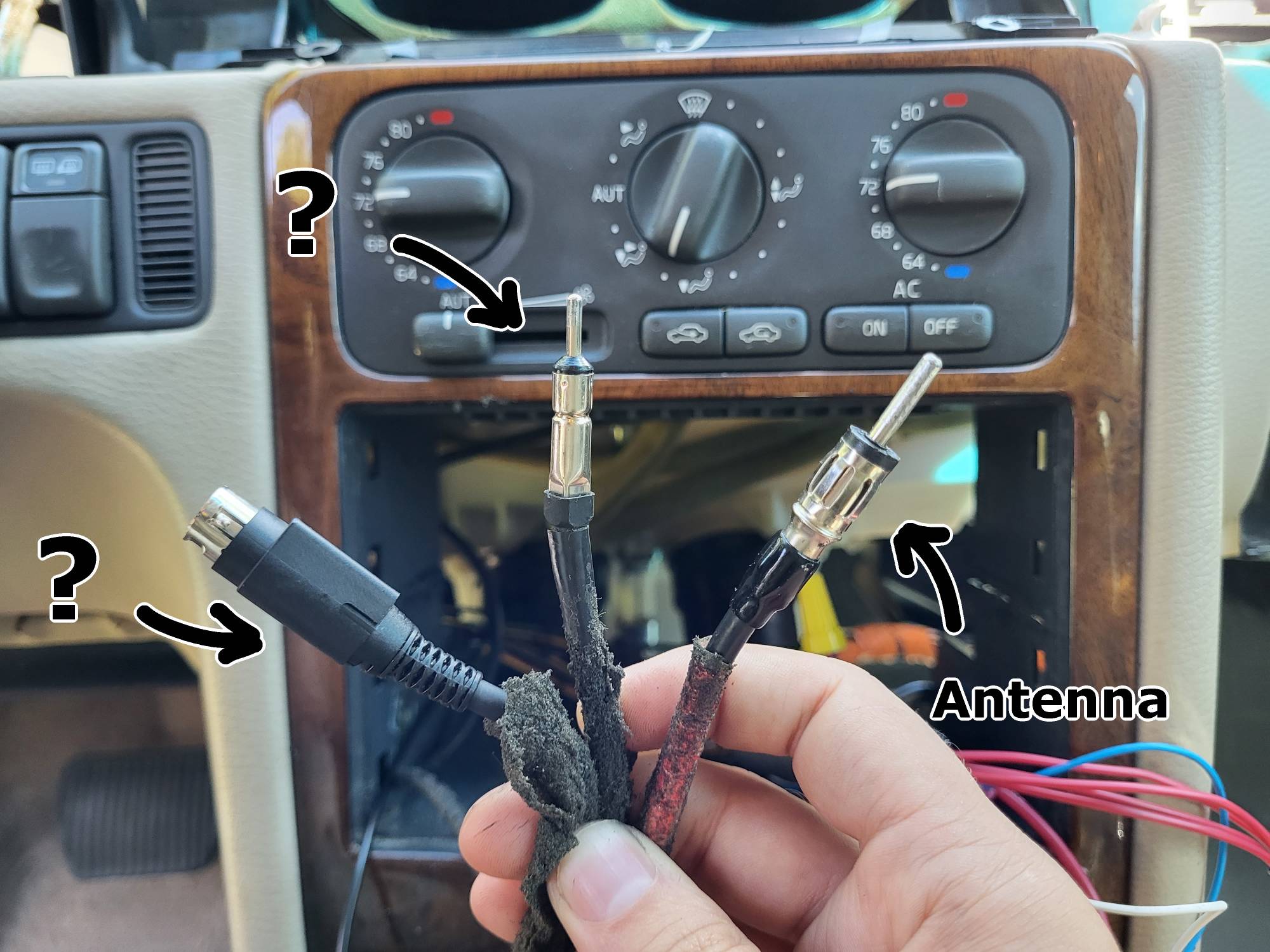

Hello, I am installing an aftermarket head unit in a 1999 V70 R AWD and have found 2 factory connectors that I cannot identify the purpose of. My research so far seems to indicate that the 8 pin connector is for an optional disc changer that would be in the trunk, and the small coax is a second antenna, but I don't know what antenna that would be, and I haven't been able to verify either of these leads.
The 8 pin wire is taped to the main antenna wire and both run in the dash to the driver footwell, where they go into a plastic sheath that sends them to the towards the back of the vehicle (driver side).
The small coax runs in the dash to the passenger footwell, where it goes into a plastic sheath that sends it towards the back of the vehicle (passenger side).
Does anyone know the purpose of these wires?

I think if memory serves, the multiplug is for the optional multi-CD changer. Typically that goes to behind the LH rear fender. If you open the tailgate and remove the LH floor side panel, it should live under there.
On a wagon, the antenna is built into the rear side window glass. In a wagon it would go to the LH side of the trunk to the telescopic antenna.

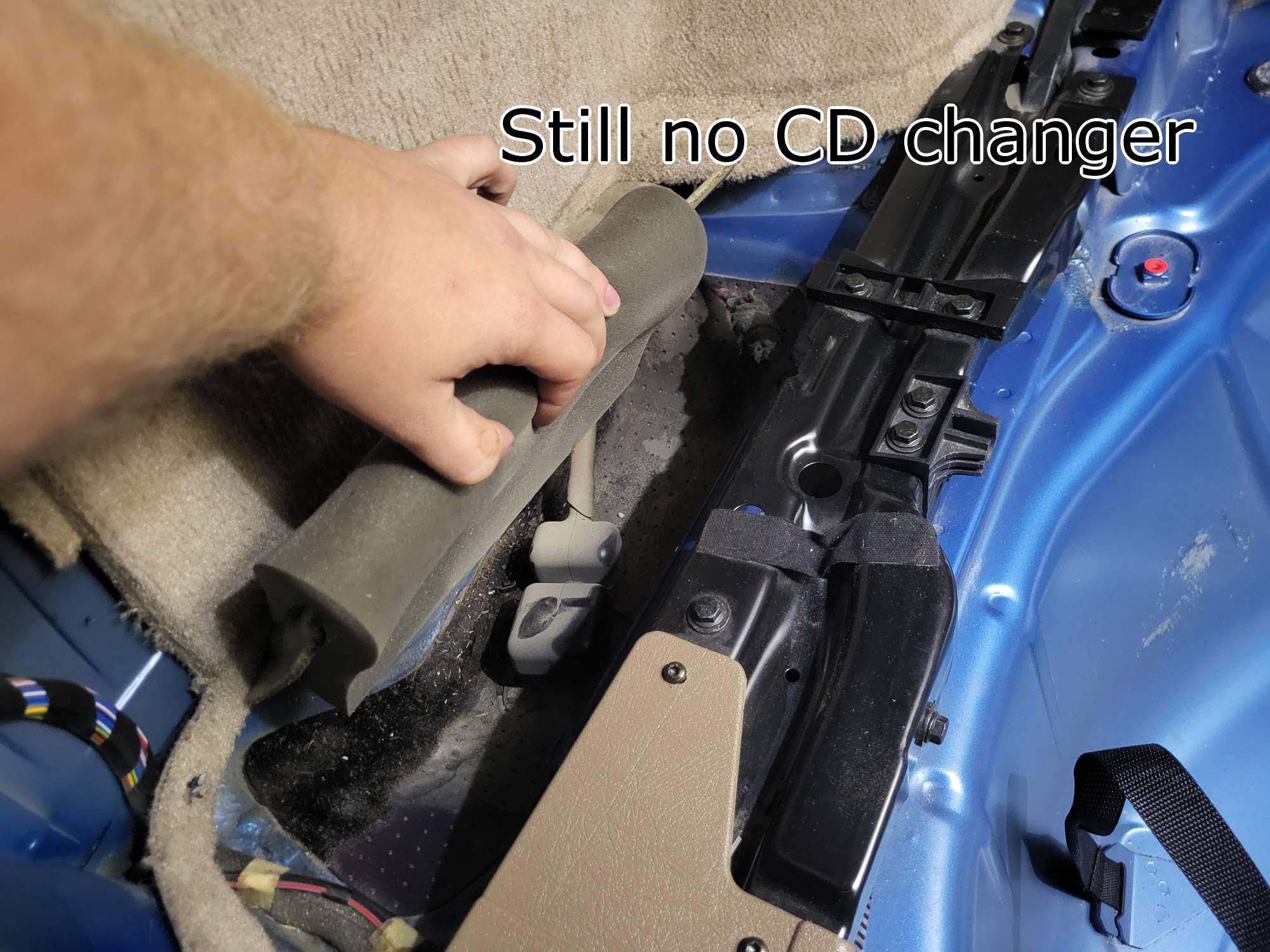

That's what my research was telling me, but I found no CD changer back there. I'm either looking in the wrong spot (anyone have a photo of the location??), it was removed, or this vehicle was wired for one but didn't come with it?
Oddly, while I was back there, I also didn't find the other end of the cable...

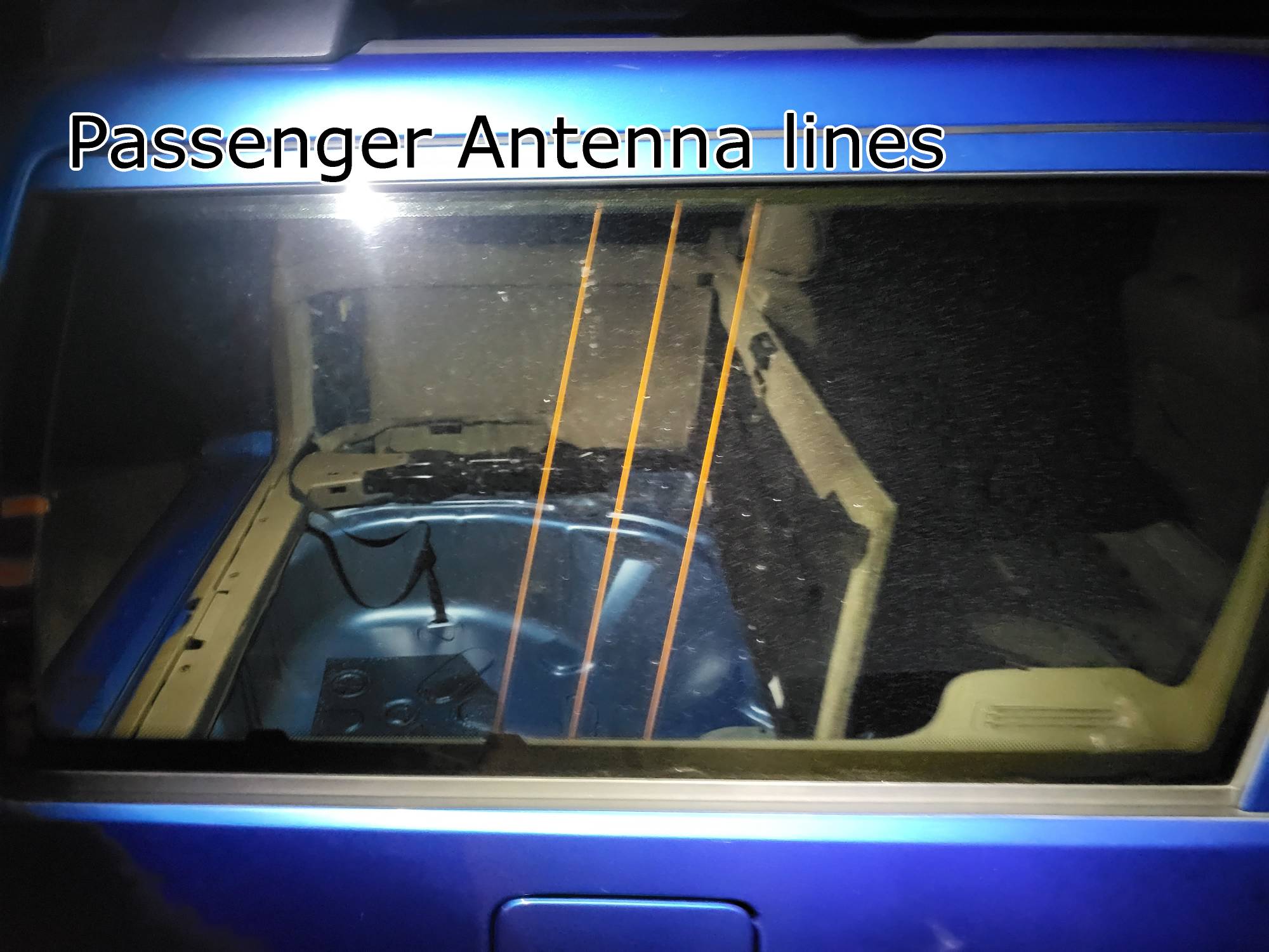

I have 3 vertical lines on both rear side window glass. That would make sense, given that the antenna cable I am familiar with went towards the rear of the vehicle on the driver side, and the 2nd, smaller, cable went towards the rear of the vehicle on the passenger side.

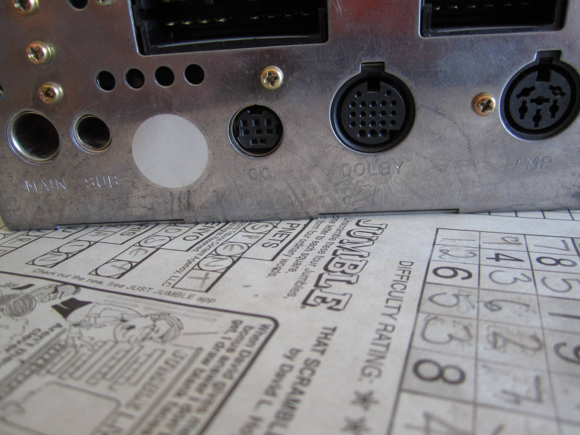

I've added a photo of one of the head units that the 'R' would likely have had.
You can see the Antennas are labeled 'MAIN' for the larger diameter one, 'SUB' for the smaller one and then the CD for the third.

P80 Volvo wagons came with some nice
stereos, especially the ‘98-‘00 R’s, but
these Alpine made units never shipped
with factory subwoofers. Only C70’s.
The factory tuners have Diversity Tuning and
use two amplified antennas in the glass, a main
(standard coax) and a sub ( small coax).
You’ll probably only need the main for your
new deck. Just ignore the mini-coax and the
optional CD changer’s mini-DIN plug.
For an aftermarket install, be sure to connect
the blue or blue/white on the adapter harness
to your new deck to power up the amp for the
antenna.
