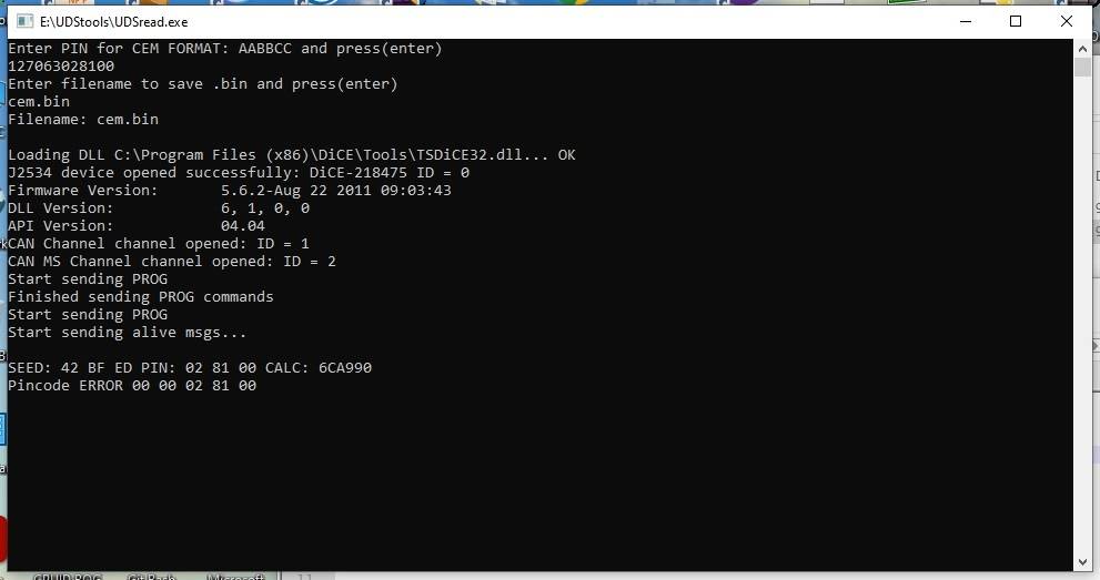

myname wrote: 04 Sep 2022, 17:32 Here is the video. My car is a 2007 10th digit 7.
Dice seem to have probs by flooding bus with prog msgs, what is you dice?
All other programs that use dice should be closed...

RickHaleParker wrote: 04 Sep 2022, 19:03
5ft24 wrote: 04 Sep 2022, 14:05 Doesn't run because I had used the DICE renumber in VDASH so VIDA wouldn't see the 206751... not sure why as I'm not planning on subscribing to do anything anyway... so now its 218475
VDASH has no way to return it to 206751...
Could the source code be modified to accept an alternative serial number or device name as an argument?
Just used NEO Hex Editor on the .exe going to check it out later today

5ft24
Posts: 203
Joined: 14 April 2013
Year and Model: 2005 XC90 V8 AWD
Location: Sedro Woolley, Washington
Has thanked: 20 times
Been thanked: 12 times
Post by 5ft24 »
it talks now, but the PIN I know as good, as I sent it to D5T5 and it works in VDASH to change settings in the CEM, isn't working.

T5Luke
Posts: 142
Joined: 11 November 2020
Year and Model: S60 T5 2001
Location: DE
Has thanked: 11 times
Been thanked: 130 times
Post by T5Luke »
5ft24 wrote: 05 Sep 2022, 12:51 it talks now, but the PIN I know as good, as I sent it to D5T5 and it works in VDASH to change settings in the CEM, isn't working.
2005 XC90 V8
The CEMs have 2 codes, the long 6 byte code you can crack by teensy, or the 3 byte UDS code you can crack by dice.
Both codes are different but have the same might... By the 3 byte UDS code you can read the flash by UDSreader and in flash you also find this 6 byte code...
