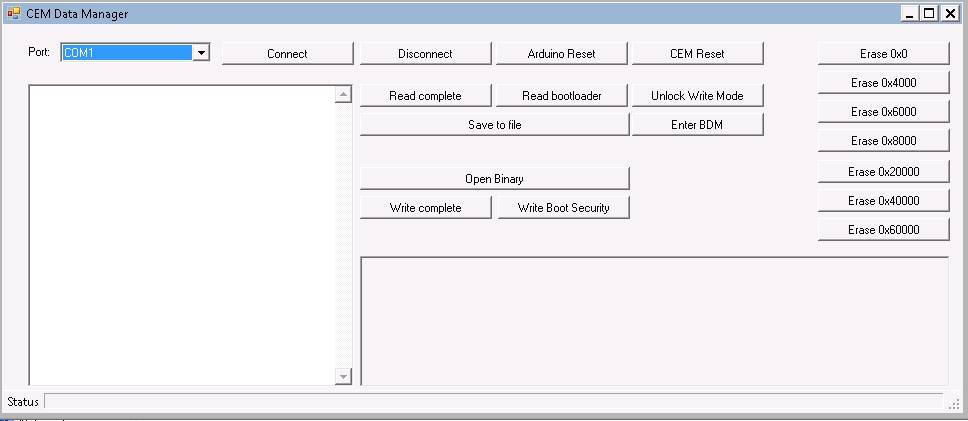

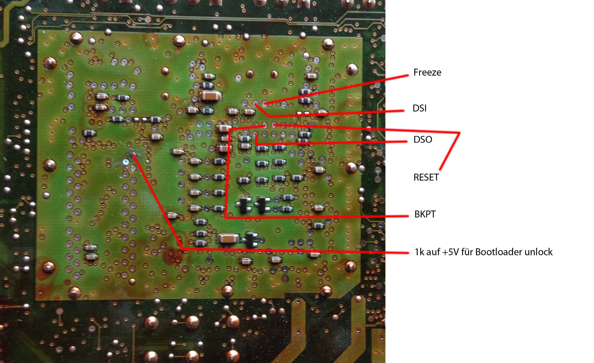

I made this long ago for my self. It works, for me and i hope for anyone who needs it to copy his own CEM. For just changing config, better take the other tool and write only the config to your cem by dice...
viewtopic.php?t=85611&start=2270
The +5V over 1K resistor is only needed if you want to write complete cem, the bootloader is is in area 0x0 - 0x3FFF. Without pulling this point to +5V you cant erase or write this area. I took this resistor just for protection, today i don't use it anymore and put this pin directly to arduinos 5V pin. But be carefull if you pull it to gnd you will notice some smoke and your cem won't work anymore...
To read:
select port, click connect, click read complete, wait till all data runs through this window, it takes around 6min. When it stopped click save to file and you will get your bin.
To erase:
click on unlock write mode, and click on all erase blocks one after one on the right side to erase all areas on the new cem.
To write:
click on open binary, select the file you want to write, click write complete.
On arduino you need the firmware from ardubdm.bin, I lost my original sketch i have 0.9.6 here and i know i flashed 0.9.8 to my arduino. I should have it on some harddisk somewhere when i find it i will post here. But i was able to make a dump of my working arduino and you can flash this soft to your arduino by write.bat.
Edit write.bat to the matching port of your arduino: and run it to flash the correct firmare onto your arduino.
I know reading takes about 6mins and writing about 90mins and the gui doesnt update right by writing but it works and it is for free..
As always have fun with it and use or reuse this for your own projects.
