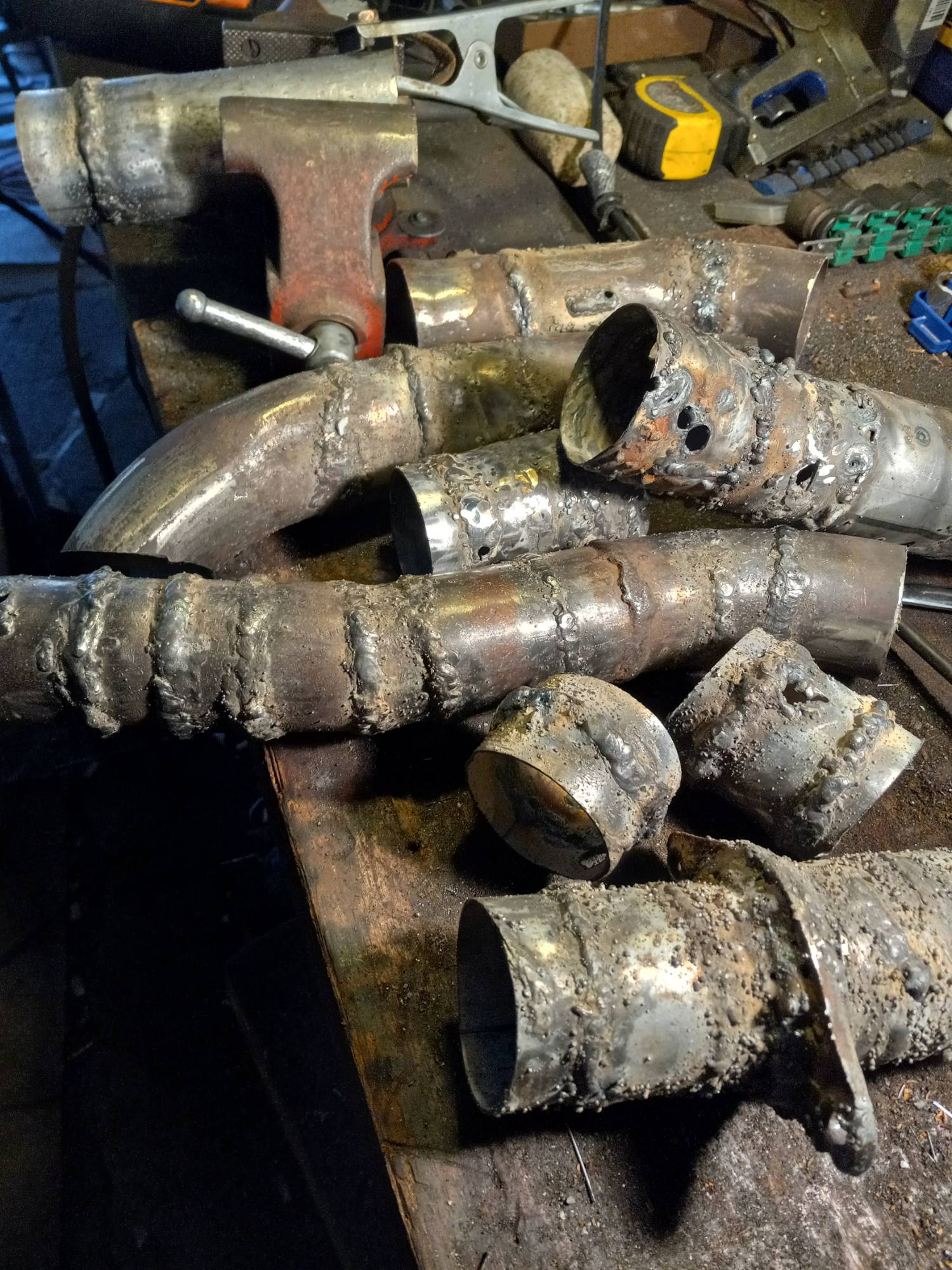

Theres only 1 inch of space from the top of the flex to the O2 sensor, getting a clamp in that section would be difficult and prone to rust.
I bought a cheap mig welder and have been practicing on scrap exhaust pipes doing butt joints mostly.
I think I've gotten the hang of it after welding over 6 feet of pipe cut into 3 inch sections and but welded back again.
The short section in the vice was done last night, I'm confident it will do the trick.
