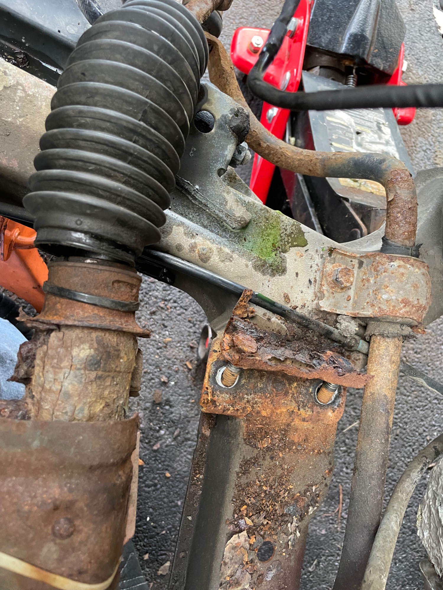

Recommended replacement of a power steering rack because 3/5 bolts is generally regarded as sub-optimal….

That ani sway-bar bush also looks sub-optimal! Ouch.

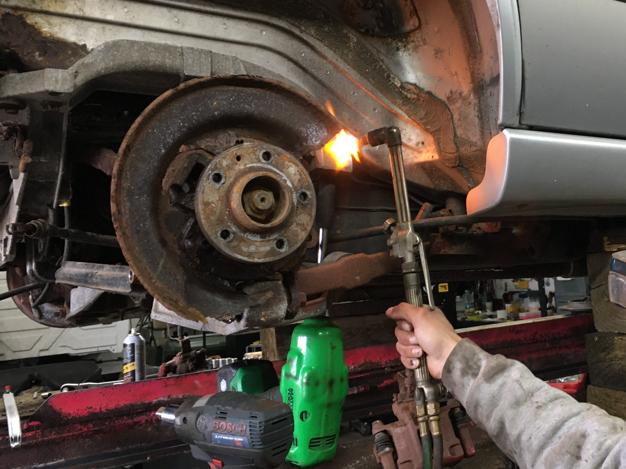

I’ve always wondered how they make up those “ impact torque ratings”. Is there any physics behind those?
On the Kat, the Matco green monster did my rear axle bolts, and it was impressive.
That’s a $1000 tool…..
Say hello to my little friends, torque and fire….

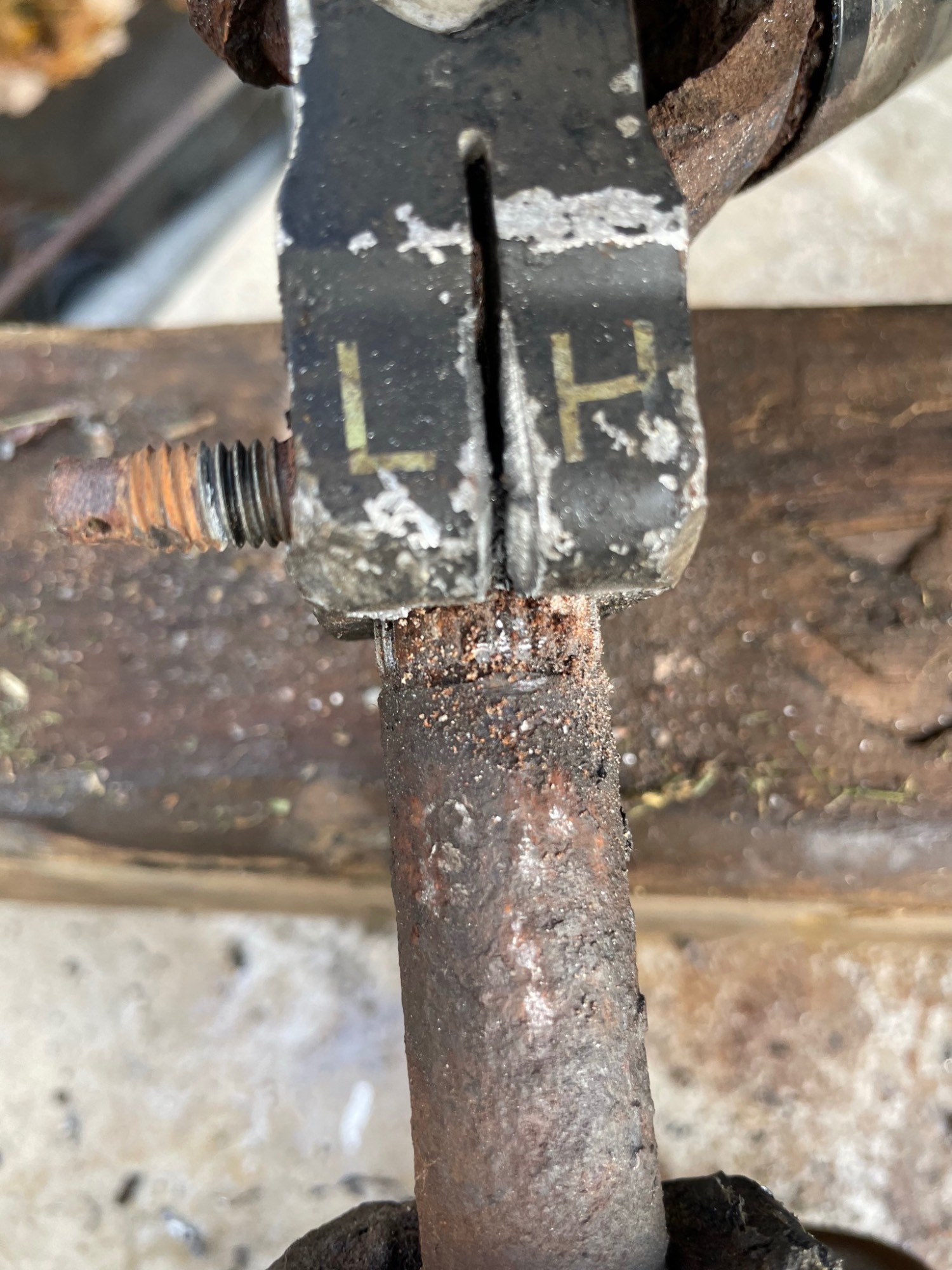

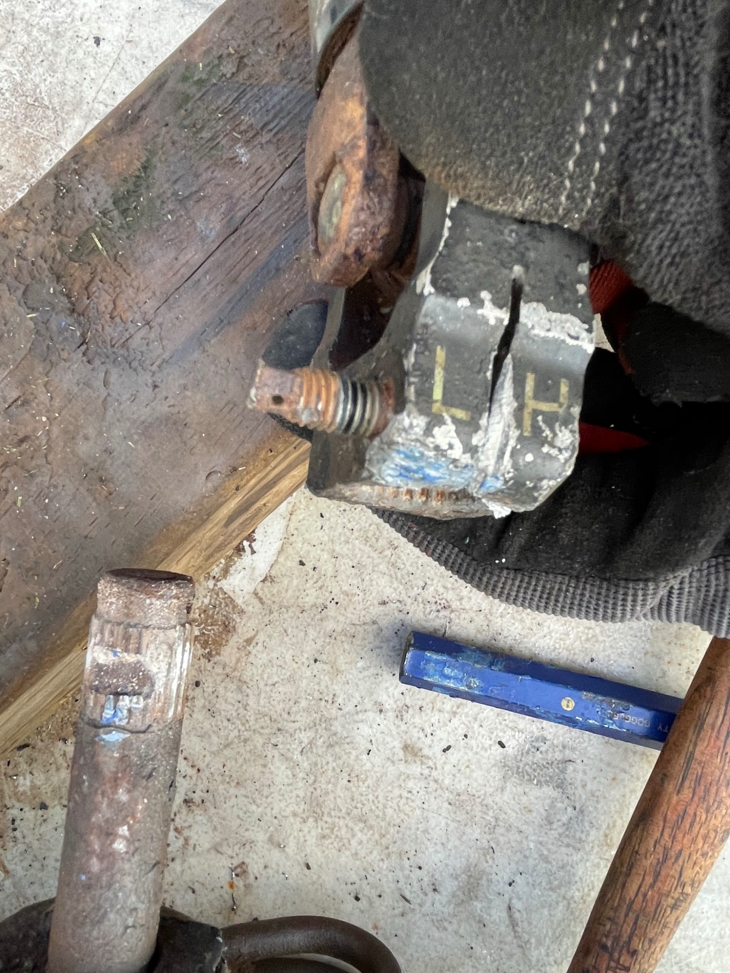

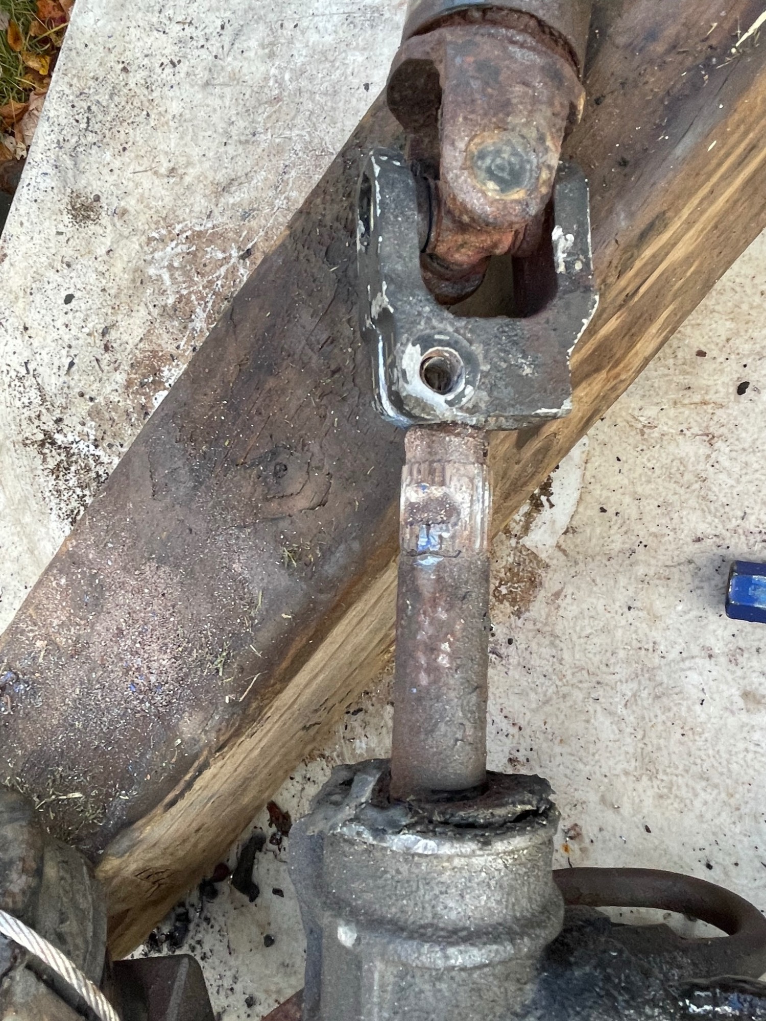

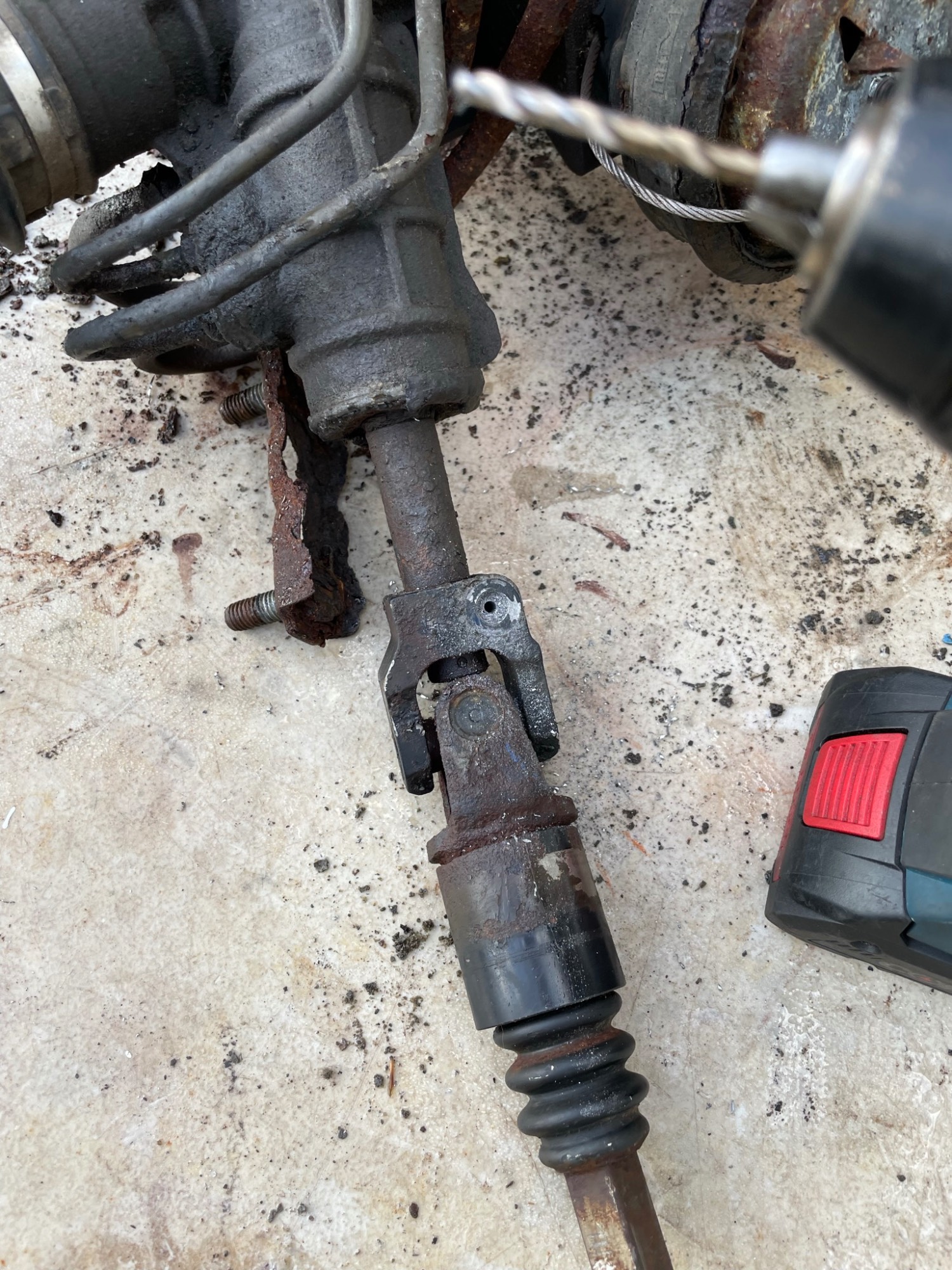

Recovered an NLA steering u-joint off an old rusty rack.
The through bolt snapped right off, so I drilled it out in six stages, nice and light pressure, sharp drills
Then I had to knock it off the shaft as it wasrusted on.
