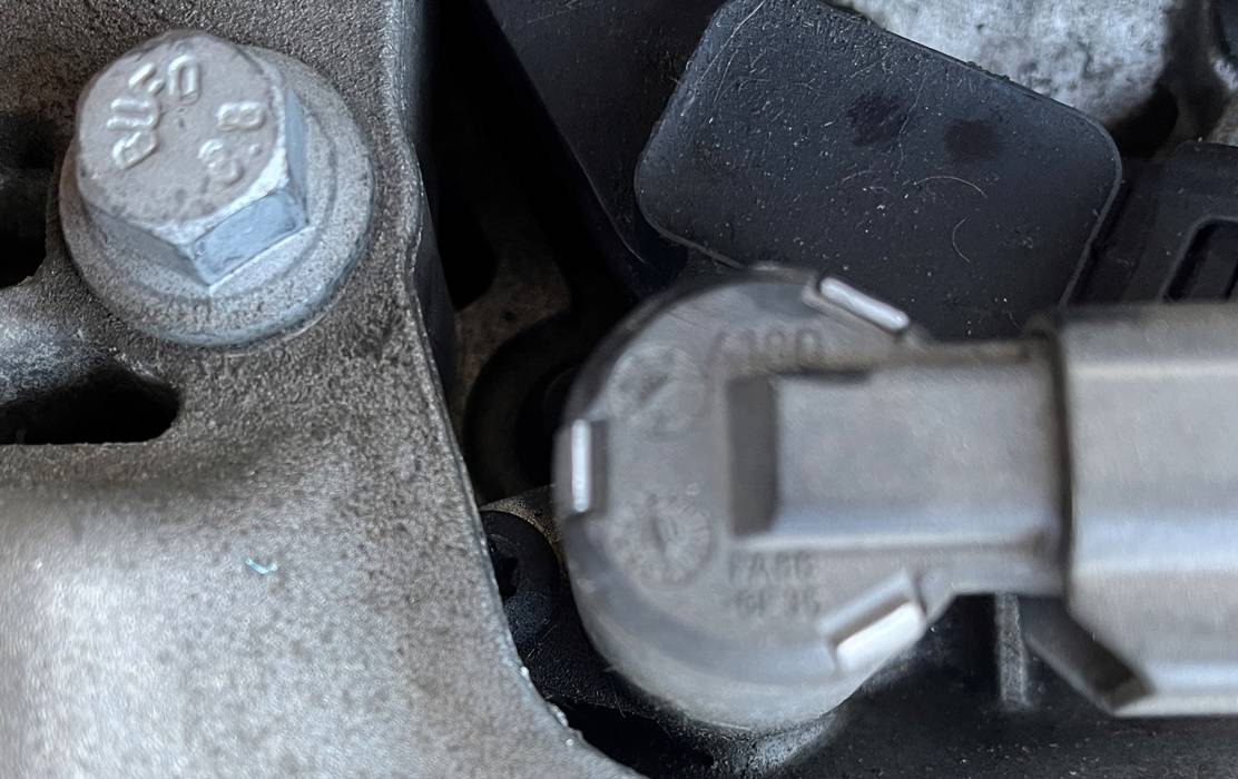

I’m sorry I’m so dumb but here is a pic of the passenger side, bank1, of my engine. I’m trying to match it to Paul’s photo on the link you gave me. Where is the solenoid? I know you said under the motor mount but I don’t see the bracket mentioned..?? Idk… please help… be kind

That's the variable valve lift solenoid (round top) The rectangle top next to it is #1 ignition coil.
On my P3 the motor mount bracket gets in the way of removal but on your P2 it look like you can just remove it.
The motor mounts are different for P2 and P3.
That makes it easier to fix just the one Torx Bolt and the electrical connector to disconnect.

Abscate, the shop said that they had pulled and checked the plugs. I had ordered a new coil for the #5 that was missing at the time I took it in but they claimed they checked those also. However I don’t know what they did with the new coil. I have ordered new cam solenoids but I don’t know if that will fix the problem. There seems to be some back pressure as the plug off of the bank one solenoid is full of oil. The solenoid does seem to be bad.
Solenoids should be here the end of the week. I will report after installing those , doing a PCV check . I hope it doesn’t turn out to be the catalytic converter!

Update: replaced the vvt solenoid on bank 1. No more bogging out under load .Replaced the coil on #4 which was missing. Car runs like a dream now. Next project is the “anti skid service required “ Thanks for all the input/help! MVS is the best!
