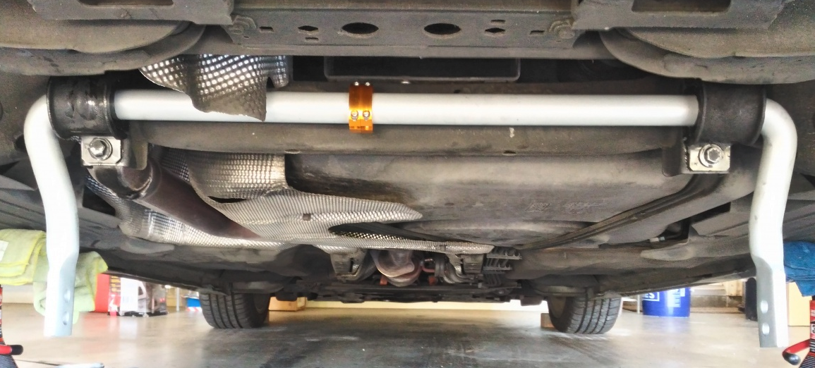

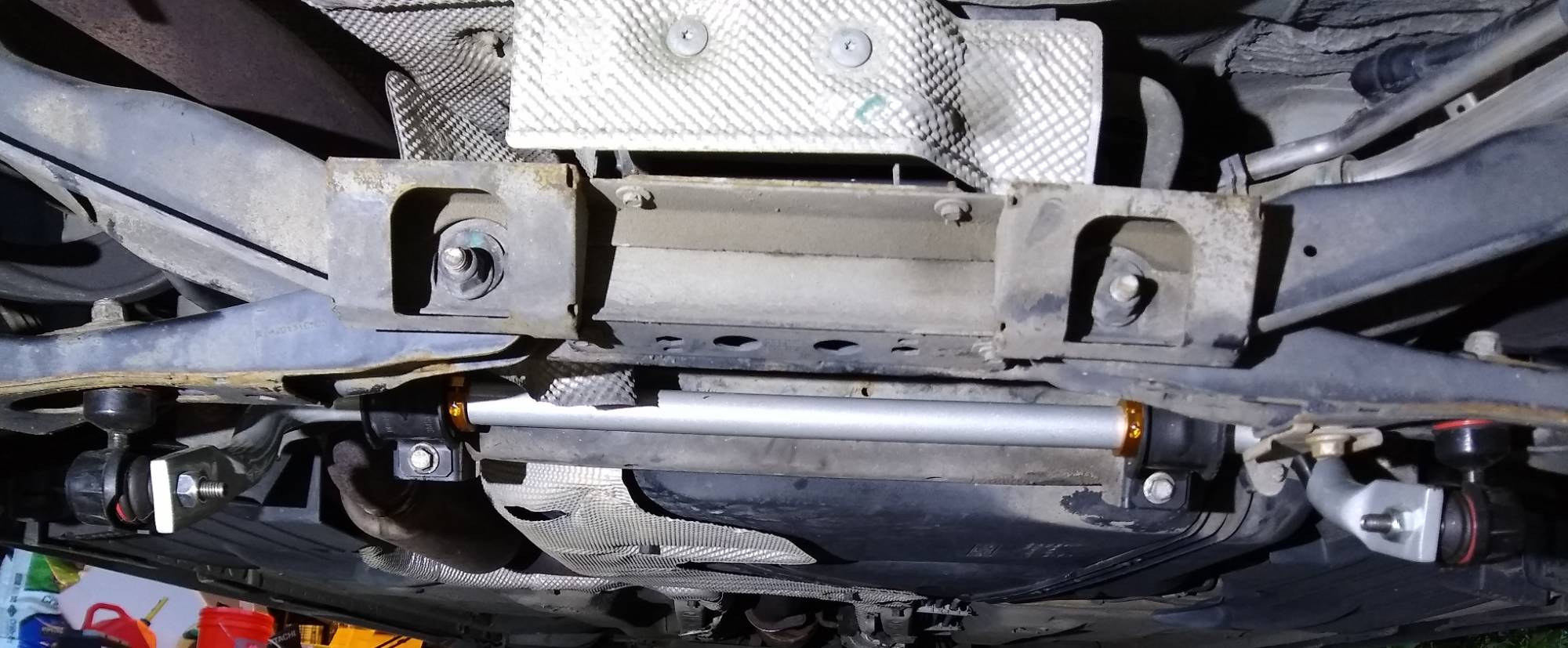

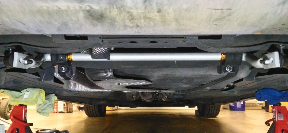

The rear Mazda Whiteline sway bars came with collars. The first two photos are of another C30 owner but the same bar and collar. Third is of our 08 C30. Make sure the links are the correct ones and in good shape.
Just remembered! Brother got an 850 when I was at Pepboy's in 95. He took his car in for a very small noise and Volvo... Put it on the rack at PB and found the sway bar bracket had broke. Can't really tell unless you use a pry bar.
Whatever is causing it the movement is extremely large. Should be the bar mounting itself or else you would really feel it while driving.
