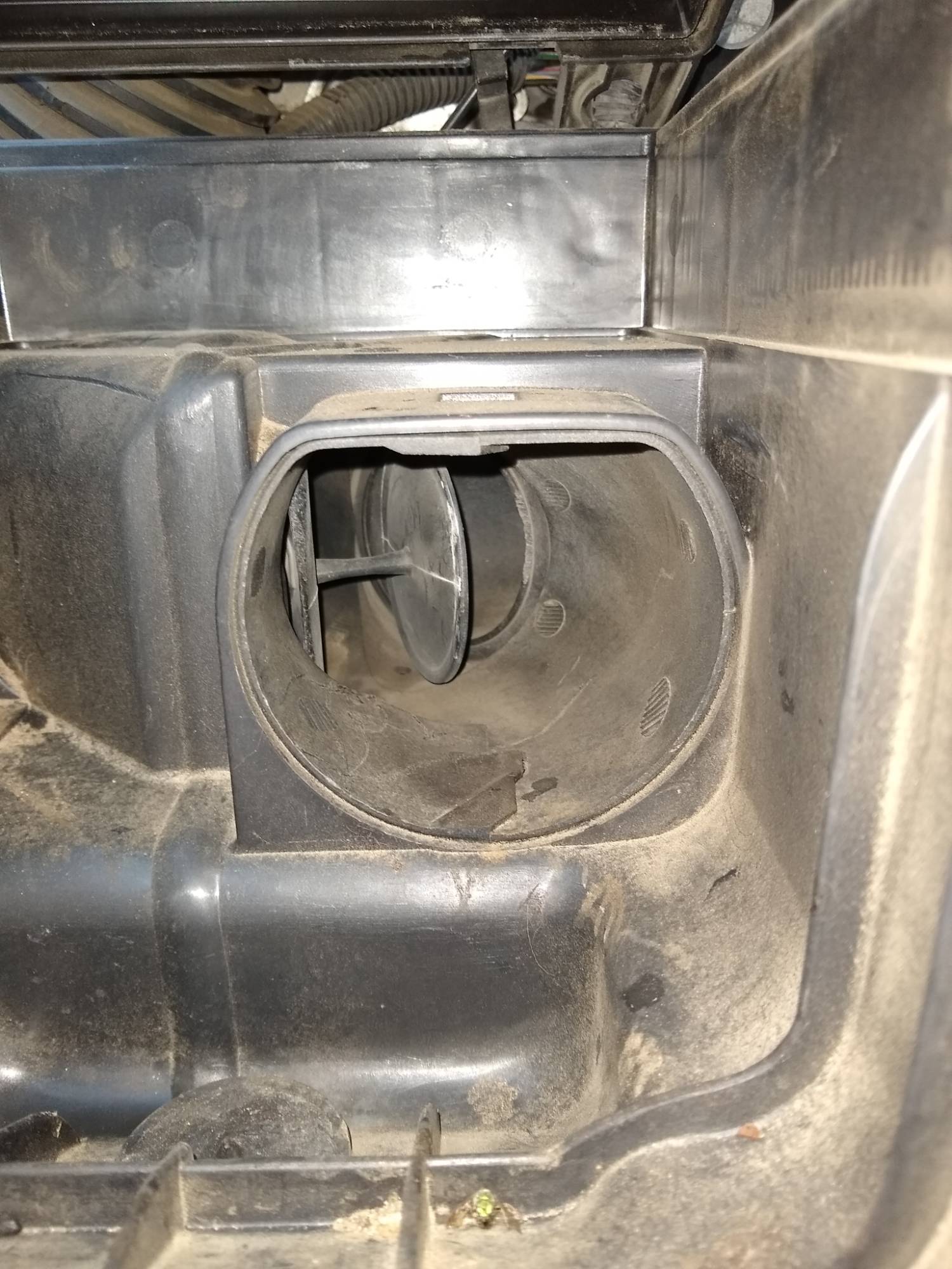

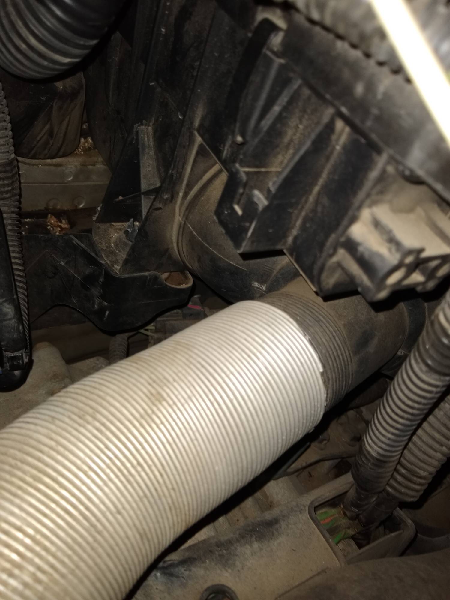

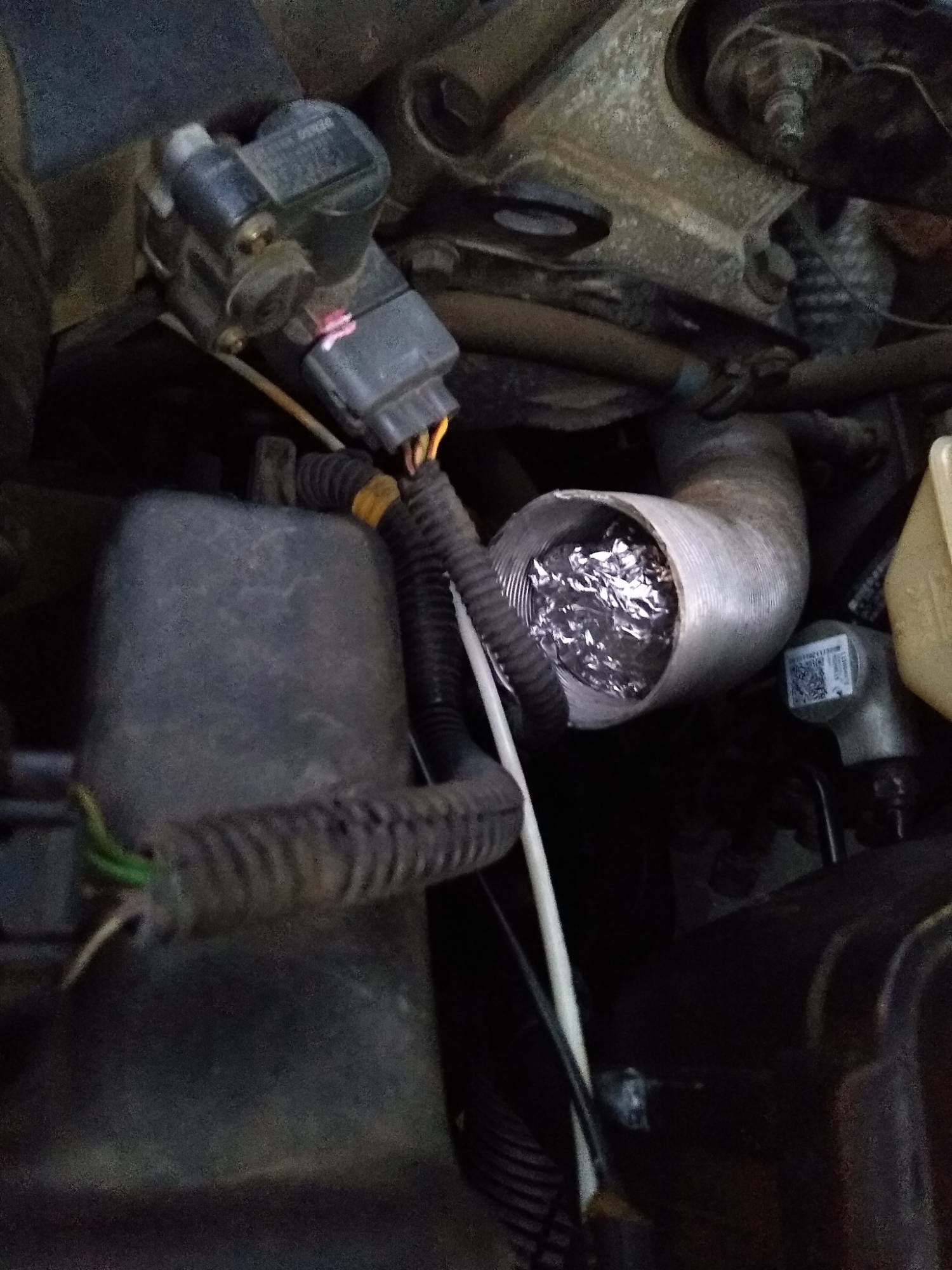

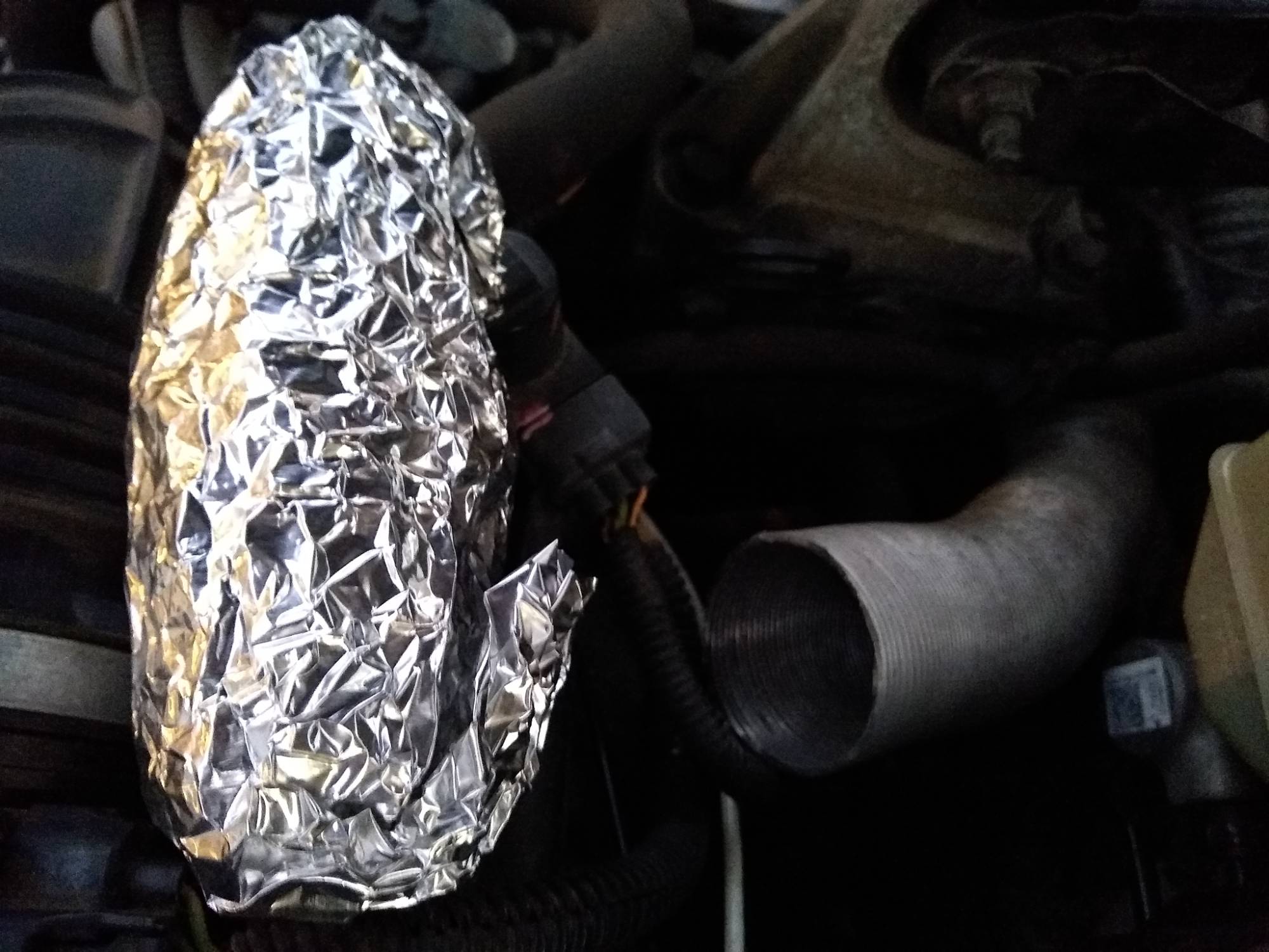

Since our summers are much warmer than winter is cold I decided to block it off from the outside just in case the flapper is not functioning. Prefer cool air from the front of the engine than hot air from the exhaust manifold.
Aluminum foil over Rockwool left over from garage wall and attic insulation. I doubled the amount in the picture.

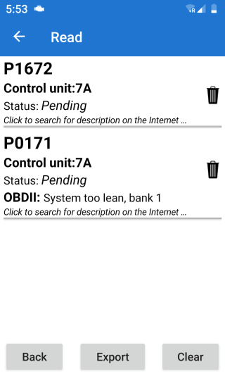

UPDATE: Blocking the tube caused a P0171. Removed the restriction and code went away. Decided to remove the entire tubing and leave the air inlet open to engine compartment rather than draw air from the exhaust manifold.
