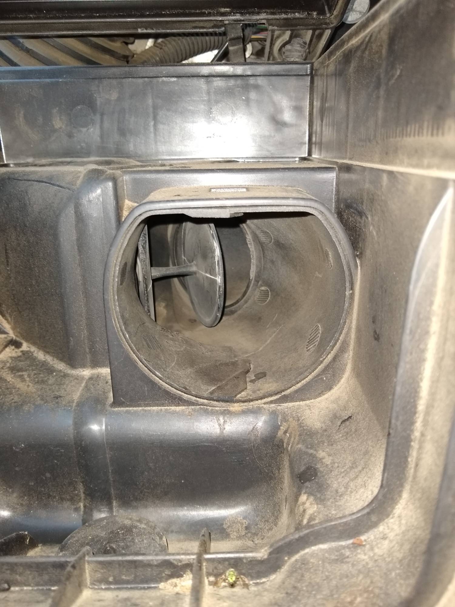

Since our summers are much warmer than winter is cold I decided to block it off from the outside just in case the flapper is not functioning. Prefer cool air from the front of the engine than hot air from the exhaust manifold.scot850 wrote: ↑06 Nov 2022, 11:44 This is a long known issue with turbo P80's in cold climates. It gets worse with age as the oil from the turbo leaks into the intercooler. Bit like fat in heart arteries! When the warm air in the engine cools the moisture in the air condenses in the intercooler and freezes the channels closed preventing the engine getting enough air to power the car. I have seen the intercooler rubber hoses sucked almost flat!

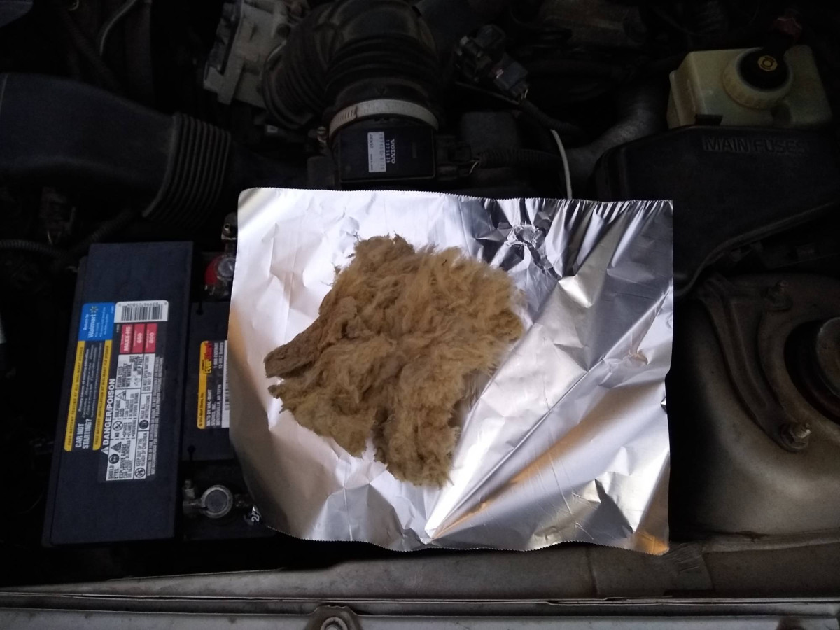

Aluminum foil over Rockwool left over from garage wall and attic insulation. I doubled the amount in the picture.

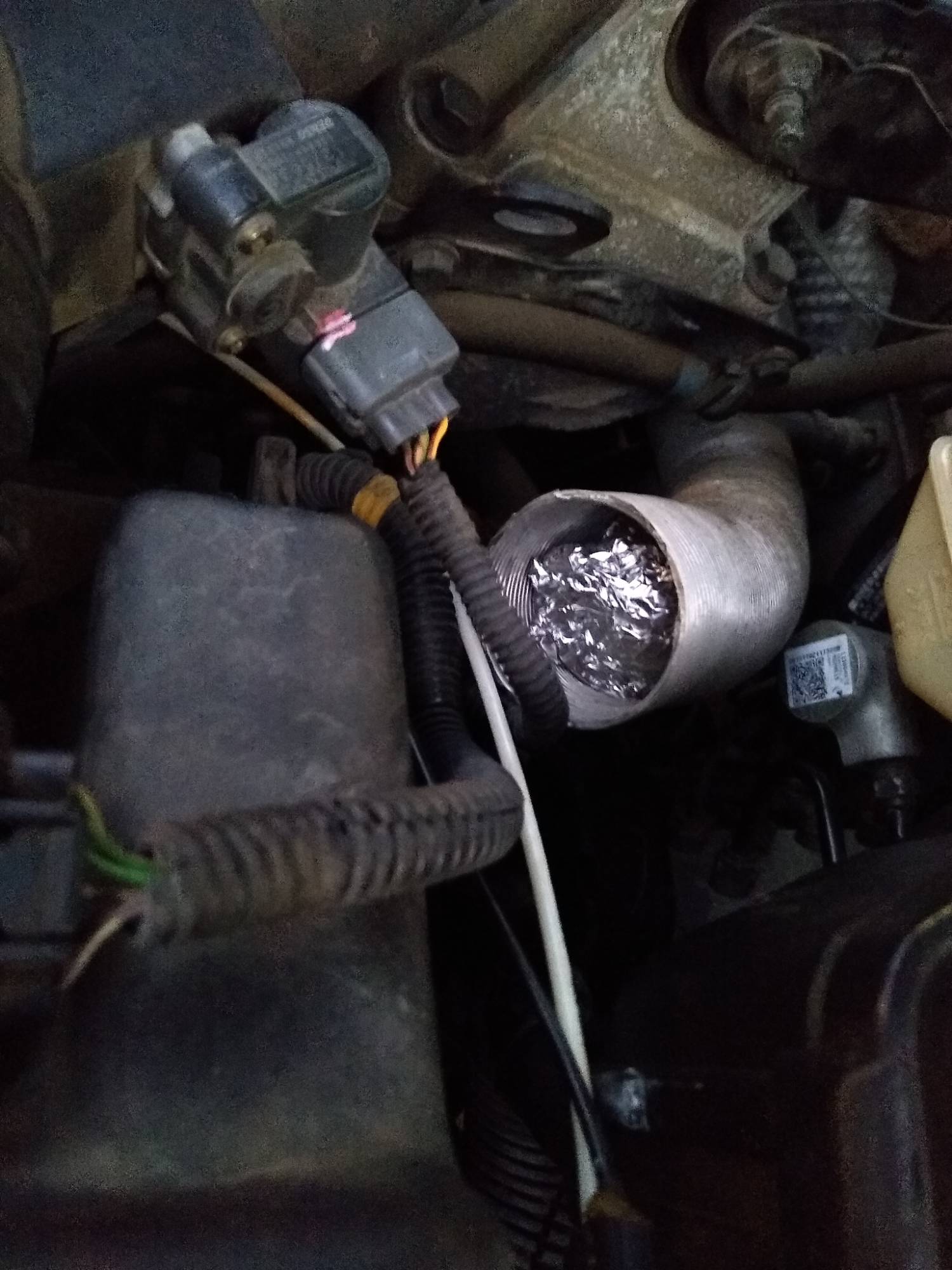

UPDATE: Blocking the tube caused a P0171. Removed the restriction and code went away. Decided to remove the entire tubing and leave the air inlet open to engine compartment rather than draw air from the exhaust manifold.
