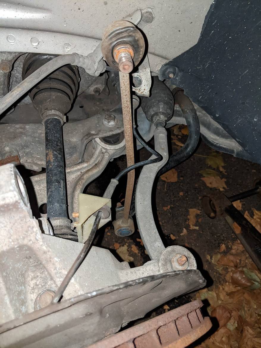

After alignment -needed as I dropped the subframe had swapped and fooled with bits side to side, for sway bar contacting LCA.
Got back home with a clunck and sway bar contacting LCA again. Found they hadn’t fully tightened top spindle to shock bolt.
I now know two reasons why a sway bar will move.

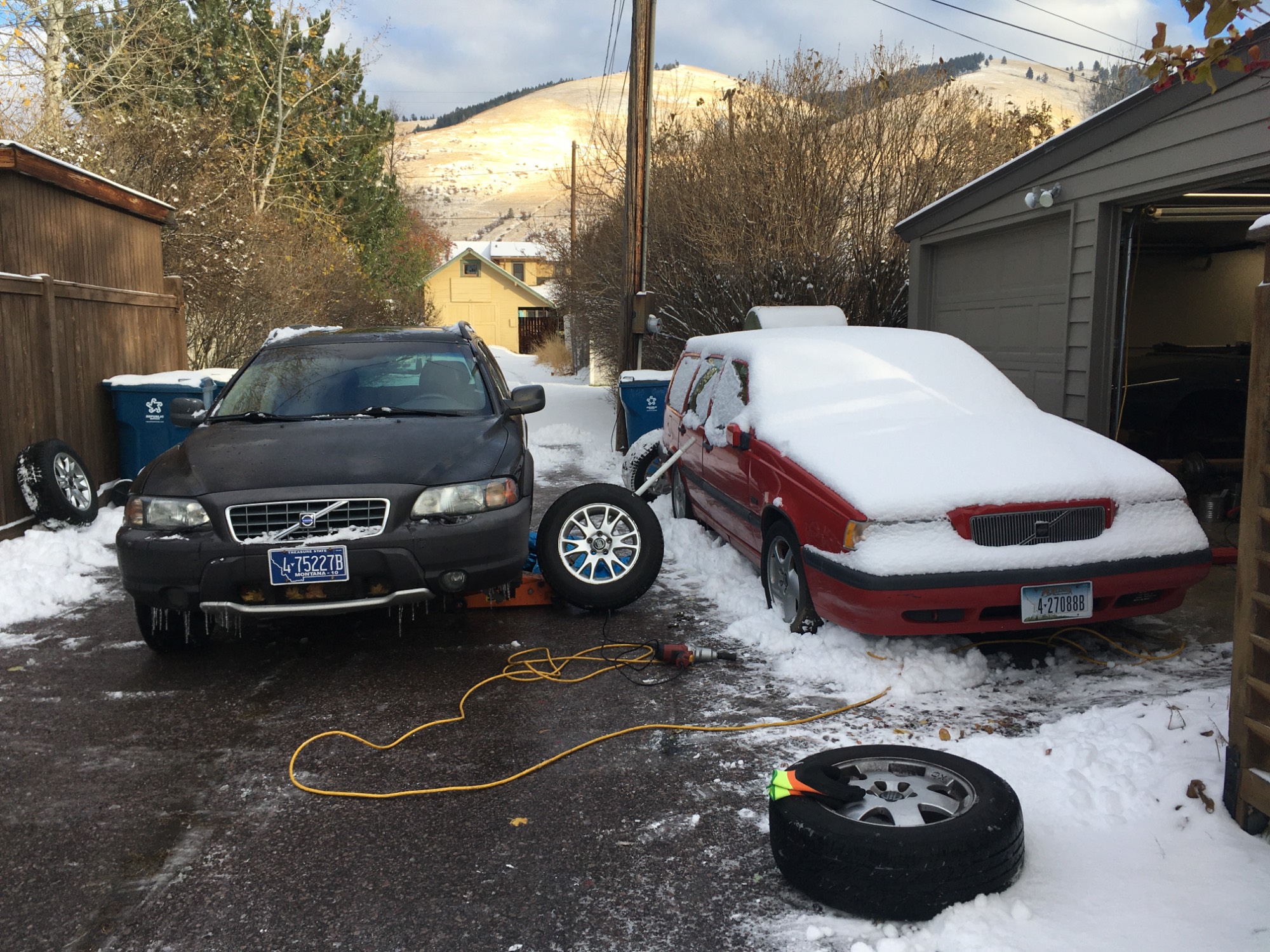

We had a sudden Montana Nor’easter blow in so I quick swapped tires on Betty out in the alley. Nice to have an impact gun and good gloves.
DB7D60BF5A43.jpeg[/attachment]
Apologies to all my friends in the salty climes.

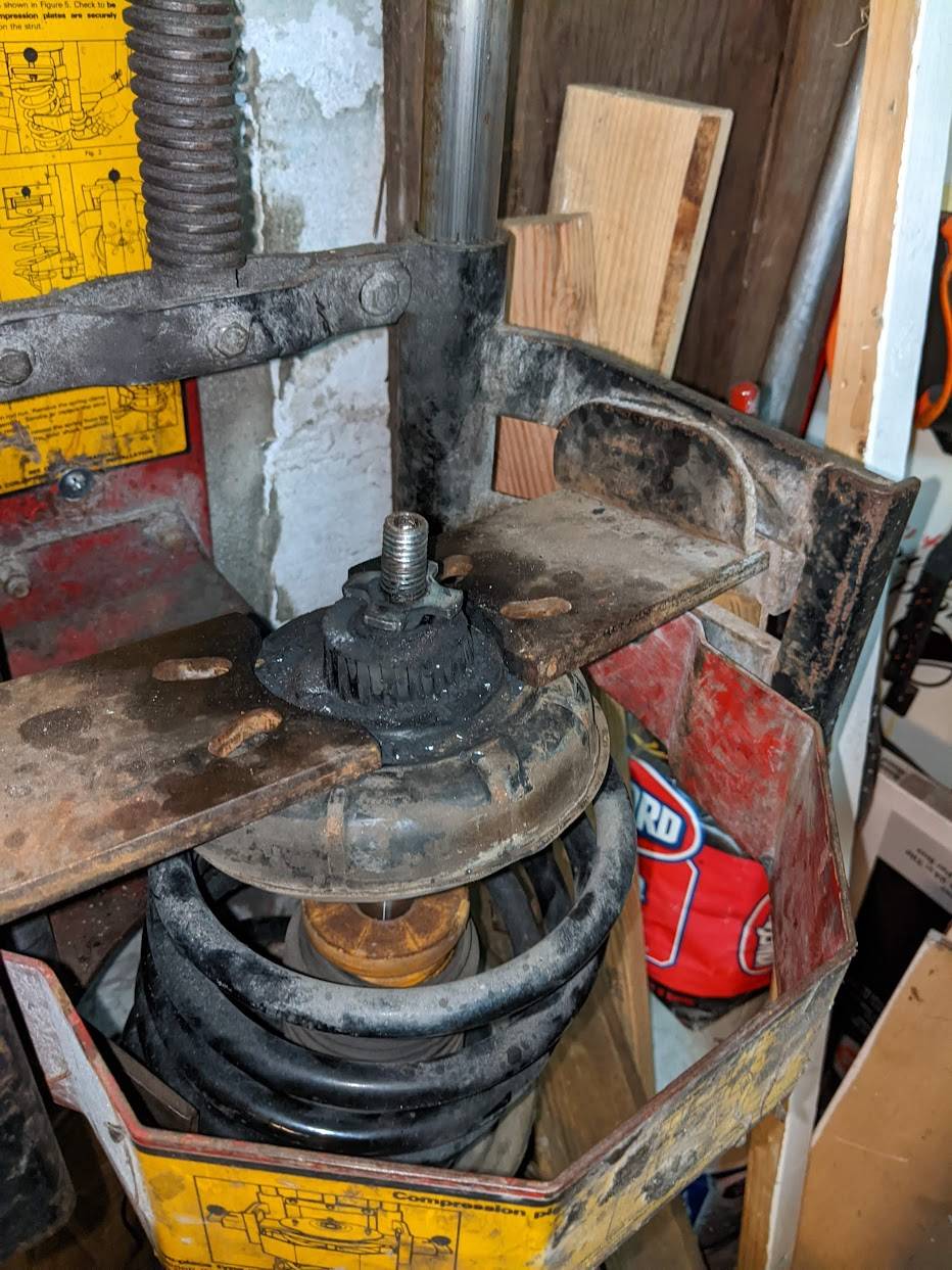

I'd recently bought a 2004 V70. The Driver's side strut mount was not replaced (but still had the original strut), but the passenger side was. As it turned out, the driver's side had a major accident, causing the bottom 2 strut bolt mounts to bend, stabilizer linkage to bend. Not a problem until we found the "cross pattern" nut/washer on the strut had siezed and there was no way to disassemble the strut, so there's nothing that could be saved. Nevertheless I had to drive back home, so my indie mechanic had to put everything back on and pay for his time. Ordered all new parts from eEuropart and luckily Rockauto had a liquidation sale on KYB struts Excel-G. It was $105 a week ago, but they were blowing out the last pair for $60 each

Replaced both strut assemblies on my XC today with FCS quick struts for $250 CAD all-in. Manufactured in Detroit using Chinese components. Lifetime warranty, and honestly one of the easier jobs I’ve ever done on this vehicle. So low risk for me. Rattle is now gone. Nothing was salvageable on the old strut. Even the springs were starting to show bad rusted spots, seats were shot, bearing gone, struts leaking. They needed to be done probably 2 years ago.
