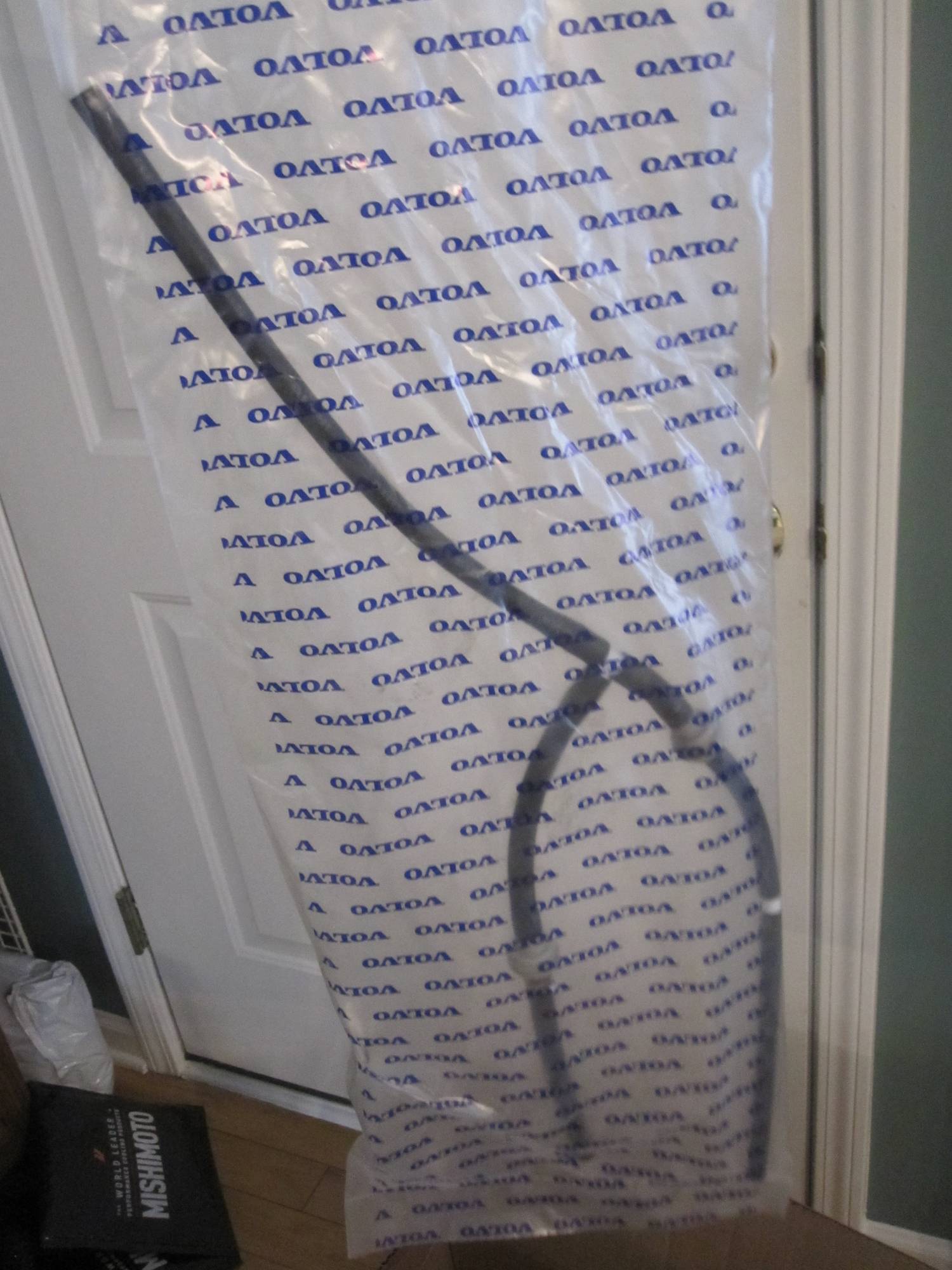

The vacuum lines that you're referring to, I believe you mean the Evap lines, correct? I replaced that set last year. So I *should* be good. (photo below)
Thanks for the heads up on the idle control. These bastards have so many variations, it's hard to know what the heck you have.
So, any chance this could just be a dirty throttle module? I have a Xemodex that was installed 10yrs and 50k miles ago.
Finally, I was thinking of just removing the Xemodex, cleaning it, and installing a RIP kit. I think that would eliminate any possible induction pipe issues if they exist. Let me know if my thinking is wrong. And thank you for the response!
