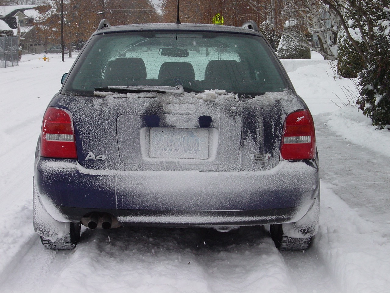

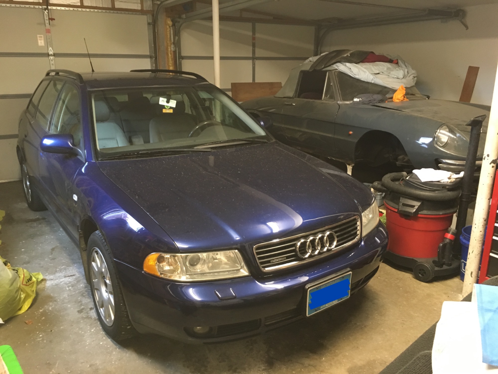

2001. B5 platform, 1.8T 20 valve, 180 hp. Fun to drive. Best ice car I've ever been in - still the old skool quattro.
5 speed, cloth sport seats, no leaky sunroof, higher suspension for snow.

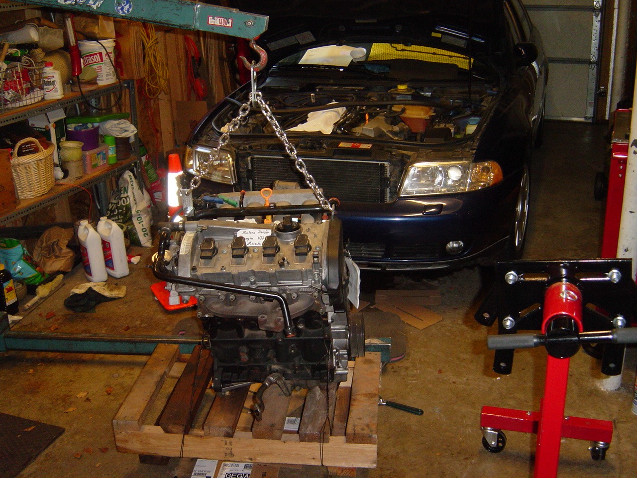

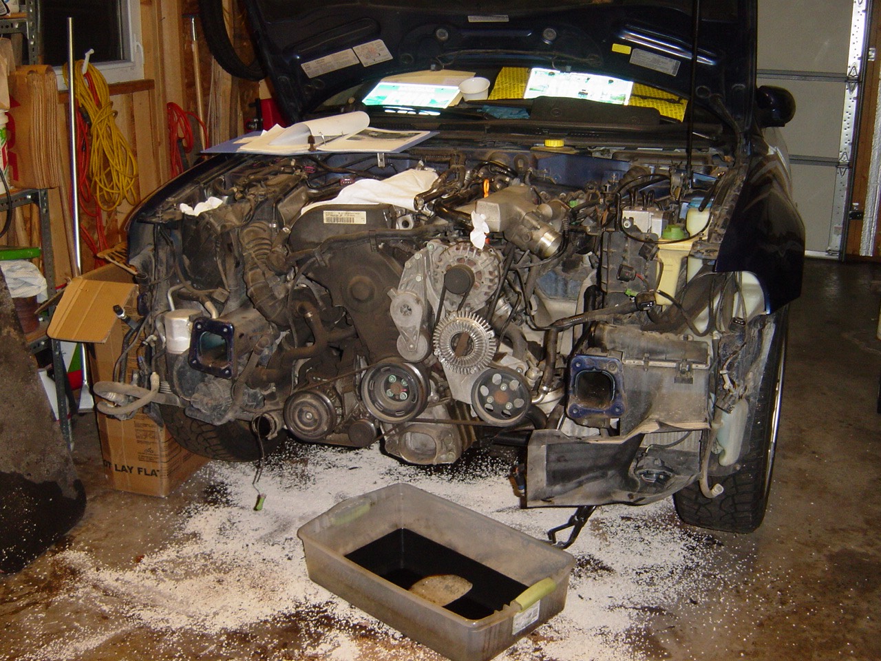

But this happened many years ago - First owner I believe ran the oil low and sludged up passages. It only holds 3.7 qts stock, then if it gets low... you're running a small high compression turbo motor in a cramped engine space with too much heat and not enough oil. It was a VW failure point from that era. I missed the recall by like 10 years, where they bought people new engines.
They traded it when it needed it's first timing belt. I had it full of new oil, was zipping to Denver, and near the Wyoming line it ...blew up. No warning. Spun the rod bearings, stuck a hole in the block. I was so mad at that car for so long............
Got it home 300 miles. Oil everywhere.

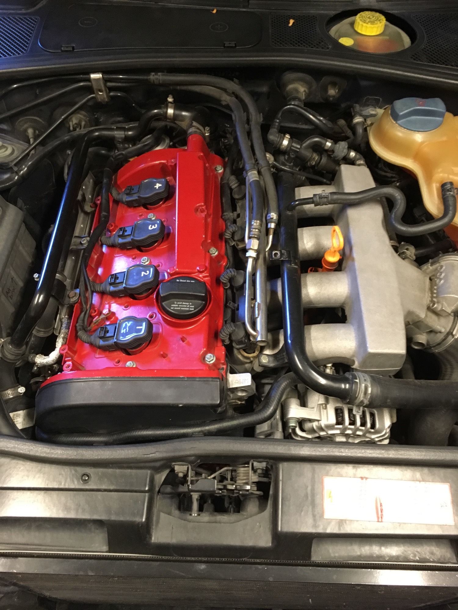

I bought this used with 130k from Spalding in Spokane. Tested, rated, high compression. I replaced everything but the long block including the turbo and oil pump. New flywheel and clutch, new crankshaft seals, motor mounts, injectors, everything. Learned by doing and it took a while. Unheated garage then. Good thing it's another cult forum car - lots of advice and DIYs out there.
And it looked like this!
(the beauty of the Audi A4 is you unbolt the front and slide the engine right in without lifting over the radiator or taking the hood off. Also handy for timing belts - that's how the dealer works on them - "Service Position") This was the most complicated packaging of anything I've touched, and just a spaghetti of hoses, pipes, wires, connectors, sensors, clips. I marked all ends with green painters tape.
I leave all the plastic covers off - I like to see the engine and anything maybe going wrong.
Audi A4 engine.JPG (552.92 KiB) Viewed 388 times
