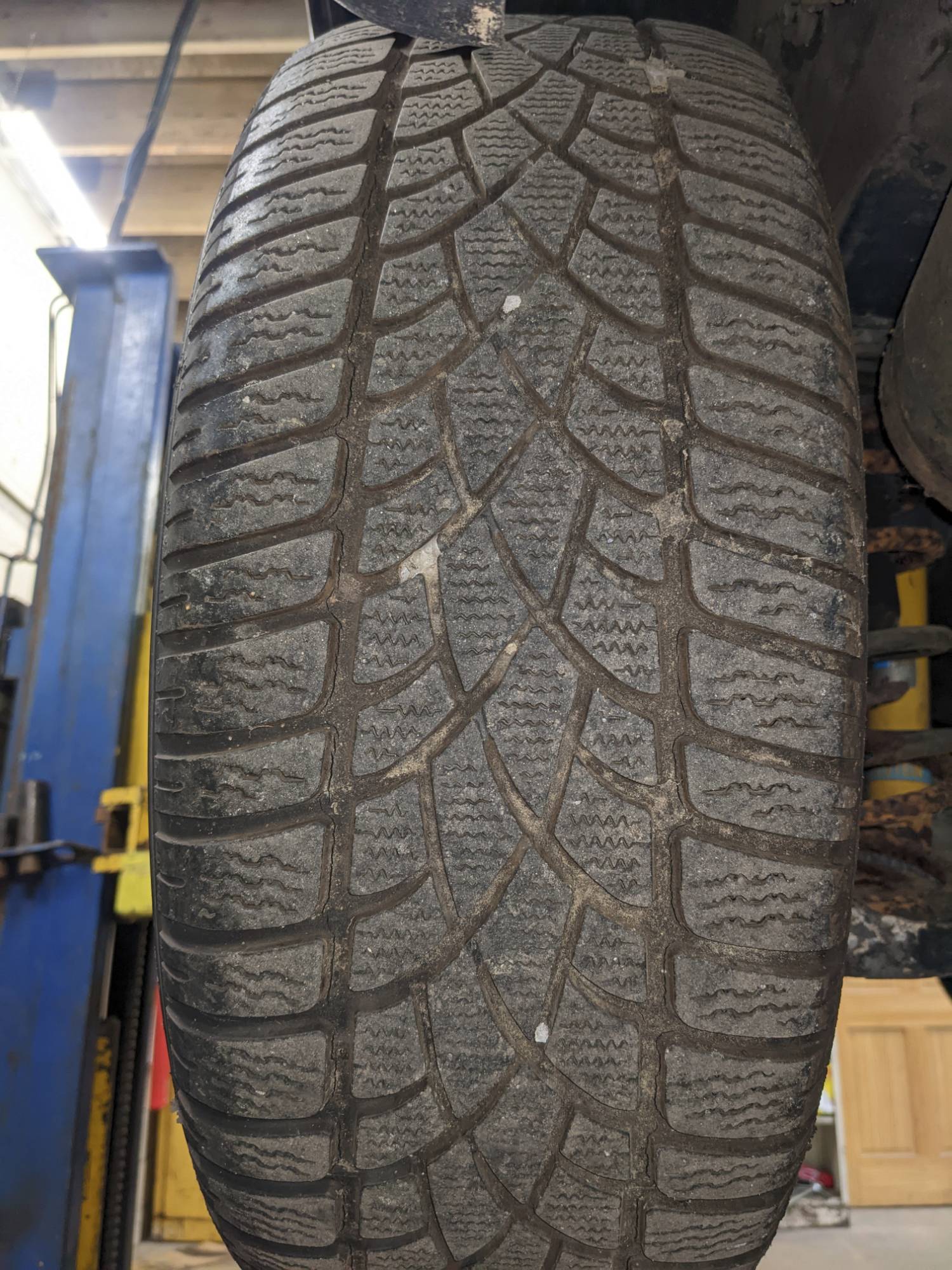

Tire tread separation:
The tires have a date code of April 2010, their tread is great, and sidewalls are free from cracks. However they have cracks along the base of each tread. How much of a risk are these to use?

- Cracks at base of tread
- PXL_20221127_054716559.jpg (466.86 KiB) Viewed 409 times

Those are "around town" tires at best. The flat spots might work themselves out, but between the cracks and the age, they're ready to be replaced.Tire flat spots:

It might be worth one hot summer run to see if those flat spots come out with heat. At 13 years old my inspection station here won’t like them, but I have run worse by inspecting in my snows and then switching to funky tires.
If the tread is good, you protect others. Despite the fear mongering of the tire industry to replace 5 year old tires , they just don’t randomly blow out. If you are going for driving your high speed northeast runs on I95, it’s time for new shoes.

With those cracks...toss them and get decent tyres.

I had a too-old tire but with great tread depth disintegrate on me once on the highway. Don't risk it for a couple hundred bucks. I would definitely investigate any fuel smell/leak and carry a proper fire extinguisher in the meanwhile. Other than that not too much to worry about I would say. Clear any codes and see if any come back.

Moderate to high risk with tires this old if run on highway, especially in summer heat.

Tires have a lifespan. Not knowing what conditions they were stored in, I would replace the front set of tires with new ones. Especially if I have to transport my family. Even more so if they have already been repaired.FireFox31 wrote: ↑29 Nov 2022, 22:21

Thanks for the input, especially about the tires and fuel system. You're right that it's much cheaper to replace the tires than to pay for damage from an accident caused by tire failure. My 2000 V70 came with four nice Michelin tires though one had a lightly sliced sidewall. I just had that one tire replaced and will install the four next time I'm on the lift. I'll save the flat spot tires (on wheels) as sacrificial in case I ever need to park a car for long term like scot850's R.
