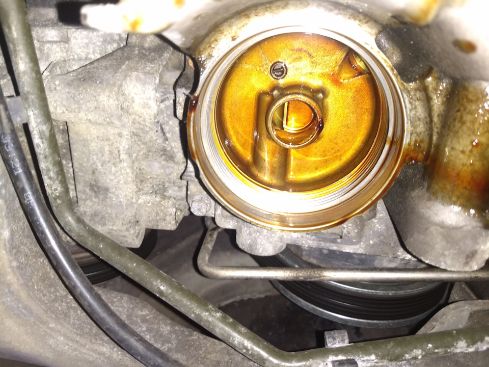

Successfully extracted the bolt! Drilled a 1/8 hole into it then used a t25 and hammer to tap and rotate to loosen simultaneously.
Original CV fixed vibration issue. Past return window for the cardone junk… lesson learned. Might get it replaced and just keep as a spare I suppose.

Two years on Mobil 1 0w40 European Car Formula (3 oil changes), after a full engine rebuild and hot tanking everything. Hmmm...
Didn't have anything like that with Amsoil Signature or Red Line.

Eek, I use 0w40 m1. Mechanic made me switch from Castrol. Not sure what other option I have. Pennzoil?

br0dy519 wrote: 03 Dec 2022, 06:10 Eek, I use 0w40 m1. Mechanic made me switch from Castrol. Not sure what other option I have. Pennzoil?
The discoloration of metal is ok. That means, the base oil itself sticks to metal better than the cleaning additives it has. I'll have to watch it over time, if the oil starts to cause "castrolisation" of the engine (heavy sludge).
Red Line is super rich in calcium (cleaning agent). The engine was consuming oil via old/bad valve stem seals. Oil was burning out, calcium was forming a brittle cement-like deposits in the combustion chambers. Cement was flaking was and got caught between valve face and valve seat, jamming the valve and allowing flame bypassing it. Eventually one valve burnt off, the rest were heavily pitted.
I'm ok with less cleaning engine oil now ;)

Krons wrote: 03 Dec 2022, 12:13 In your opinion better to stick with lower calcium oils in our higher mileage 5 cylinders?
In my opinion I threw out hundreds of dollars on boutique oils ;) I took apart another 2.5T engine, from a road worthy car with similar mileage, it had three times the wear compared to my engine, but it was still running, while mine was not.
Super fancy oil will make no miracle in a old, worn engine. That's for sure. Stick to a quality oil and keep changing it every 5k miles / 6 months, whatever comes first.
