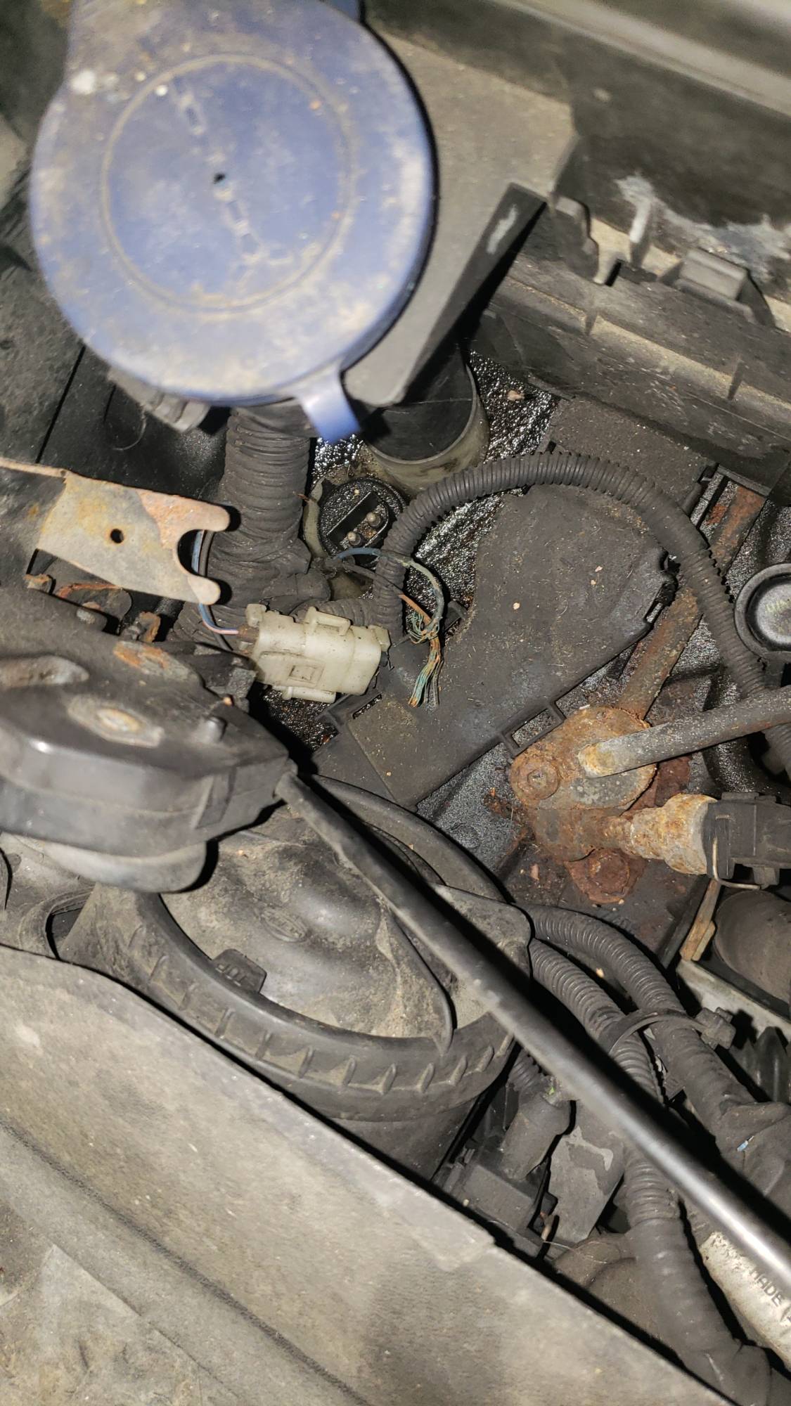

Does anybody know what this broken wire/white plug is used for on a 1999 S70 GLT? It's located near the passenger side headlight, between the headlight and the wiper fluid reservoir, right in the middle of the picture below. I've noticed the wires frayed before, but they're totally broken now and while I don't drive the car much, I haven't noticed any missing features. It looks like they should go into the white plug, and then that plug leads into the giant wire bundle so I have no idea where those go. I wasn't able to see where the frayed wires go either.
I also have no idea what that open black plug is for, so any guesses on that are welcome too.

That black plug looks like the washer pump motor, do your squirts work ?
Two things live up there , headlight wipers and the alarm connection to the hood latch. You May or may not have those options

+1 Abscate hit this on the head. You have no connector on your washer pump, the 2 pins just above the wires in the picture. If your windshield washers are working I am not sure how!!

Just looked at my 99, the white plug eventually connects to, I think, the washer fluid level sensor, which has blue and black wires.
The plug that connects to the black plug has black and green wires.

Aha, that would explain it. I can't recall the last time I saw a low wiper fluid warning. My windshield wipers and wiper fluid do work, but I removed my headlight wipers after a minor front end collision that required a new bumper cover (couldn't find a cheap bumper cover with cutouts for the headlight wiper arms). I completely forgot I used to have those.

I was under the hood changing a headlight bulb, in my 99, and recalled this thread. I have that white connector, but I don't have that plug next to the washer fluid filler neck. It's more of a white-ish plastic depression.
