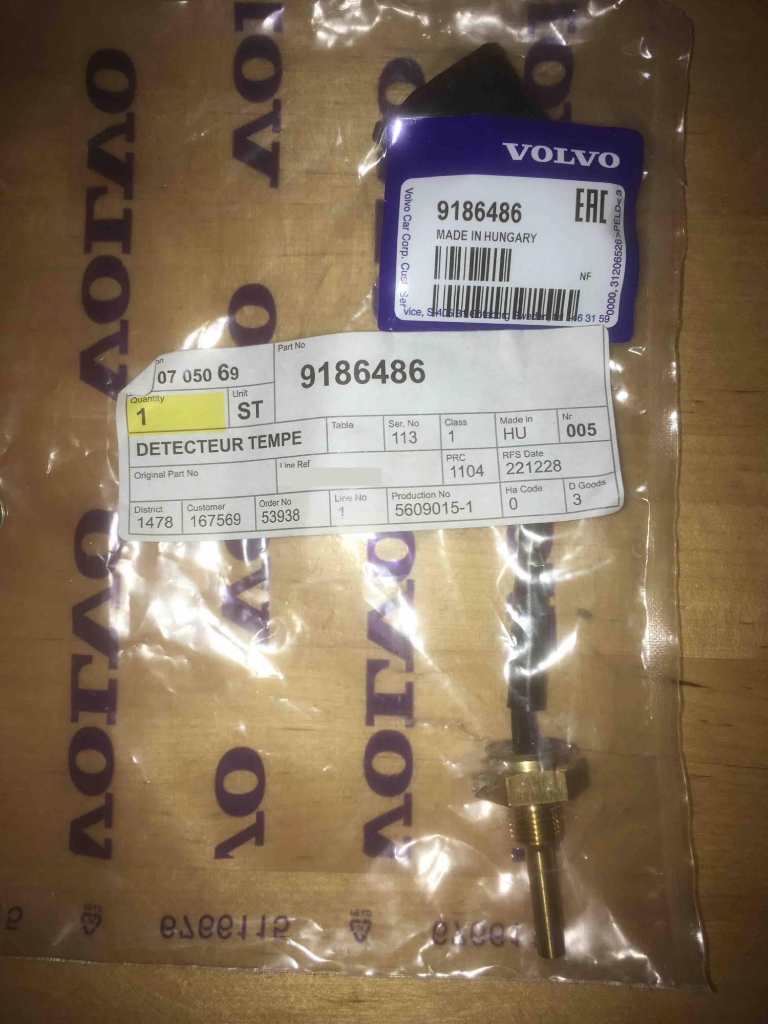

manovlov wrote: 27 Dec 2022, 21:50 all right Guys. I will order one to Volvo. Thanks.
If your old ECT was original and was working properly...you might re-install it and see how the engine runs.
Chances are that you don't even need a new one.
Don't forget to remove negative battery cable while installing the old one...in order to reset bad fuel trims.
Mine is still original. ;)

Solved. With the advice of Misha, I've replaced the coolant sensor by an OEM one. Everything is fine, now.
Thanks, Misha.

The troubles continue...
I've checked all vacuum lines, replaced the coolant sensor by an OEM one... The issue is still here. The engine goes warms normally, the gauge needle doesn't move, and finally i hear a sort of inspiration noise around the brake booster and then the engine stops.
Add to this, the electrical fan starts as i introduce the key on position before to action the starter. I've replaced the relay, but it wasn't the problem. The fan need to be replaced.
I'm going straight to a big bill I think...

Then it is wiring problem for ECT from wiring loom side.
It have to be it...it's a classic bad ECT sensor symptom or it's wiring.
Since ECT is oe and brand new...the connector or wiring for it from wiring loom side is bad.
