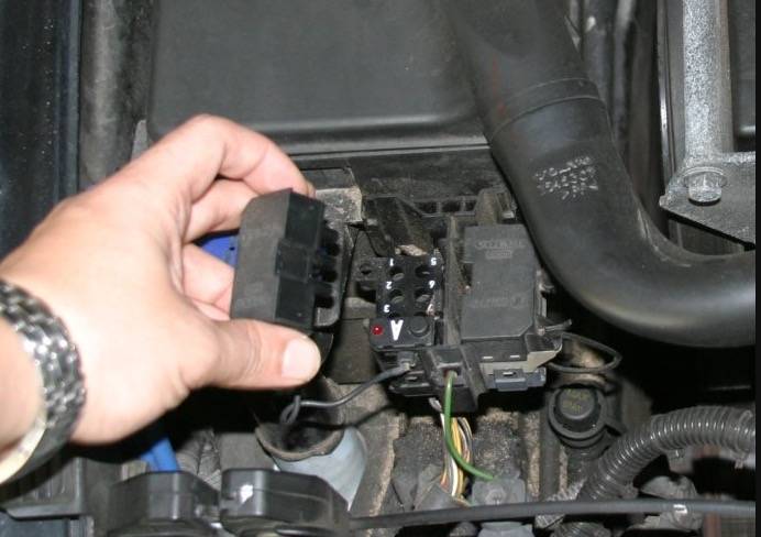

Nope, i have this :850oldschool wrote: 04 Dec 2022, 12:48 My car is a 96.
Do you have the 16 pin connector under the coin holder next to the cigarette lighter?

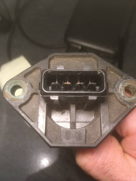

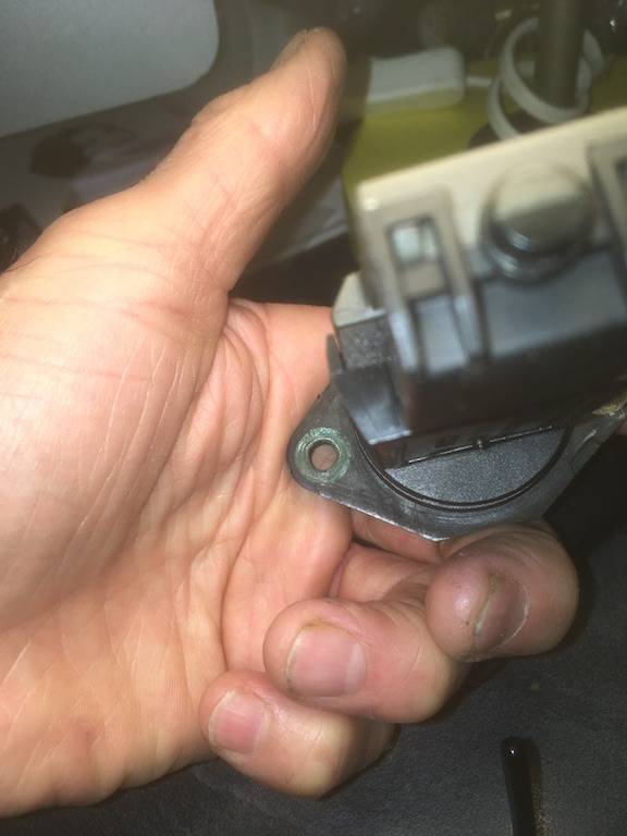

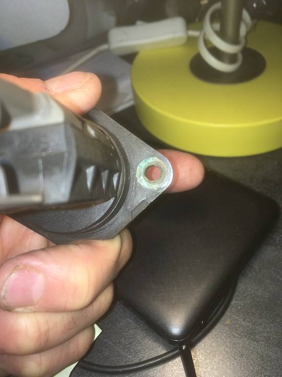

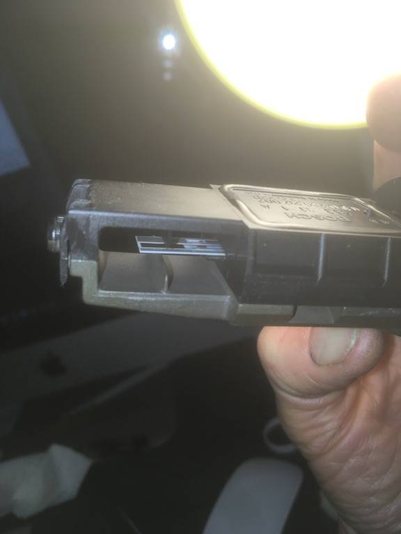

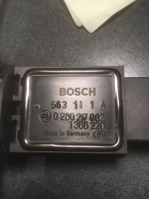

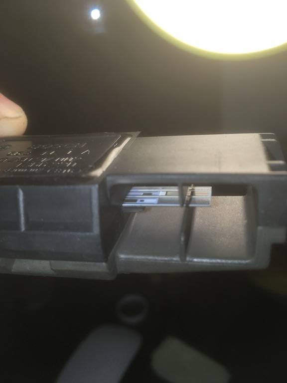

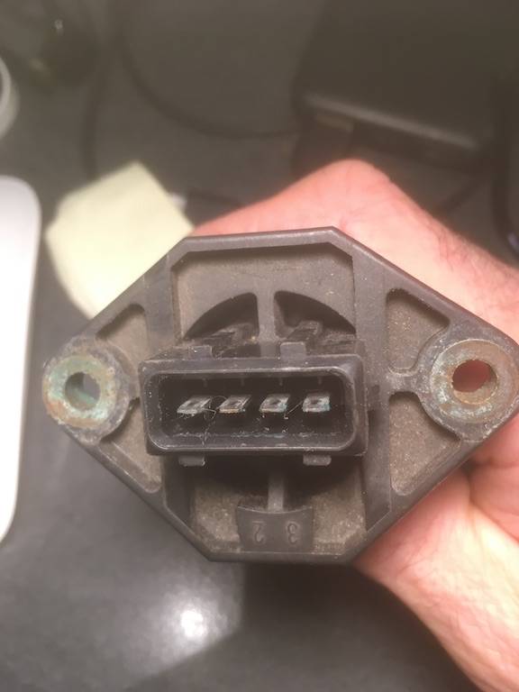

News.
MAF unpplug, the engine turns low(about 500/600/700 RPM) then stop.
Idling MAF plugged
MAF sensor itself
Idling MAF plugged
MAF sensor itself

Do not unplug the connector while engine is running!
Remove connector,start the engine.
If the idle is stable and runs better with Maf unplugged than it is bad.
In your case....since you did a pcv job recently...i would check if there is a vacuum leak somewhere.
Pcv valve,intake manifold,vacuum tree,main big plastic hose from airbox to throttle body,fpr vacuum line.
Read the codes and post them here so we can see what's going on.
Did you plugged in a TPS sensor connector after pcv system replacement?
