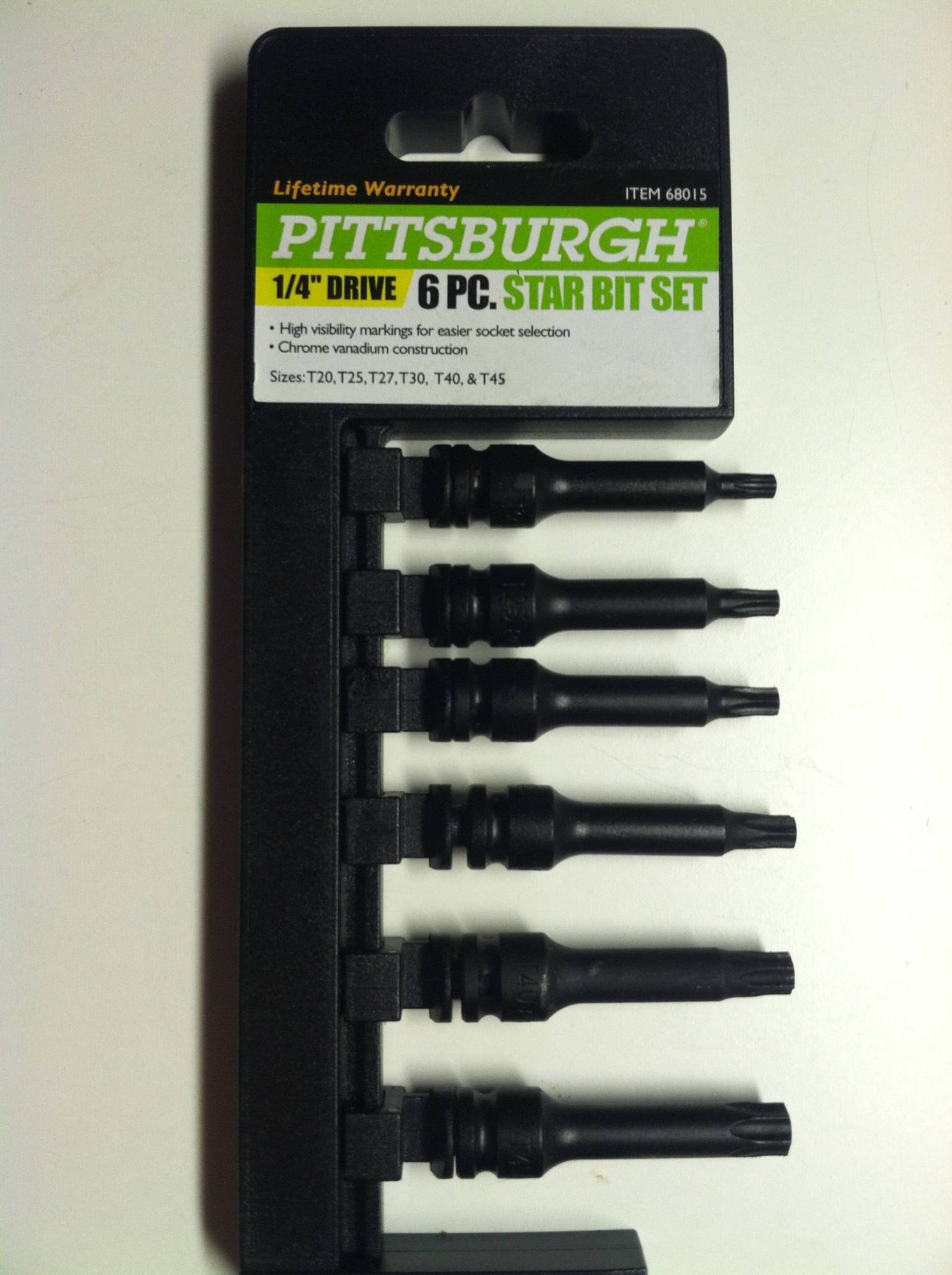

If you apply oil, make sure to rinse it out of the drive recess with solvent, because the lubrication will make it easier for the bit to twist out without loosening the screw.

T40, use a fresh bit. Yes on the juice gone in the tank, try the drain on the radiator but be gentle, it's plastic. Shouldn't be real tight unless it has Muck of Ages on it. It seats with an o-ring.tjmartin317 wrote: 09 Jan 2023, 12:24With this being the hard part, I'm still going to consider this an easier job than anticipated. Will blast it with PB before hand and apply some anti-seize after.scot850 wrote: 08 Jan 2023, 16:20 2 x T30 or T35 threaded screws in them that like to seize in place.
