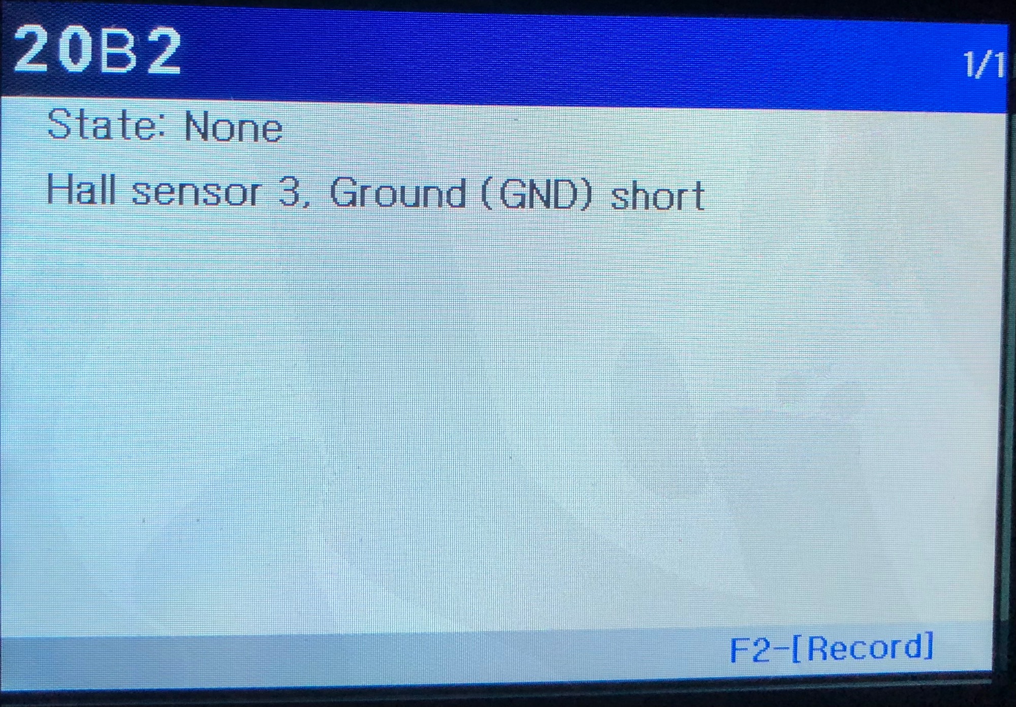

Anyone have a diagram on where the hall sensors are located on a C70?
Opened fine, got the error trying to close it. I was able to close the top but looks like I have wiring to check.

I was able to track down some excellent information here, may be useful to others:Krons wrote: 07 Jan 2023, 16:16 Anyone have a diagram on where the hall sensors are located on a C70?
https://www.volvoclub.org.uk/volvo_workshop-c70.shtml
