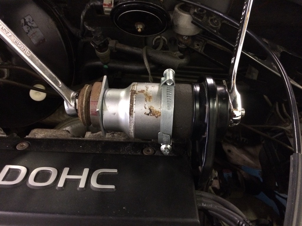

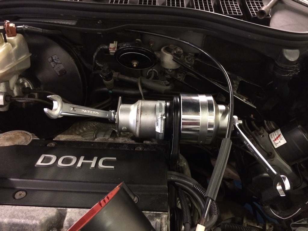

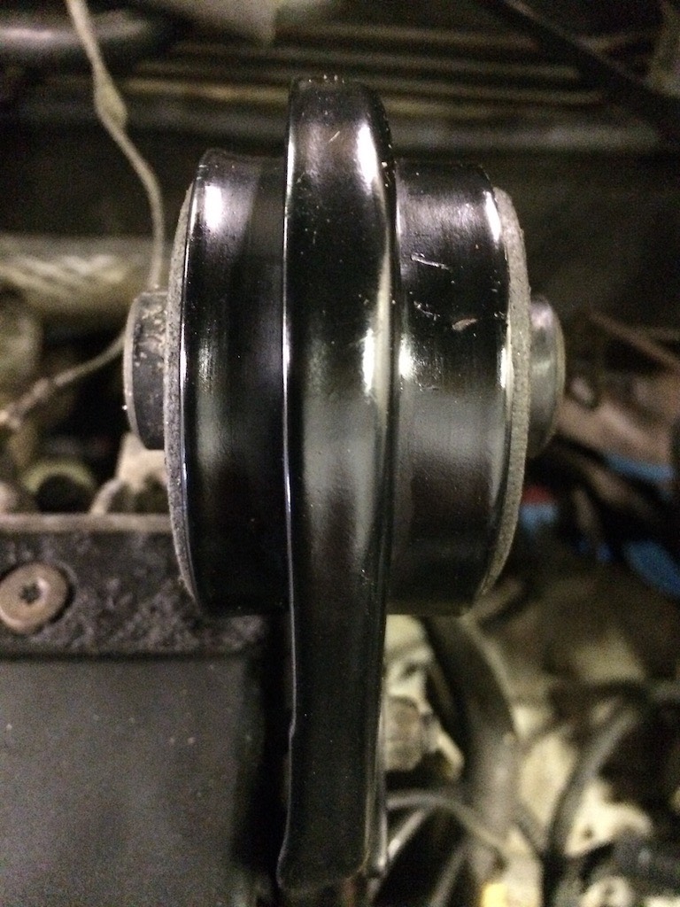

Still available from Volvo. Need some creative thinking to press the new bush in
This was my method
