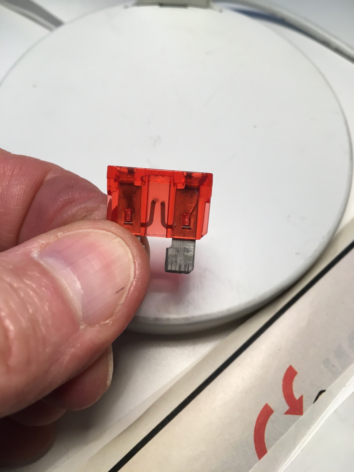

My #10 is burned, ah ha (?). The #16 is fine. I changed the #10 with a spare, and still no washers front or back.

The fuse may have been burned bc of a short inside the washer pump.
After that, the pump short-cuit might have been burned, so no longer had a short,
thus the new fuse seems OK.
