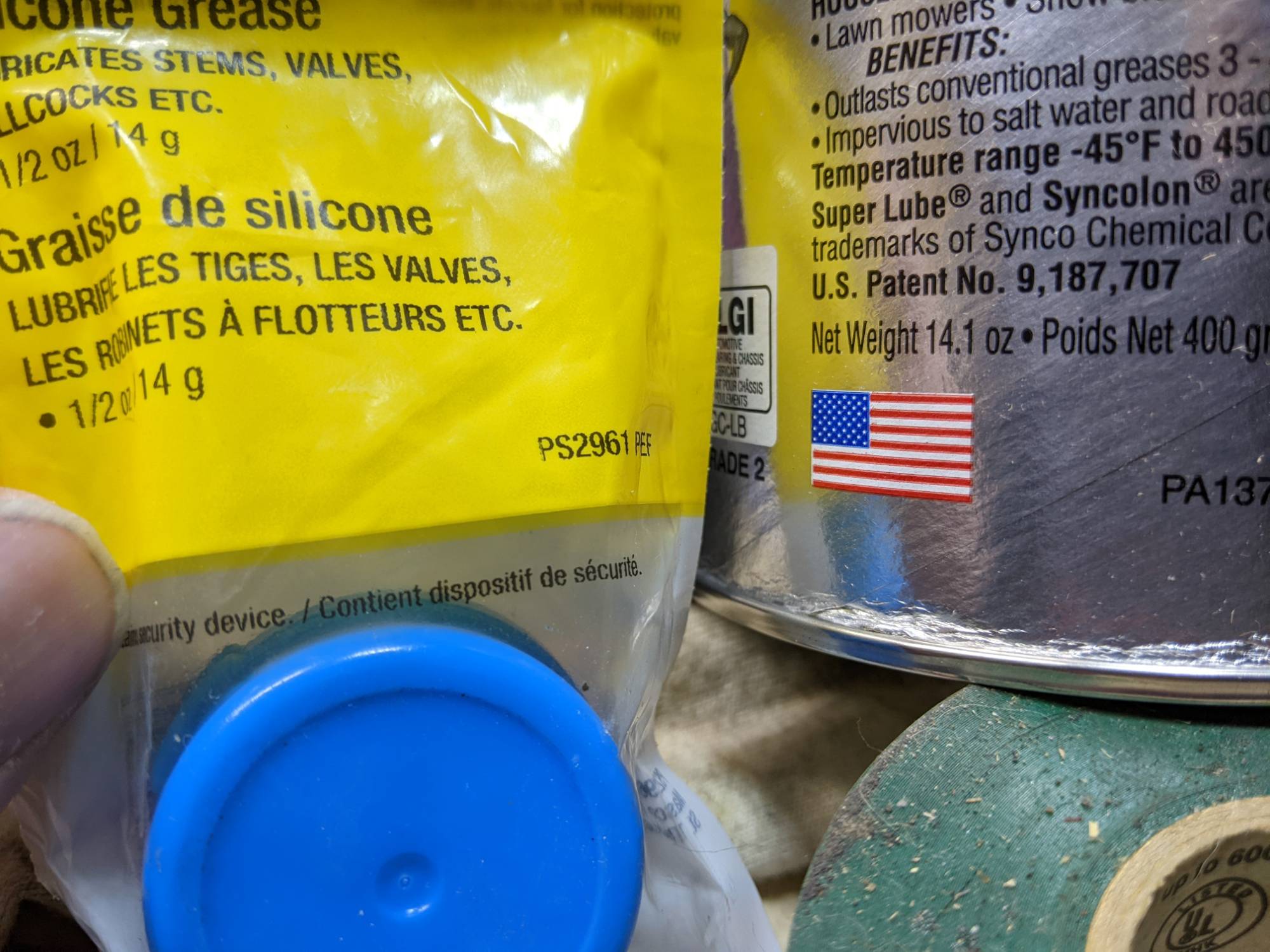

Here for Al's entertainment is a few pictures that may also be of help to others:
The smaller blue 'puck' is Plumbshop silicon grease which is what I used on the power antenna this time
This may give some idea of the potential uses for the synthetic grease. Note it is also good to +450C!
Look at the differences in weight of each grease. Silicon grease cost about $10 from a hardware store for 14 gms. Synthetic grease cost about $25 on Prime from Amazon.ca for 400gms!!
I haven't as yet checked the consistency of the synthetic grease. The silicon grease is a bit like margarine from the fridge.

Hi Neil,scot850 wrote: ↑24 Feb 2023, 16:56 Thanks again Mo for adding the link in usable form.
