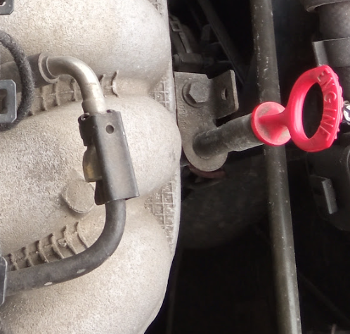

I'm getting ready for PCV replacement in my V70 2001 170HP N/A and just noticed some additional metal clip/bracket on fuel quick connect line. Is this factory one? How to remove it?

Hmm, that’s a strange fuel connection. I have not seen that before

The clip just pops off at both ends. There's a special tool to get the lines apart but maybe you can improvise something to release it. If not you can disassemble it from the fuel rail. I believe I've seen a Youtube video showing how to do that. You take the back cover off and then the fuel line comes out with the oring on it. I could not find a suitable replacement for that oring on my 2000 S70 but fortunately I didn't need to.

Thanks, if it just pops off then it's a relief I don't need to purchase any special tool. I do have fuel line disconnect tool so I should be fine once I remove this metal clip. Seems like an extra precaution item in case quick connect fails and disconnects by itself (which already seems very unlikely to happen).
