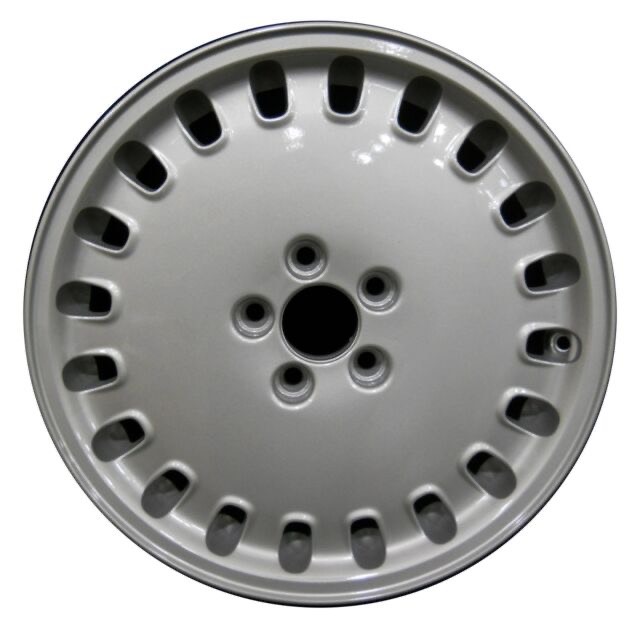

“Uglies” would like a word with you

Even that wheel has a mother….

Well it's good to know somebody loves it!
