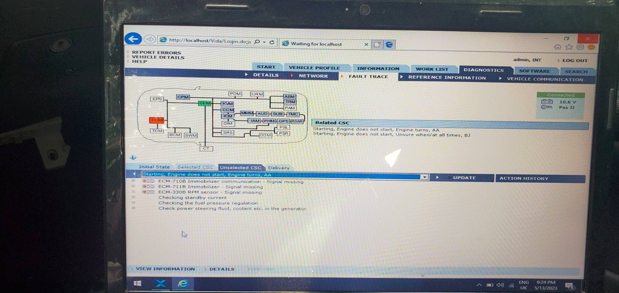

I have here a couple post with a problem a have on my C70 2007. I was thinking it could be the fuel pump. Apparently is not. I also have, and related, a post asking for help with my Dice. Well I just got a new VCX NANO, and it was as easy and smooth as possible. It seems the Dice was not operational, so on EBAY the VCX NANO was in sale for $80, it worth it.
It gave me immediately the code ECM-710B Immobilizer.
The problem I have is the car will not star, the engine turns but wont star.
I do need help if someone can please help me to repair this problem.
I'm attaching a screen shot fro VIda using the VCX NANO
