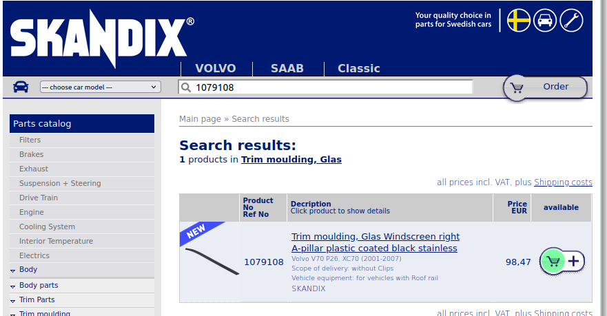

Yes, with junkyard rubber trim.BlackBart wrote: 18 May 2023, 12:48So he did that recently, in 2022.erikv11 wrote: 18 May 2023, 10:16 It's common here! On both of our P2 cars the rubber trim is basically disintegrating.

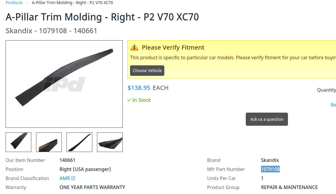

The rubber can be separated from the metal trim, just grab the bottom part of the rubber and peel it away from the painted trim. However the rubber alone is only available aftermarket e.g. the IPD link. S80, S60, XC90, XC70 all use the same rubber strip but it should be siliconed back in. I'm no expert on this, giving you the info secondhand from DonnVa viewtopic.php?p=603762#p603762

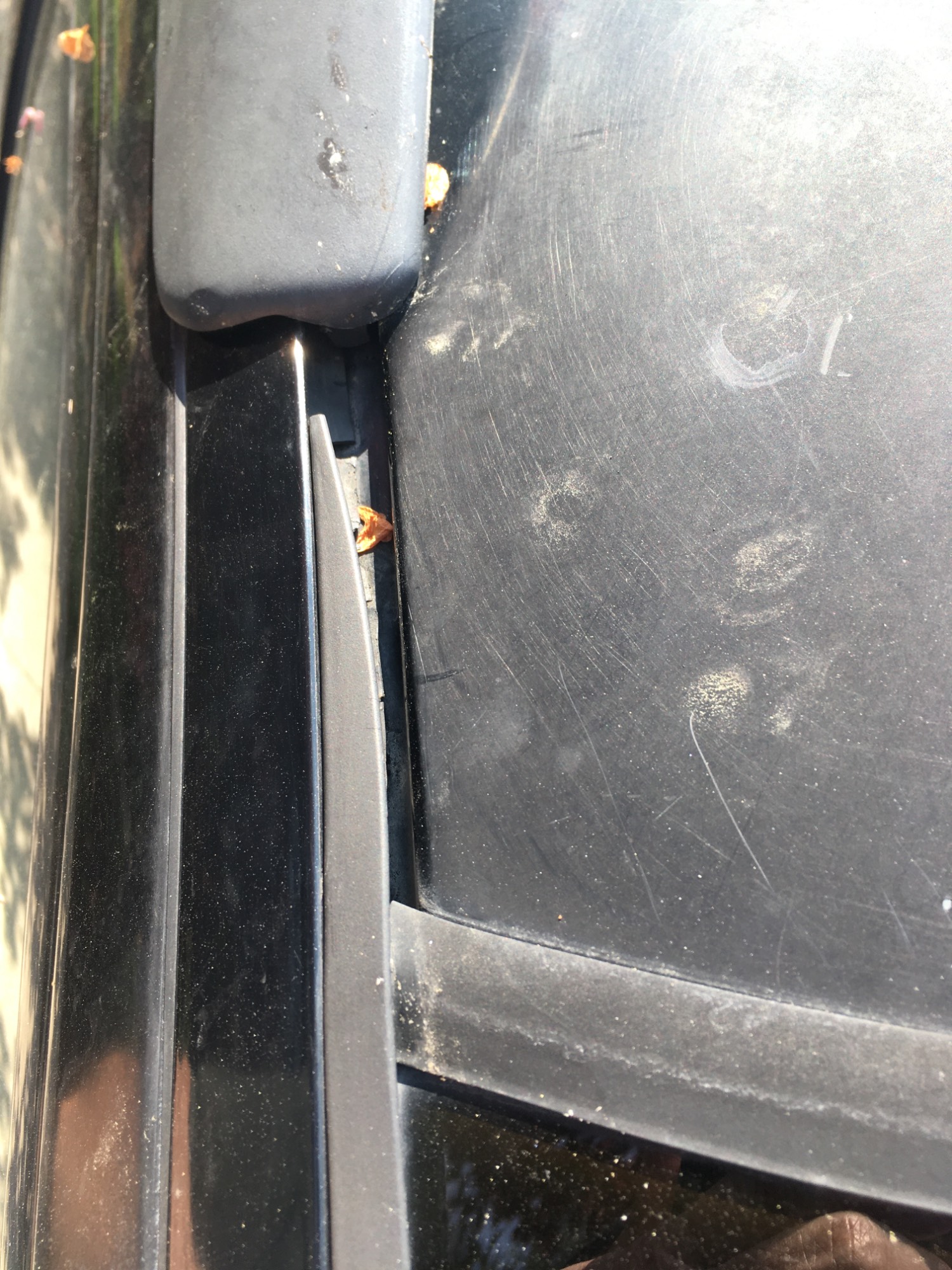

So, does the rubber run up under the roof rails or does it stop there?

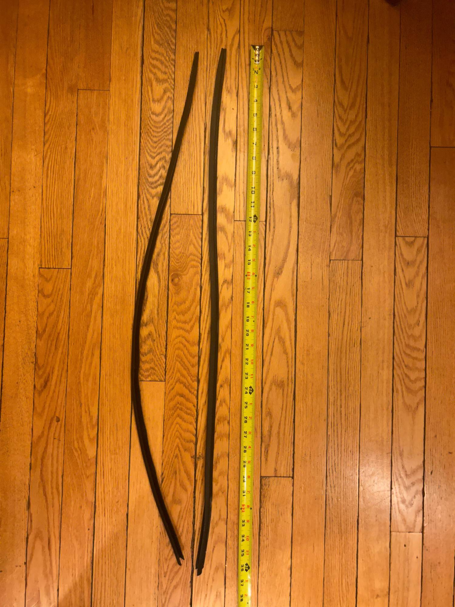

On a P80 the side windshield trim is well documented and discussed. That's a metal-backed piece, different animal, routine to remove/install but no new replacements available of any kind AFAIK. Junkyard only. Without rails one piece runs from the windshield corner all the way to the tail gate, with rails it is a different, shorter part that stops at the rail foot. Or you can cut the long ones to size.
On a P2 the rubber piece that you can pull out is short, it runs just past the top of the windshield:

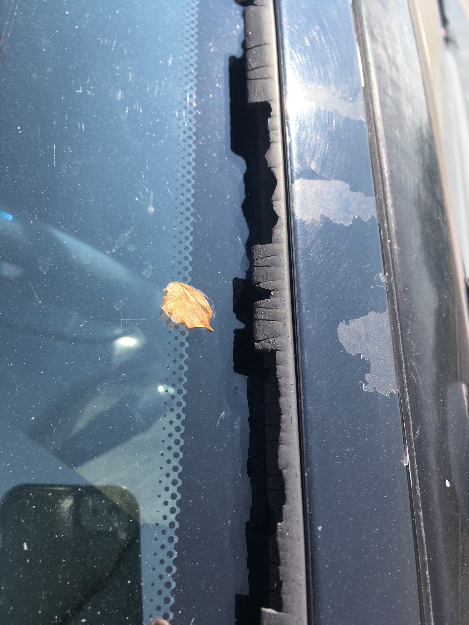

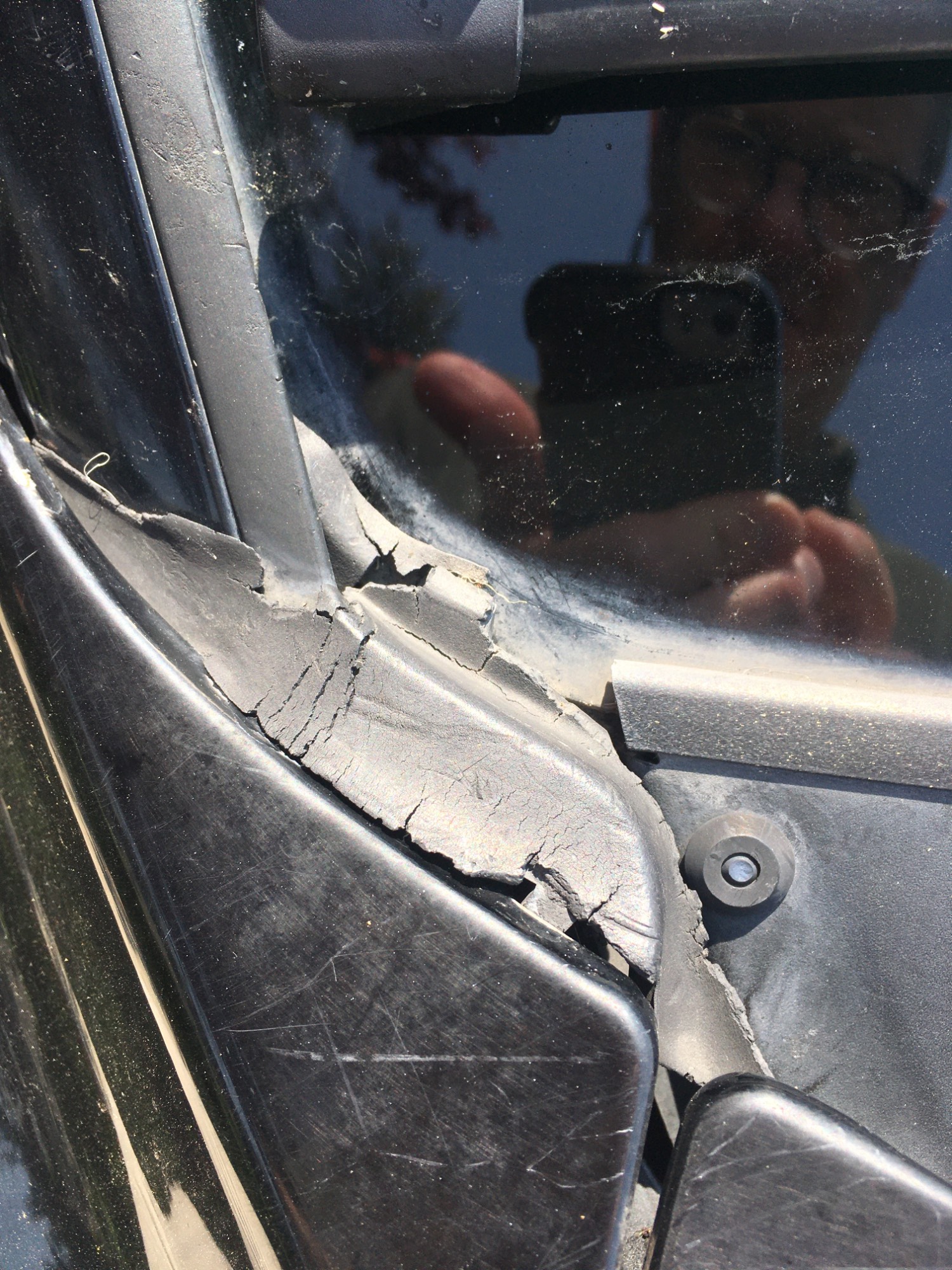

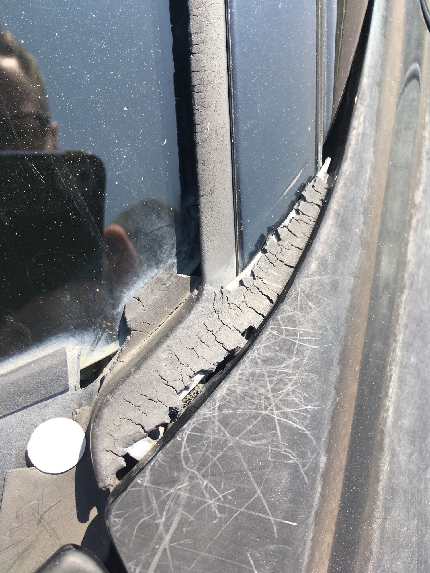

I think the PO of our wagon left it parked in the sun for long periods. Dirt roads, hiking, pitted windshield, faded paint.
Right base ( I have these) Right upper. Rubber curves to a stop just before the rack base. Directs water into the roof trough. Left base. Left rubber is gone.
