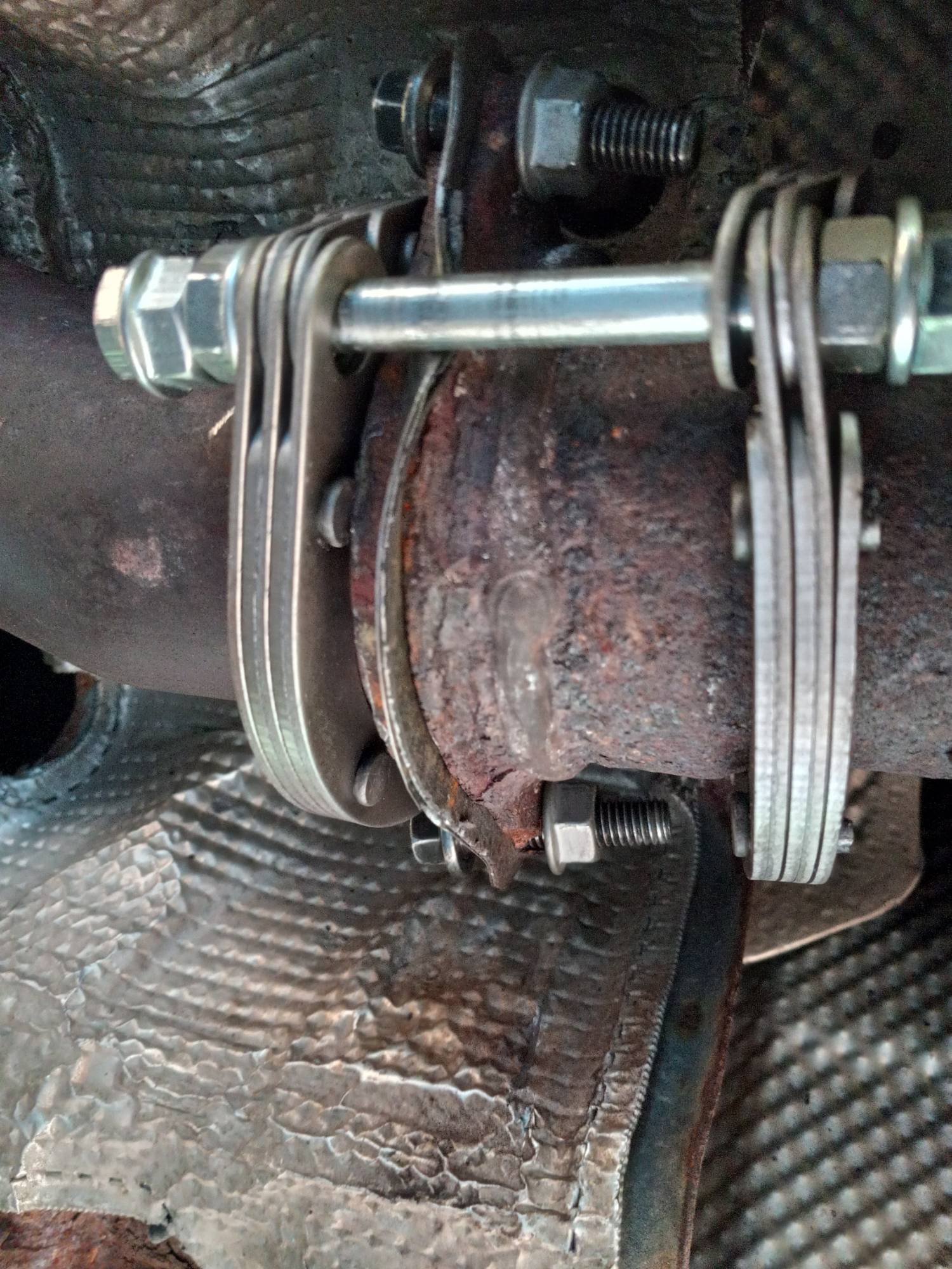

spent all afternoon fighting with the front muffler to cat flange, still getting a small exh leak at the bottom of the flange.
So I removed everything again.
I ground the mating surfaces flat and shiny, new gasket.
Better but still a slight pfft.
Whats next, exh cement?
Looking at the photo I think I assembled one of the clamps wrong, its pulling apart.

Where's the flex pipe? I don't think you'll keep it from pulling apart without one, unless you do all solid engine and trans mounts to keep the engine from moving even the slightest bit.

Cut those flanges off amd bridge the pipes with a band clamp, the only thing cooler than oetiker clamps

gnalan wrote: 21 Jun 2022, 18:17 Where's the flex pipe? I don't think you'll keep it from pulling apart without one, unless you do all solid engine and trans mounts to keep the engine from moving even the slightest bit.
flex pipe is before the cat,
this joint is after the cat.

using a new gasket, slathered with exh cement, it sealed up nicely.

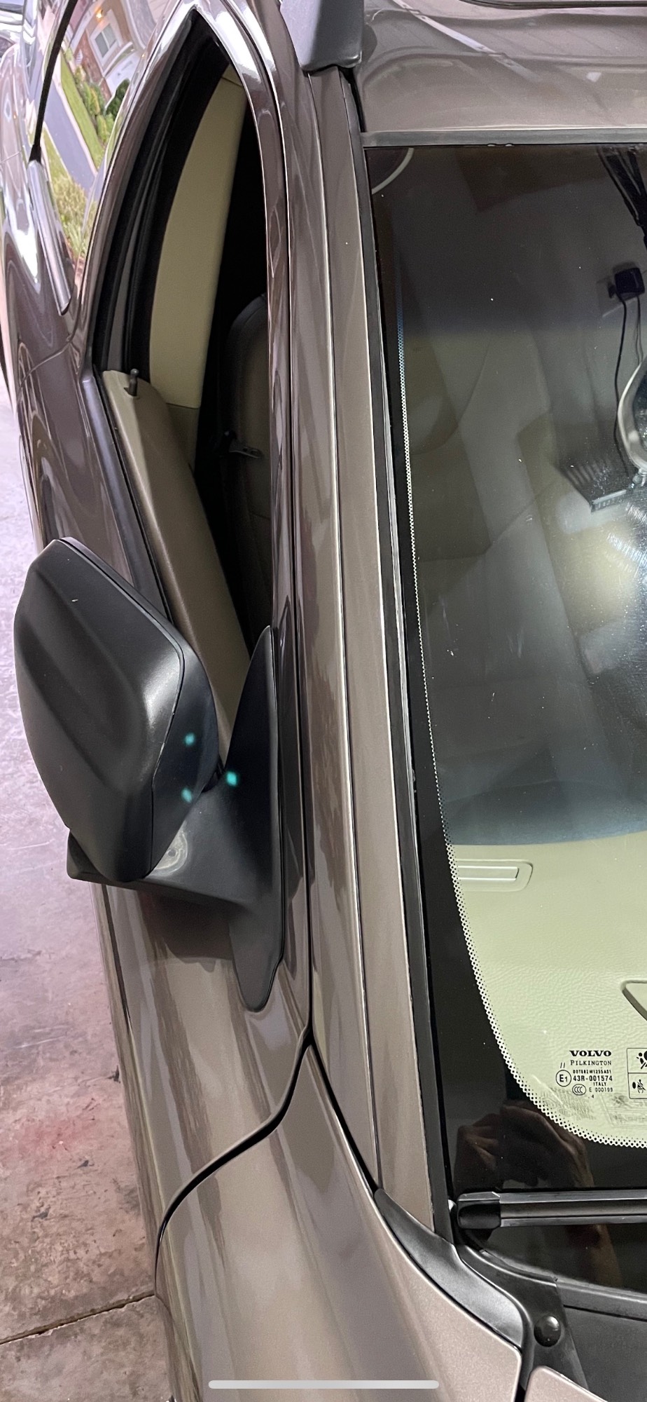

I replaced the rubber drip trim and cowl pieces on both sides this evening. Looking good. 😀
