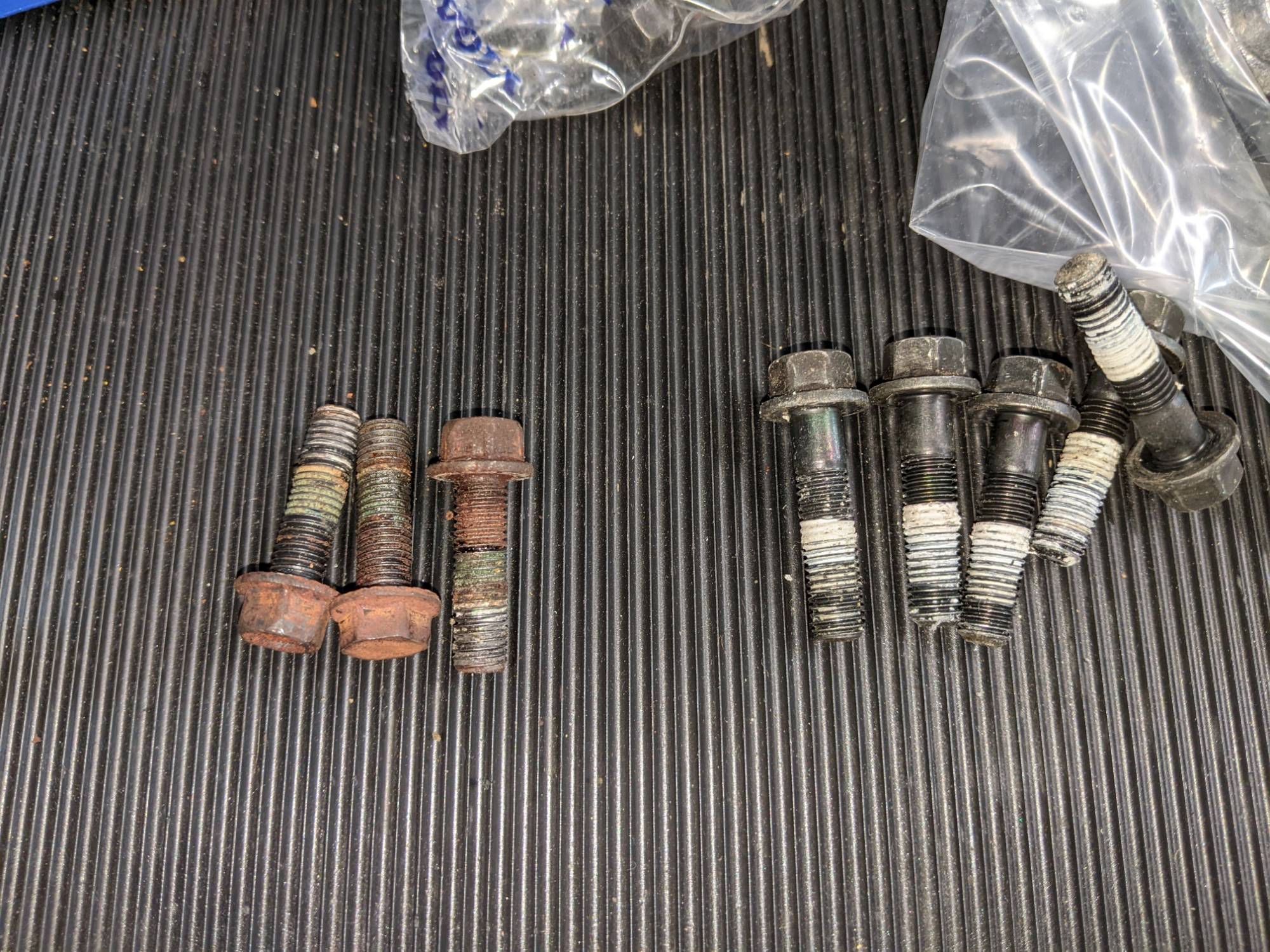

I got my friend to order a replacement Aisin water pump as it is the OE supplier. Pulled it out the box today to find not only is it different to the aftermarket one fitted to the car, but also an older Volvo pump I pulled as a spare from a low mileage car.
I had planned to re-use a set of Volvo pump bolts from the used Volvo pump, but realized they were about 5mm longer than the bolts I took out with the aftermarket pump.
Water pump bolt size change
The Volvo bolts from an older pump are on the right and those from the aftermarket bolts are on the left. The shorter ones are 25mm and the Volvo OE are 30mm from the old pump.

So I decided to check the depth of the holes in the block. I discovered that at least one bottoms out, 2 are deeper but feel like they bottom out, and the other 4 go all the way through. I thought this may be ok, until I discovered the bolt holes do not appear to be threaded all the way through. I estimate they are threaded to maybe 15mm but I will depth check all the holes tomorrow with a bolt and nut so I can measure the threaded length.

As I have been waiting all day for the delivery of the thread sealant from Amazon (I'm sure we are the last drop off for packages.....!), I took time today to measure the bolt hole depths and came to a surprising discovery.
I don't know how to annotate a picture, but I'll try to figure it out. The 5 bolt holes closest to the left are all through to fresh air!! The bolt limits are either because the threads were not turned all the way through or they are full of crap from being open for 27 years.
The 2 most RIGHT. (2nd from top Right and 3rd from top) are not drilled all the way through. They have a max. depth of 22mm approx.
Good news is the original bolts on the car with the aftermarket pump will work. At 25mm long (which is I believe the length of the current Volvo bolts) it gives about 3-4mm space in all the holes with the thickness of the pump and the gasket. The old bolts are 30mm and would bottom out (just) in the holes.
