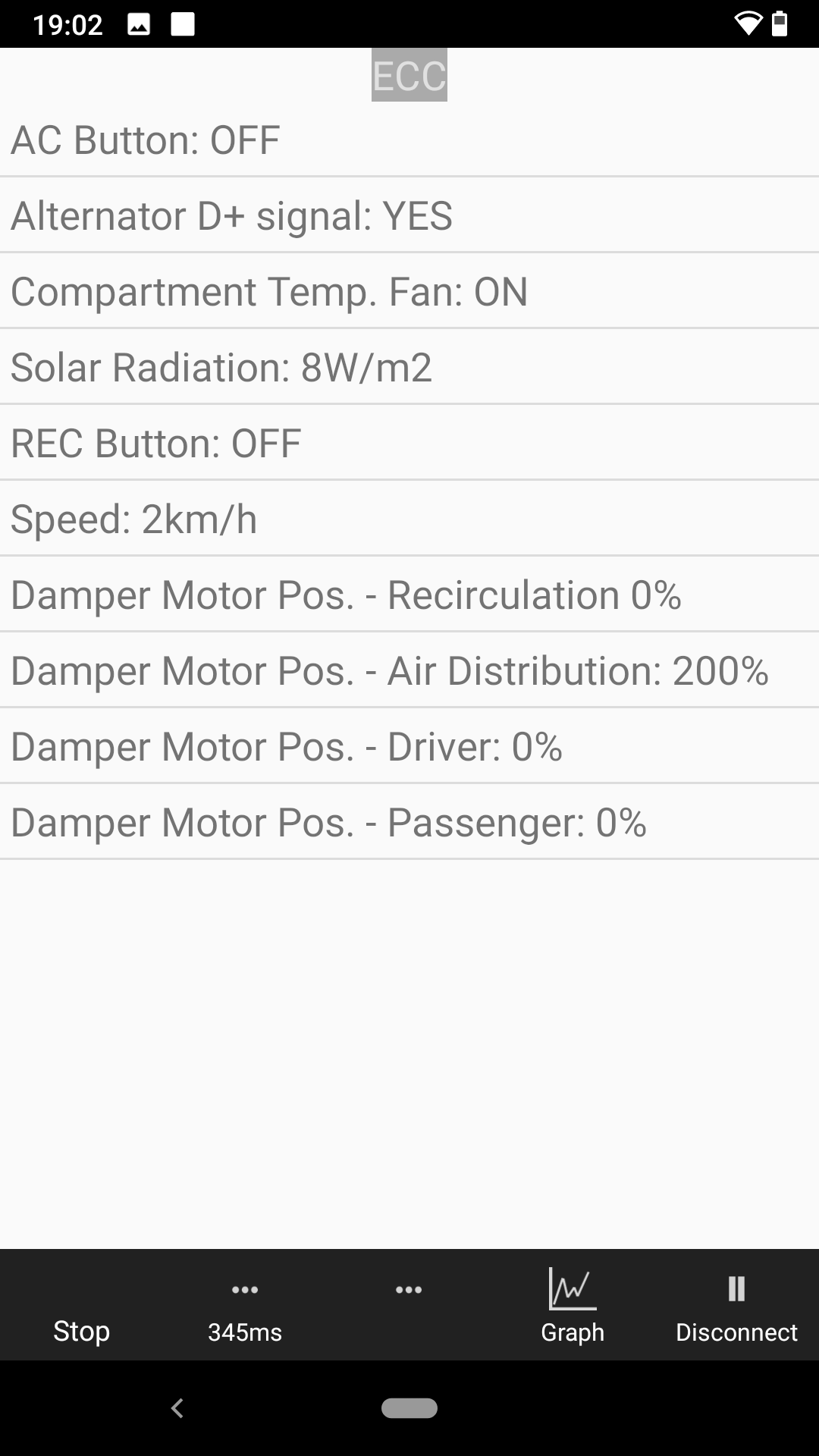

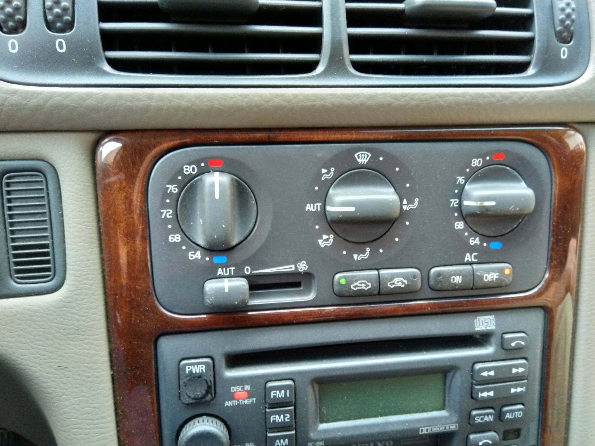

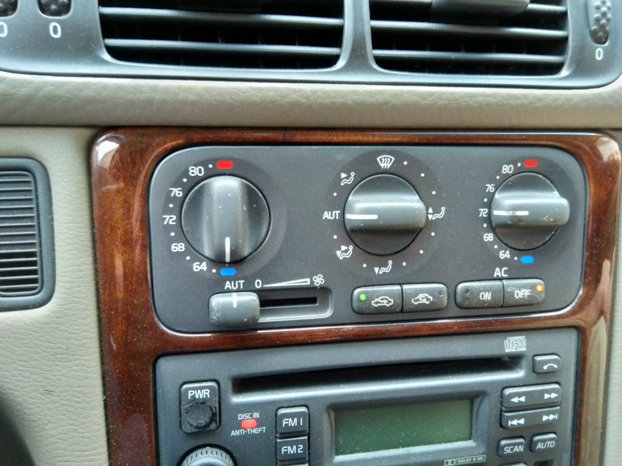

Something I noticed messing with it in text mode - with passenger set to 72 and just messing with driver, if I go full cold on driver, the reading goes to 0% on both sides (as for actual temps out of the vents, driver stays full hot, passenger is full cold). When going to full hot on just driver, passenger also reports going full hot, but it doesn't get any hotter coming out the vents over there (and the dial stays at 72).
And then cold on driver only, and the readout it was showing:
None of this makes any sense. The driver side never feels anything but full hot, and the passenger side (while it works fine) doesn't feel anything like what's being reported, though the temperature from the vents feels like what it should be for the passenger side

Volvo does say if its "Air distribution selector" is in AUTO position ECC will control some functions and tells to put it in any other position (for some reasons..).
I have heard and asked previously is it normal if both passenger and driver move at the same time (or reports so). Though i don't have specific answer for that still yet but i did check reporting comes individually (maybe its like "wish these to have here" more like? than actual status of now?).
There is still some Live data items missing for ECC and programmable parameters still i try add in coming updates then example just my head tells me as thinking of these that temperature of cabin would be important to check so i will add that example but i try add rest of them too.

Changing to manual control of center knob doesn't change if it works or not, but maybe it will allow it to try to relearn again?
Do you think it might have something to do with the ABS module? I noticed that the ECC is always reading a slow speed - never 0 kph when stopped. The ABS module in my car has bad solder joints and I need to get it rebuilt. Would that have any effect? Doesn't seem like it would, but you'd know better than me.

That speed info yes from ABS i would put my guess.
I think speed of fan at least affects. I forgot did it else. I be back as i get finished with updates with more info.
