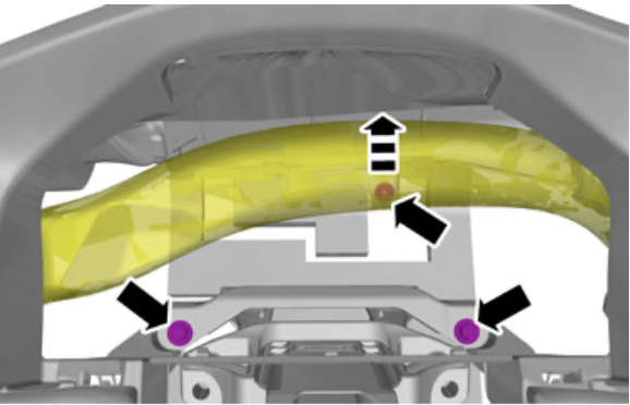

I'm currently attempting this on my 2012 S60. From what I've found, this guide is very similar to what I'm working through. The one thing I'm struggling with...accessing the blower motor through the instrument panel.
I can't seem to understand how to remove the air duct that is located behind the instrument panel. It almost feels like it's connected somehow to the dashboard at the back.
I'm referring to the yellow colored tube in the diagram below:
Screen Shot 2021-09-28 at 10.36.37 PM.png (209.38 KiB) Viewed 2693 times

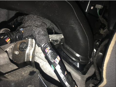

There are notches on the base which implies you should be able to take it on and off...but the back feels like it's wedge between something and the dashboard.
Screen Shot 2021-09-28 at 10.40.26 PM.png (322.91 KiB) Viewed 2693 times
Anyone have any tips?
LTP
Posts: 10
Joined: 22 September 2018
Year and Model: V70 D5 '08
Location: UK Midlands
Has thanked: 1 time
Been thanked: 2 times
Post by LTP »
Memory is fading a bit as it's been many months since I did this job (and have since changed the car so couldn't check even if I wanted to) but I seem to remember my ducts having some double-sided tape holding it up - but I could be wrong and confusing it with the sound deadening. I do remember that the duct was a bit of a faff getting it out and back in at both ends where it engages into the vent and the air distribution system as I think it was designed to be fitted with the air vent last to lock the ducts into place.
