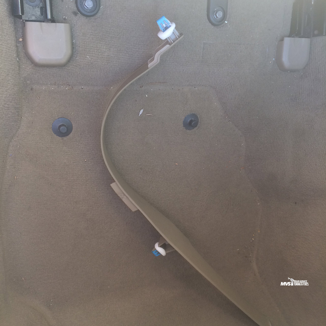

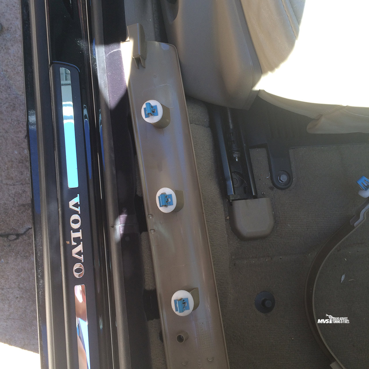

Step 11: Remove right door opening threshold trim by pulling straight up, the part pivots towards the rear of the car, so work front to back
Step 12: Remove front door opening trim by pulling up at the bottom, then towards you from the vertical part, finally sliding the part off the catch at the top

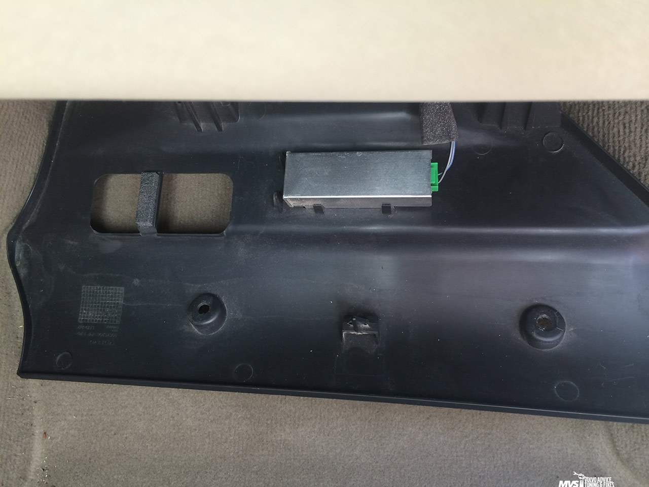

Step 15: Remove soundproofing (two T20 torx screws)

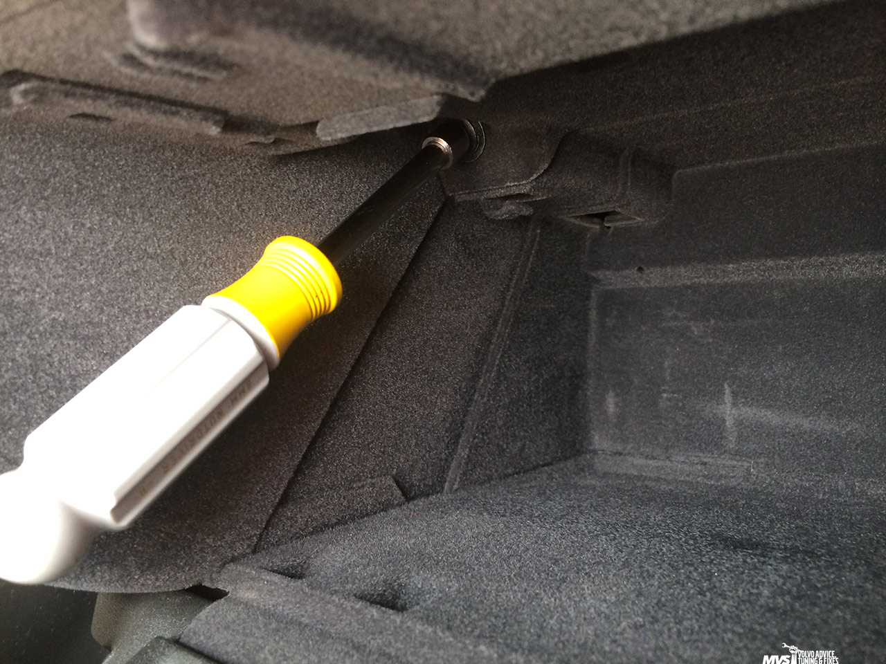

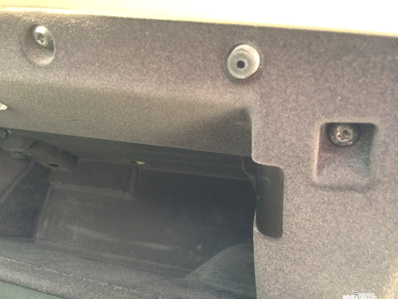

Step 16: Remove glove box fasteners (two 8mm bolts and four T20 torx screws inside; two 8mm bolts and two T20 torx screws underneath door)

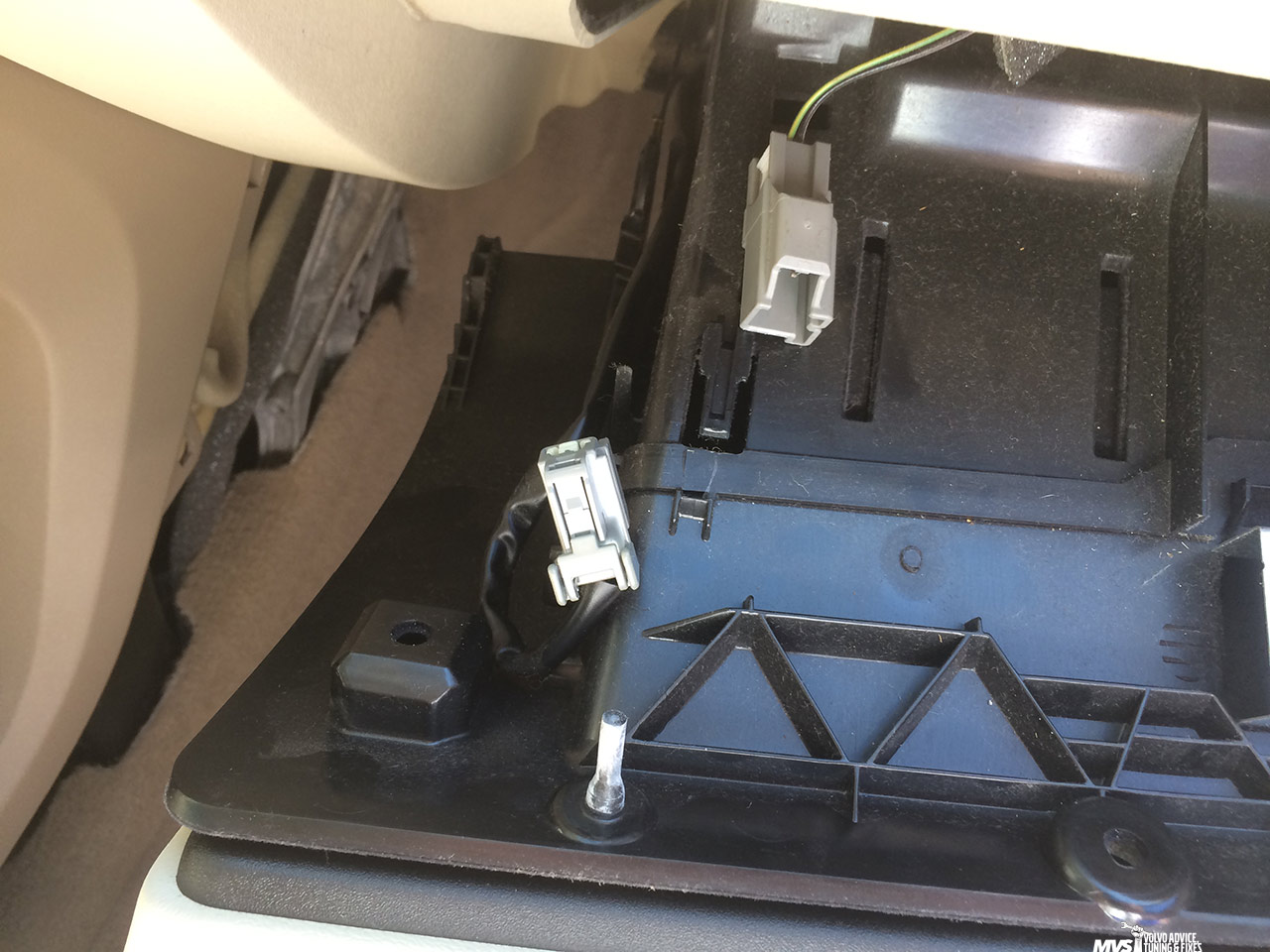

Step 17: Disconnect glove box light electrical connection at rear (green connector)
Step 18 [may not be required, depending on model year]: Remove glove box light by prying downwards, disconnecting the leads
Step 19: Pull glovebox out, if resistance found, stop, crawl underneath and locate electrical harness zip-tied to right corner of glovebox and (blind), cut zip tie, then continue to pull glove box out until a grey electrical connector is found (valet lock), unplug and deroute wire feeding it by pulling forward on the female socket to disengage it from its mounting point.
