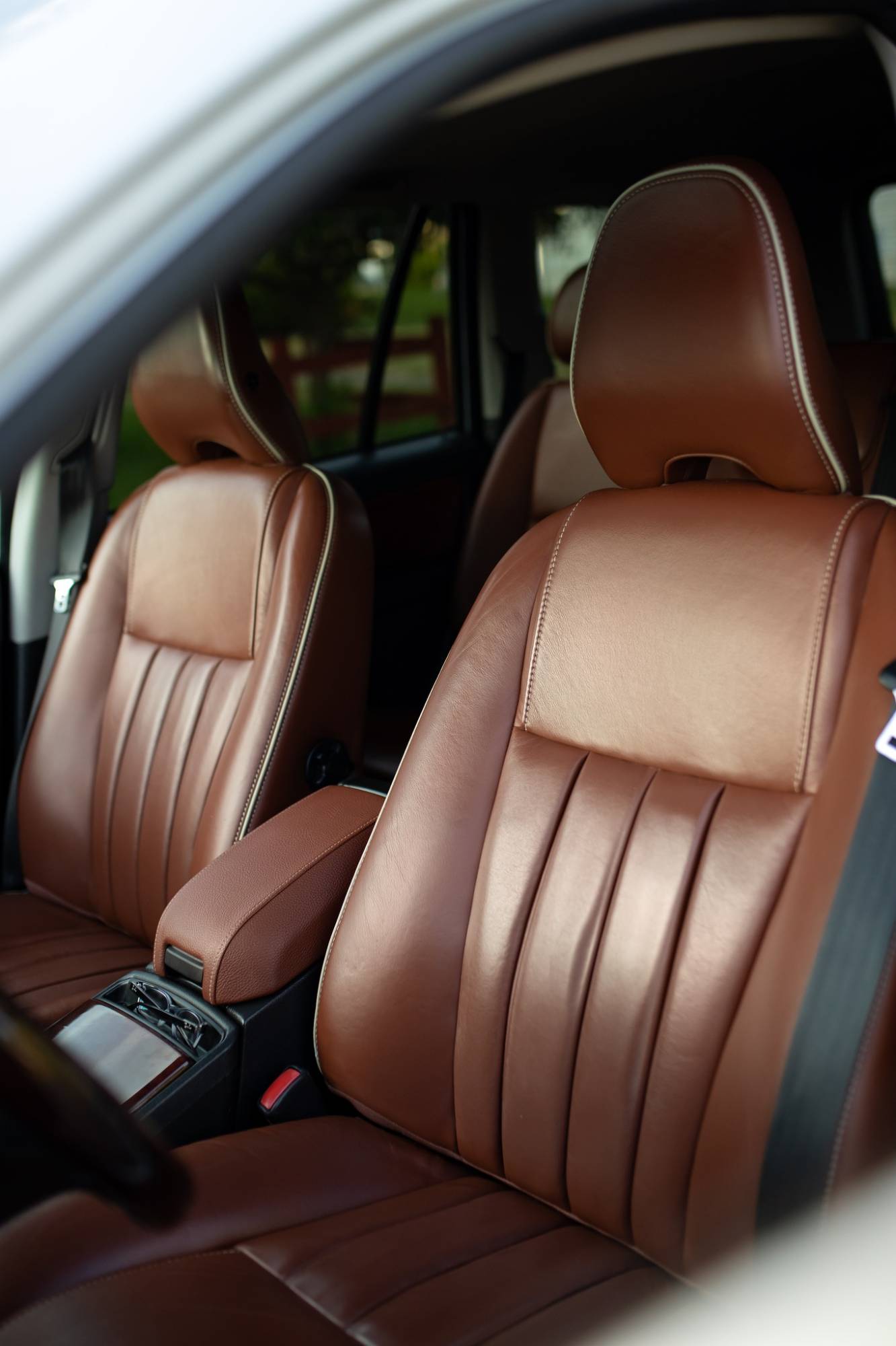

Love the interior color! Never seen that color combo before. Maybe it's the speakers rattling and not the door panels? When they get blown out from too much bass that can happen. Not sure what's going on with the door panel clips, maybe someone more knowledgable will have a suggestion. I would not hesitate to use a battery from any auto parts store, Walmart, etc. As long as the cold cranking amps are close to OE you should be good. After all, Volvo does not manufacture their own batteries...

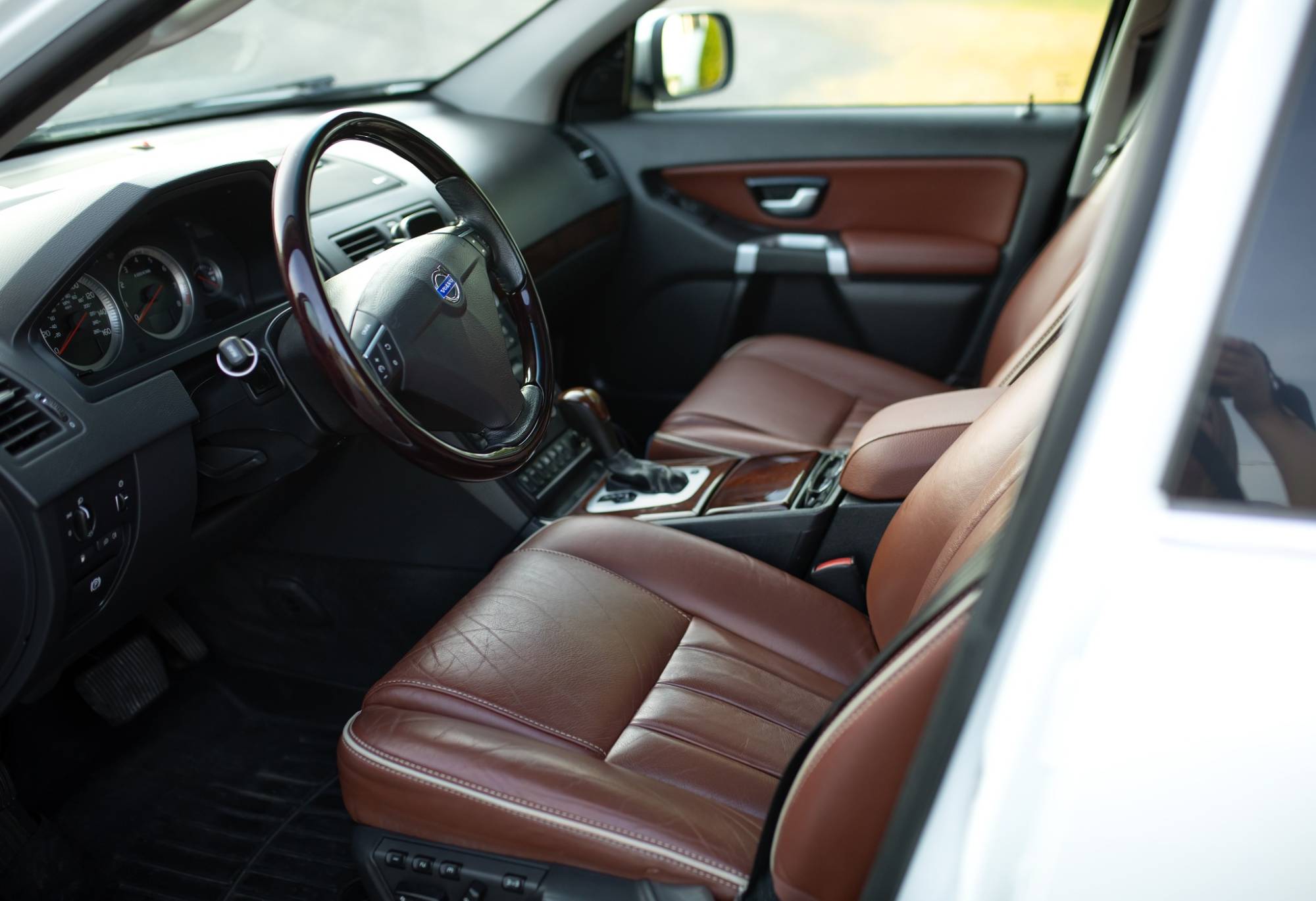

Appreciate the comments. Speaker definitely isn't the problem. If I put pressure on the door panels near the handles, the rattling stops. It's various places in the two front doors that have the rattles that I can get to stop by putting pressure on different spots of the panel. Unfortunately, I've watched every XC90 door panel video I could find, and none of them were of any additional help

Beautiful interior!!!
Definitely upgrade to the H8 larger battery. The hold-down has two slots so you can use the larger one. Many of us use an AGM H8 battery with good results.
The door panels/cards can be a pain to remove. The handle cover is the hardest part to do without cracking any of the plastic. Different years have slight variations to the handle cover. Remove it on a warm day so the plastic is more flexible (as much as it could be) use plastic trim tools and search how to remove it on YouTube. There is a Torx screw under the handle that is probably holding the panel on.
With the door rattle, I had some when I upgraded a pair of speakers and my amp (used the factory upgraded Dynaudio amp). The first things to check are loose speakers and the speaker grills since they are just press-formed and inserted into the panel. If the previous owners and passengers were kicking the door open, this would dent the grills. You can then go through the back of the panel and see where to add foam on the surface, as well as in between panel sections.
While in there, add some sound deadening material to the doors to help reduce road & wind noise. I used to do monthly 1500-mile round trip drives and in the 11hr one-way routes, a small noise could get annoying. The sound deadening and foam on the door panel helped reduce the road & wind noise where I could lower the stereo volume level a couple of notches. This helped reduce ear fatigue.

Regarding the door panel, I do have the "two piece" handle variation. Surprisingly, the silver trim piece is the least of my worries! That came off with no problem. But I still cannot get the upper clip to come loose, the one just below the tweeter/BLIS indicator. We keep the car in a detached garage with no insulation, and it's crazy hot/humid here right now. Garage is currently 95F and the car has been in there all night/day. Still, that freaking clip will not budge out of it's spot.. I may try to see about cutting it off and ordering a new clip. Not really sure what else I can do without breaking the panel (more..).
The plan to fix the rattles was exactly as you stated. Putting additional adhesive padding in the doors. I can tell you that it's absolutely the pieces clipped to the panel internally that are rattling, and the panel itself hitting the door. Speaker grill and entire door panels are in immaculate condition. Not even a single scratch on any of the 4. Only items loose externally on the panels is the window switches. Those rattle like crazy from the bass as well.
I was able to fix the rear seat by loading the rails with "red and tacky" grease that I have. I've had the same tube of it for 15 years and it's always fixed noises for me! XD I guess I just didn't put enough on the first time. I filled both sides of the rail this time and slid the seat forward/back a bunch. Old grease seemed to be dirty was all. Will do this to all the seats once it cools off here to avoid future issues.
