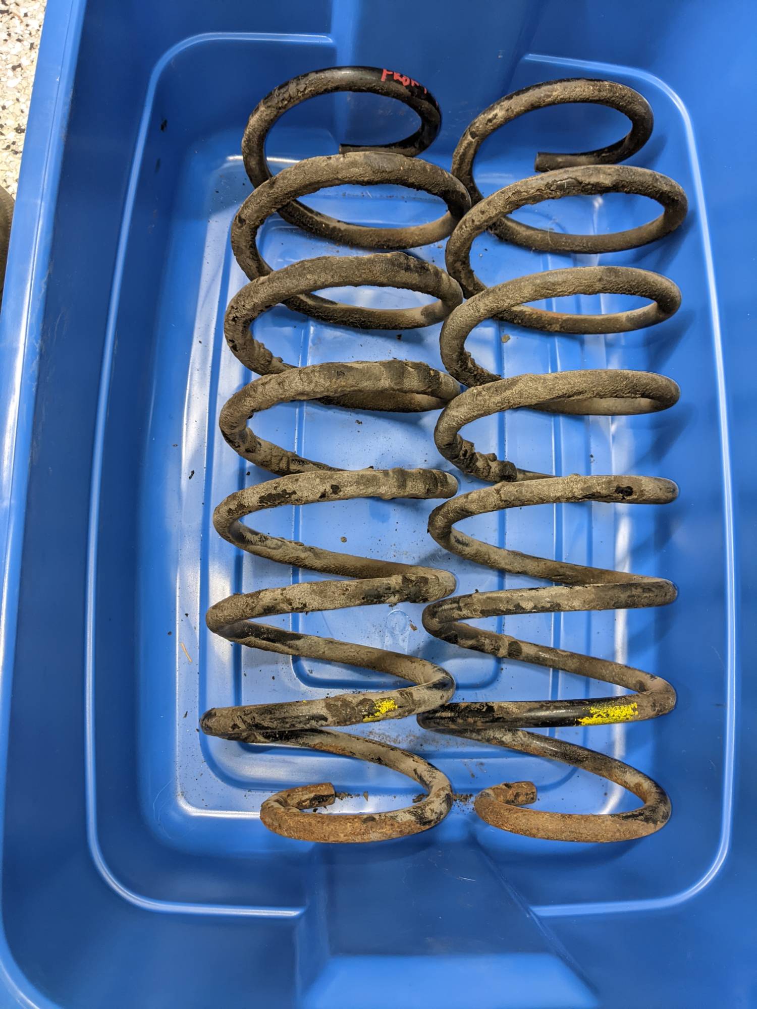

Yellow market P80 front springs (1)

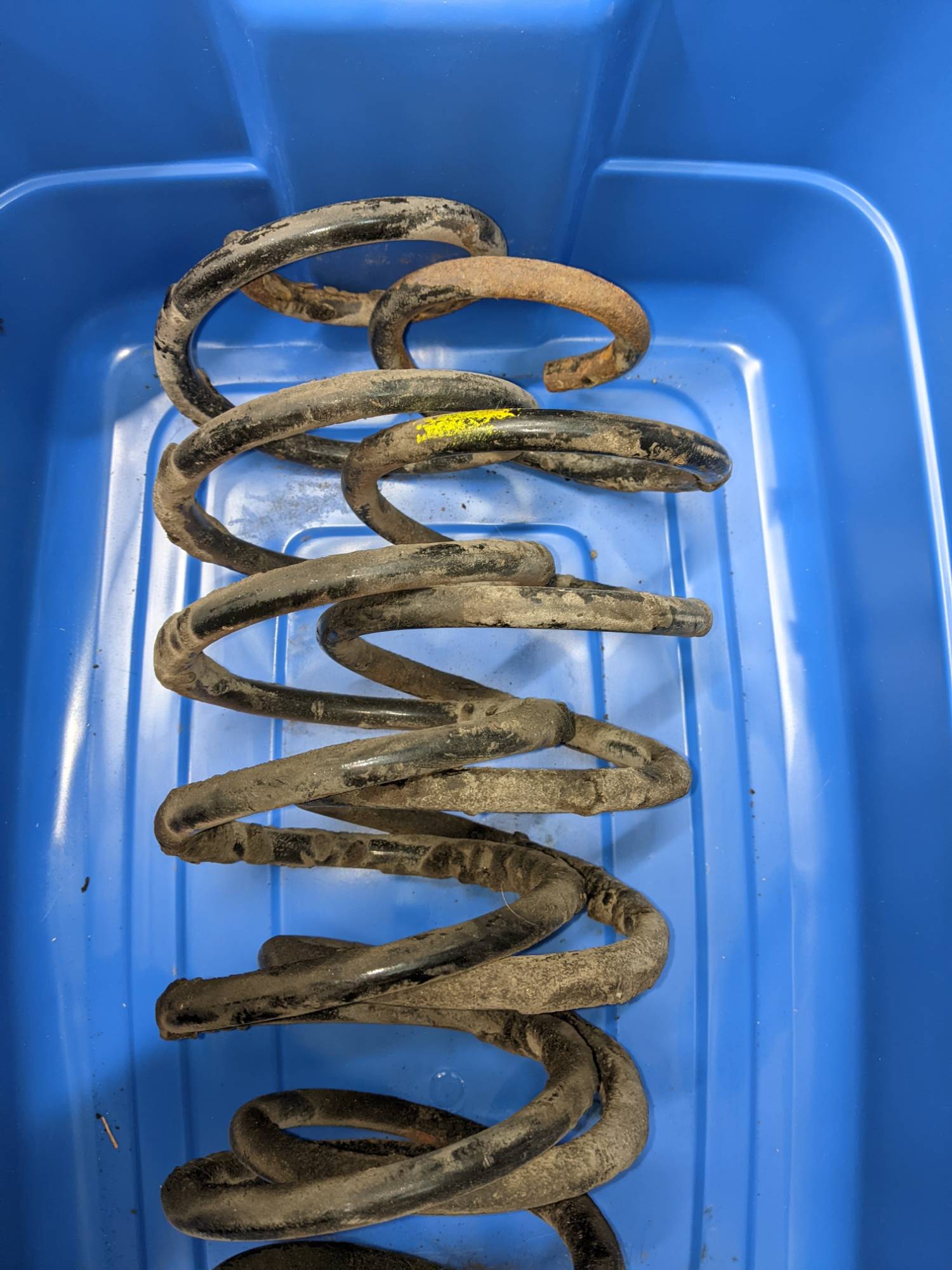

Yellow paint marks
Yellow paint marks

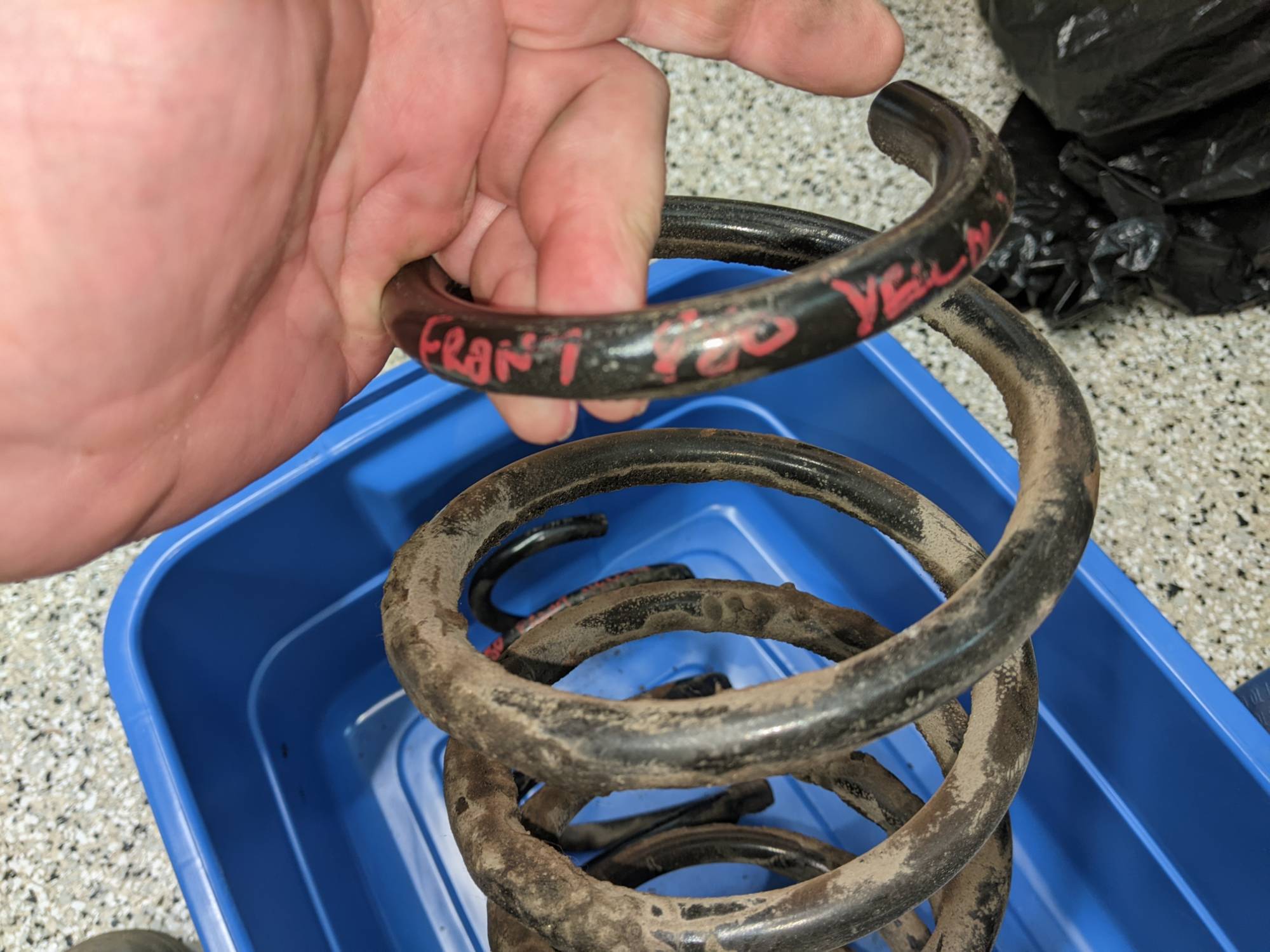

Junkyard marking?
Junkyard marking?
Yellow marked P80 front springs (2)
These are as I got them. I have not cleaned then as they have a fairly thick overspray with undercoat over maybe 50% of them. Rust is confined to lower coil which is surface.
