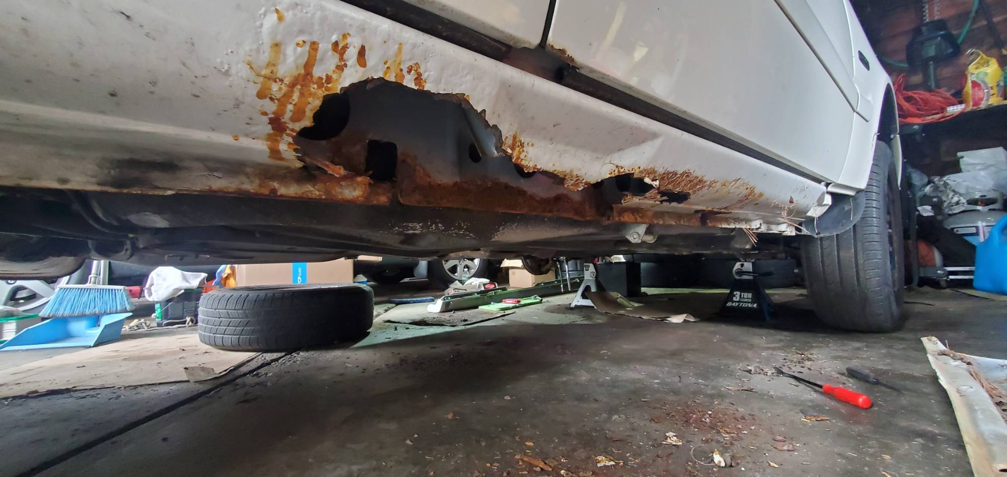

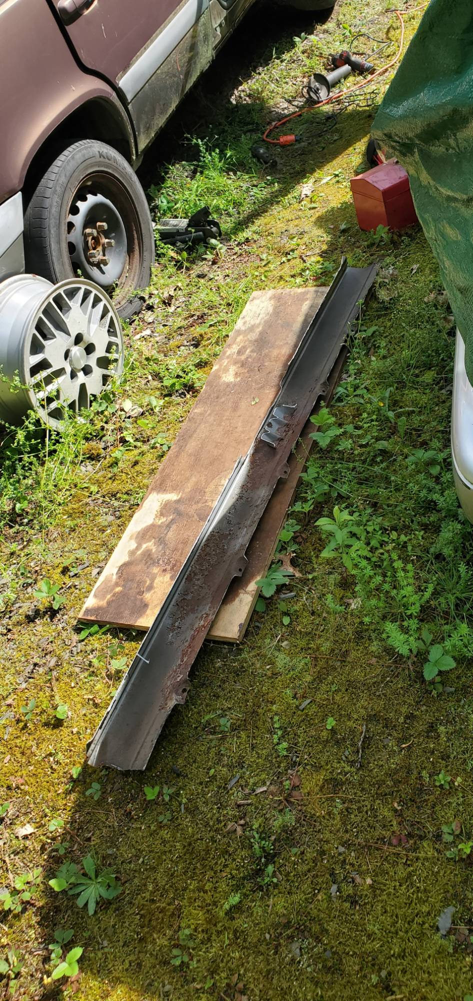

FireFox31 wrote: 08 Jul 2023, 00:04 Could someone post a picture of the area to check? What are the rocker panels and what must come off to check them for rust.
Because if any car has rust, it's my poor neglected Geronimo. I want to know now before installing the $2000 in parts I've recently purchased for it.
There's the light rust on the inside of a panel.
That's what it will turn into if left unwashed, with built up leaves and dirt behind the plastic cover, and possibly some mice living in there.
To give it a quick check, look at the back side of the pinch weld for any rust, and if there is some, see how weak the metal is, if might be flaky and just crumble in your hands.
To really check though, you need to punch out the center core of all the plastic push pins along the lower outer edge of the rocker cover, and then pry the whole push pin out. I had to use a metal trim clip tool, the plastic ones just bent.
If you have the older style 850 plastic covers, you need to open the doors and pop out the little access covers you see on top to get at the clips.
If you don't have the access plates, you just insert a trim tool under the top edge and slide it down with light upward pressure, it doesn't take much to get the top clips out, and then with the doors open you should be able to wiggle the cover right off. Any paint bubbles probably mean there's rust there from the inside out.
While you're at it, take the rear wheels off and take the fender liners out, just pop it off those three studs in the back first and it should slide right out, there's clips along the outside edge of the wheel well that keep it in place. Putting it back on you just put the clips in first and then push it over the studs.
And take the time to look up into the rear shock towers and rear bumper mounting area.

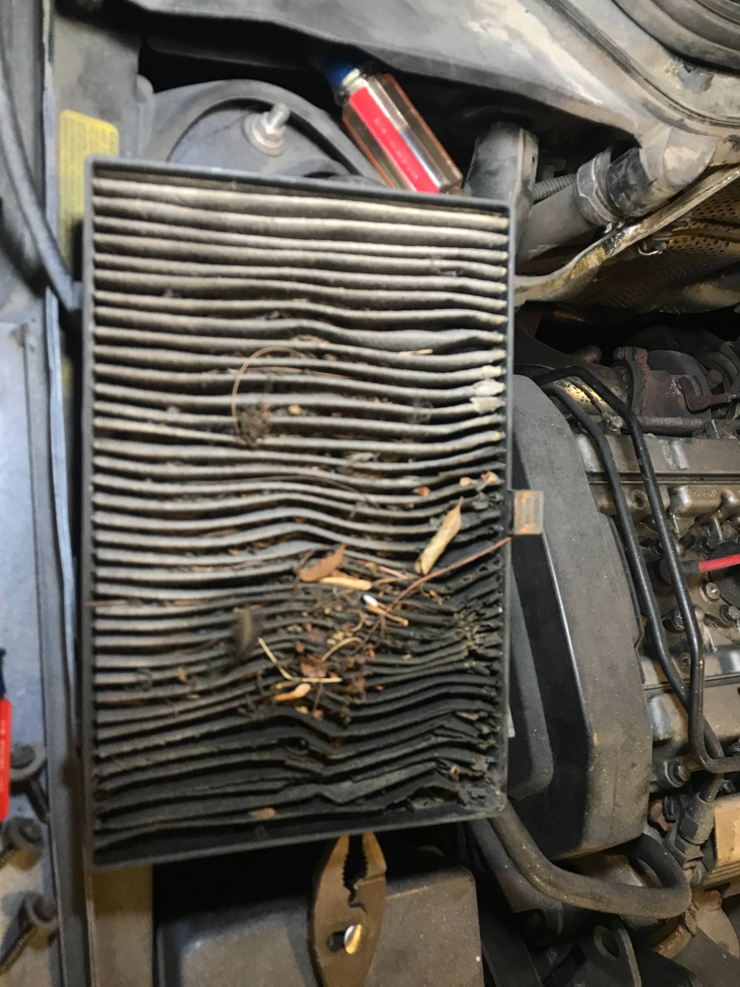

Take a hard look at the cabin air filter, and if you peer down into the hole and see any gack, think about pulling the blower motor as well to clean the evaporator fins. Robert may have a video, but it may be embedded in some other business.
