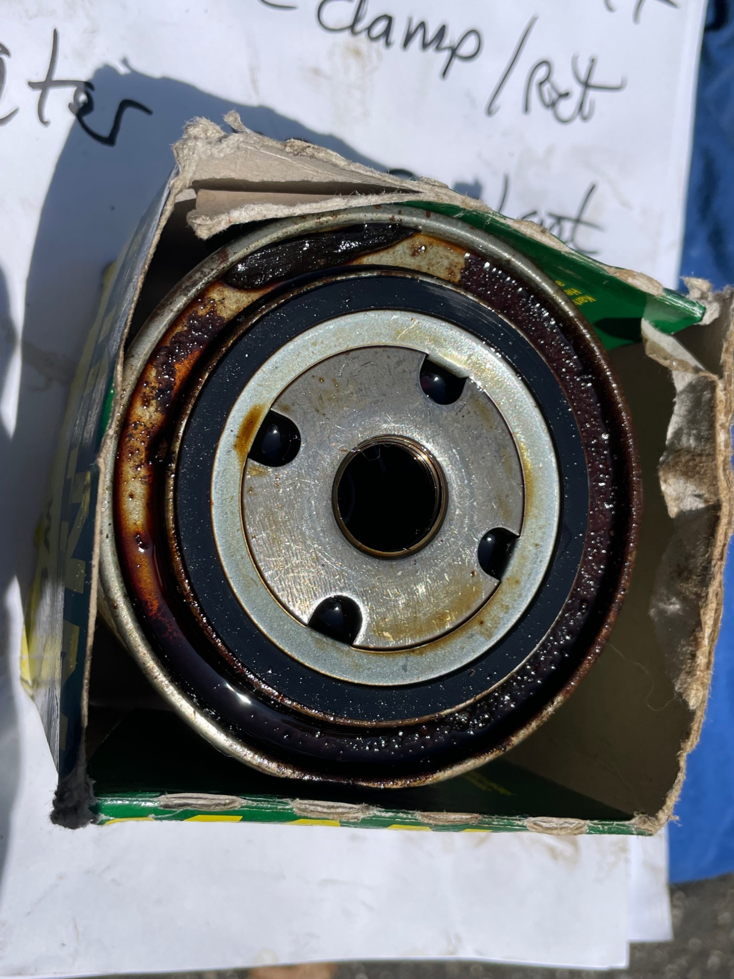

I’ve blown out two of the metal oil filters on P80s from rust out on the top
Shaggs was 12-24 months (?) old and looked nasty
Take home message. In wet climates these need annual replacement regardless of mileage

Again as suggested to someone else regarding rust on our cars, once you have fitted the metal can, spray it with lanolin wax up around the top of it with one of those red long nozzles. It may reduce this issue and also prevent water and salt gathering up there in the first place.

I can't pierce them cleanly with a screwdriver to drain them though, the metal is too thick.
