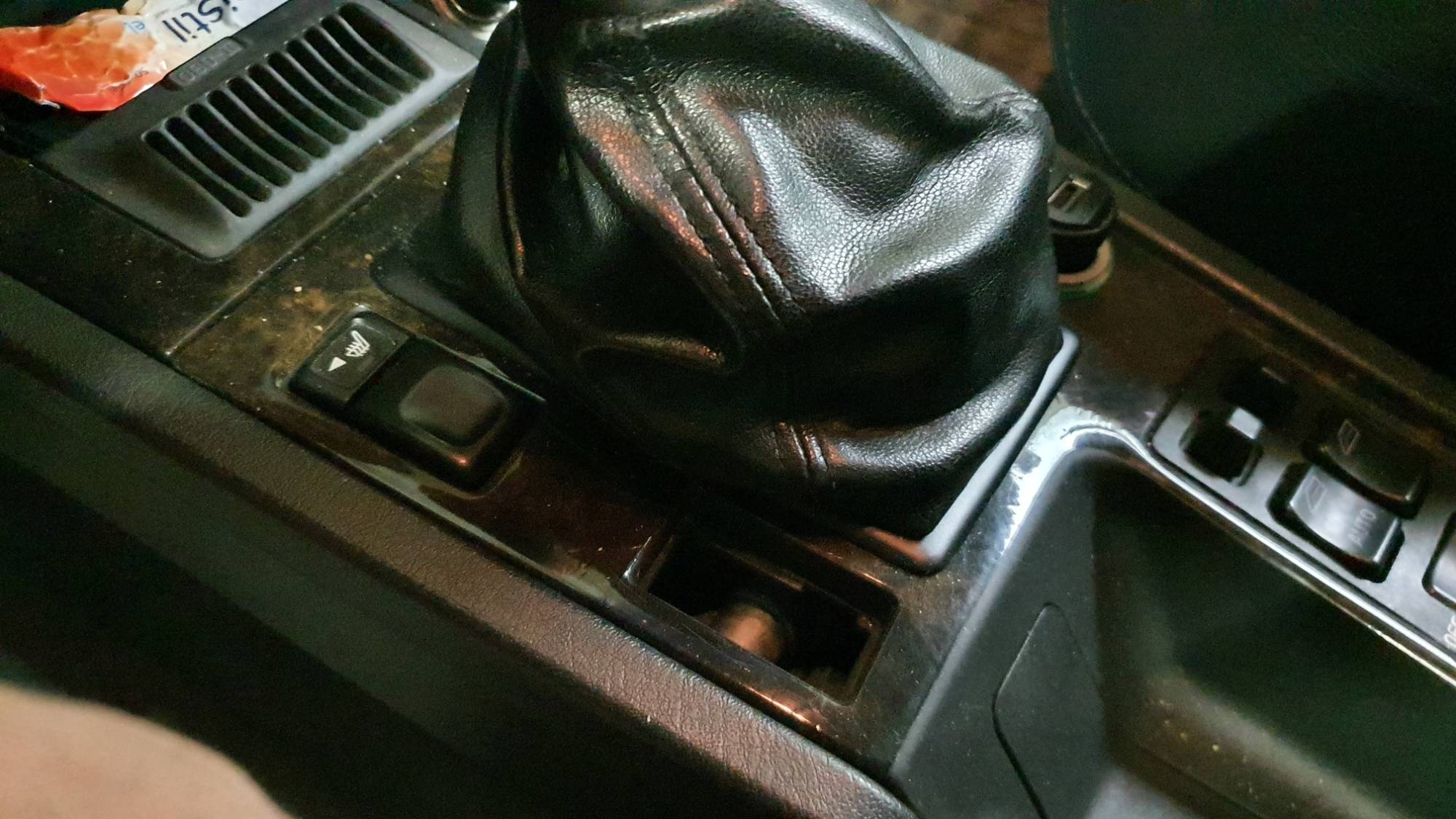

This worked well for me:
https://www.thingiverse.com/thing:4495942
It pops into the original console from the top. You have to trim is a bit on the inside to make the boot fit correctly.

- Clemens
- Posts: 1932
- Joined: 3 September 2015
- Location: Austria
- Has thanked: 473 times
- Been thanked: 219 times
This is how it looks.
I still need to grind off the bottom part of the Econ/Sport switch, hence the hole.
