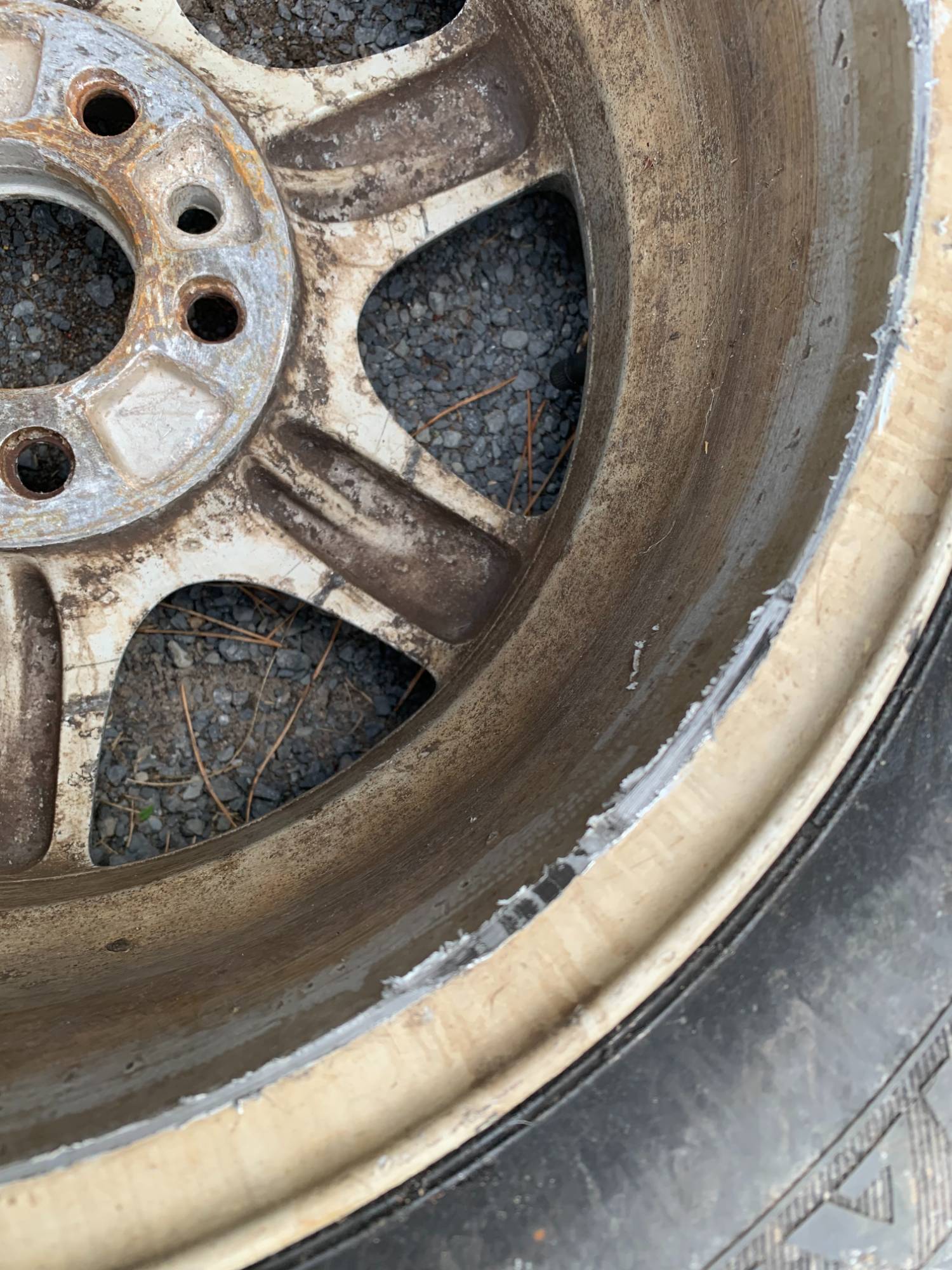

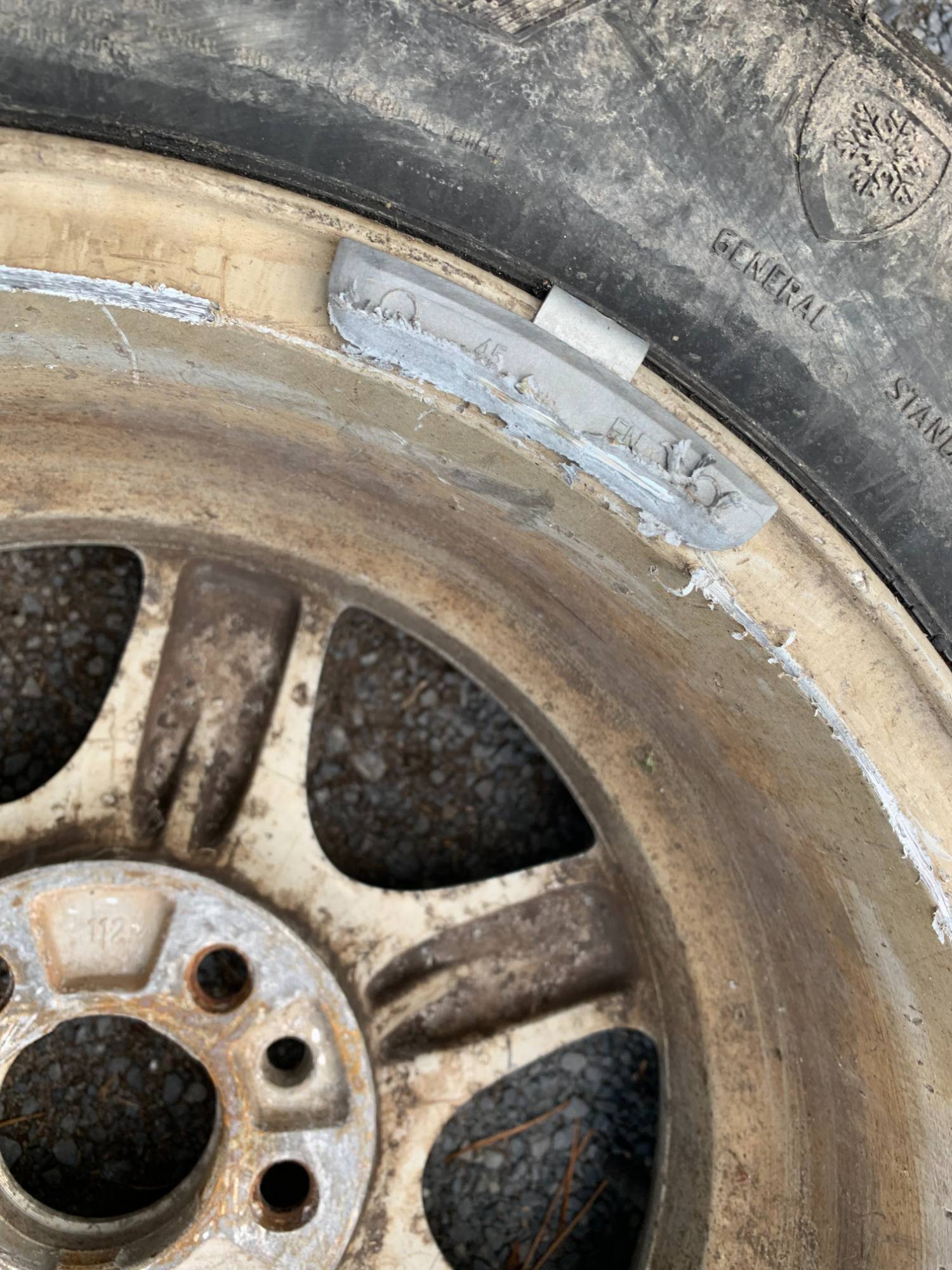

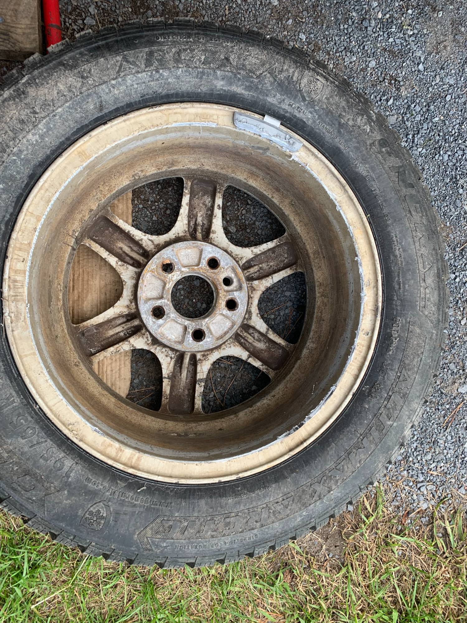

Ok, here are some pictures of the inside of drivers side rim:
On the outer tie rod, marking from rubbing against the rim:
On the strut bolt to spindle/knuckle, note the gray colored residue/flakes (between the bolt head/nut and top of spindle):

The inside of the front passenger side rim shows no scarring at all.
