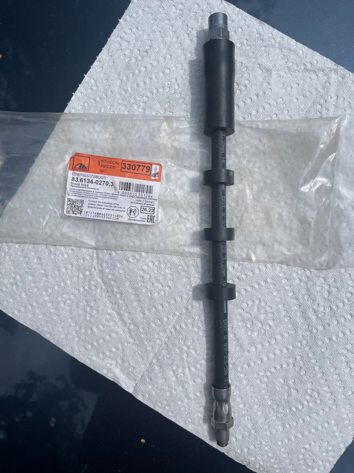

Couple of car goofs this weekend

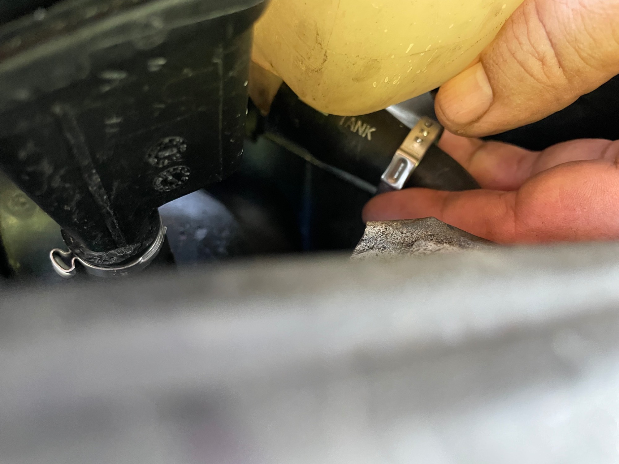

I forgot to clamp off the the hose on the coolant reservoir which eventually popped off and dumped the bottle. No over heat so I just stuck it back and drive 3 miles home, after a two hour run to JFK the day before
Oetikers apparently require some kind of clamping. Killed the level sensor struggling with the bottle though. FCP, baby

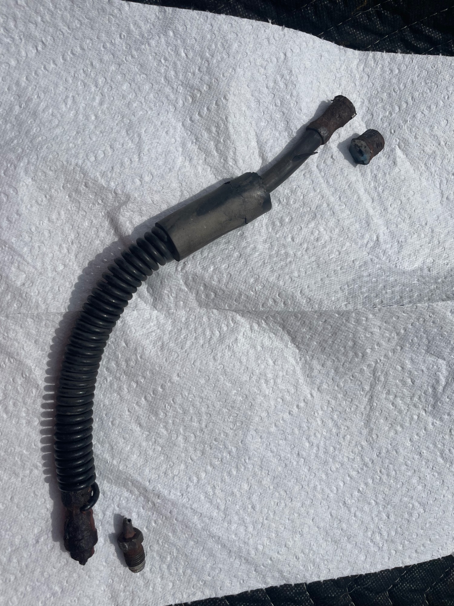

Replaced a rear soft brake line on the Kat
Out with the old, in with the new….nice ATE replacement , new design

Post by bmdubya1198 »
Whoops... those oetiker clamps work much better when clamped!
