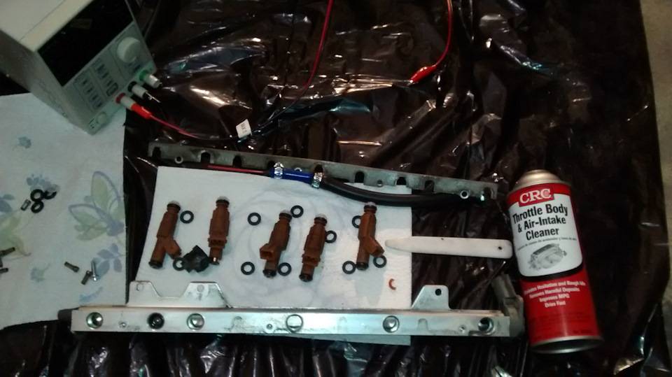

I saw you replaced the plugs and coils. Have you replaced or refurbished the fuel injectors? Bosch makes them and they last pretty long. My '07 XC70 is approaching 190k miles and still has the original injectors. I cleaned and refurbished them with kits twice. After removing the O-rings, filter, and pintle cap I let them soak in a glass of seafoam for 24 hours. First refurbishment was at 121k miles. Second I did last summer at 183k miles. The materials that came with the kit still looked fine 62k miles down the road.

Any cleaner in can, piece of hose, source of 12V (add a bulb to circuit if running off a battery), wires.
