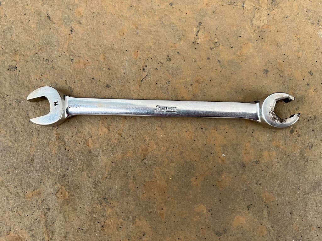

Prepping yesterday for today's job of giving the V70 a brake fluid change, I have no paperwork of it ever being done before and if it really is 18 years old it's long overdue. Today's job was to try and loosen the bleed screws which I really wasn't looking forward to. The plan was to soak all the nipples with PlusGas overnight in the hope they would come out without breaking. However I was a tad impatient and with both rear wheels removed and the bleed screws soaked them in Plus Gas I decided to start by lightly tapping the surrounding area with a small hammer, first one side, then the other, more PlusGas and more tapping and repeat. I then dug out my vintage Snap-On RXSM-11 flare nut spanner which I've had for over 45 years and applied some pressure to the bleed nipple. to my surprise they cracked open and I allowed a small amount of fluid seep out. The front was done with the same procedure and all 4 are ready for today if I manage to source the correct but rather scarce DOT4+ fluid.

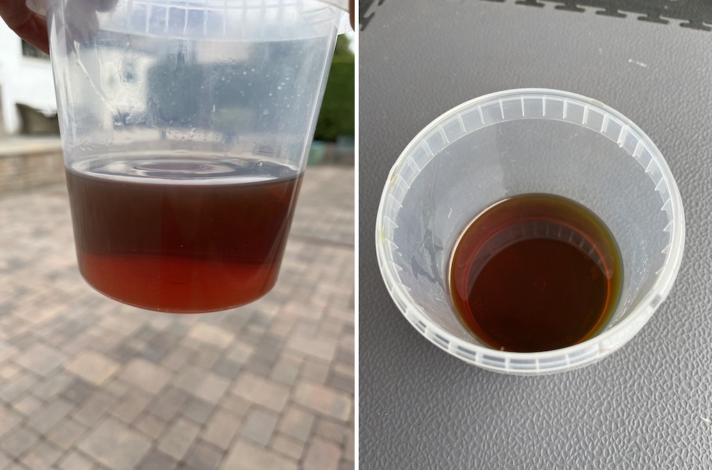

No difference in by brakes now that the fluid has been changed but it will make braking safer without the moisture content of the past 18 years
This is what 18 year old brake fluid looks like?

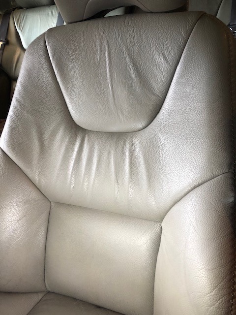

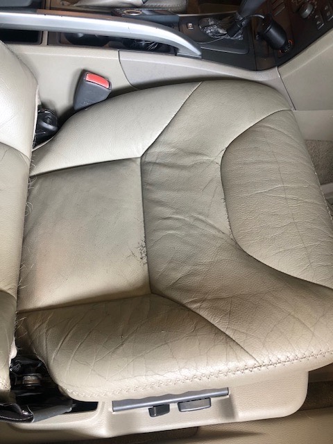

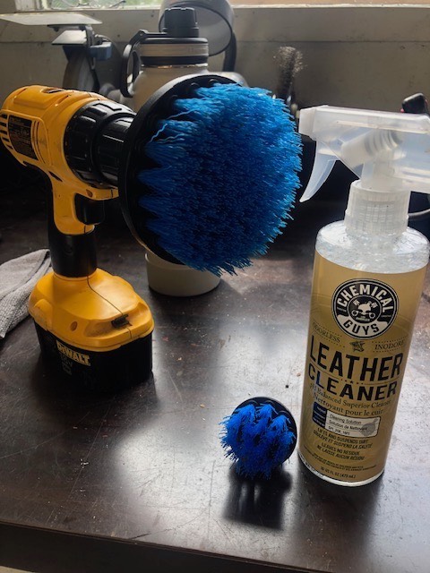

I finally found an effective method of deep cleaning the leather seats. A friend of mine is a professional detailer and recommended a product that actually gets all the grime out of the grains of the leather, I used Chemical Guys Leather Cleaner and a drill brush (soft bristle). The cleaner cost $16 for 500ml, the whole seats front and back used about 1/3 of the bottle and the job took under an hour. I should have taken before AND after pictures but I can assure you that the seats were filthy before as I have 2 Labrador retrievers that are almost always with me in the car, going swimming and trudging around the muck at the dog park. I would highly recommend this product, however I really think the drill brush is also necessary to get the leather looking like new.

Those look really good for 20 year old seats! Good to know now as I could do with tackling the Toyota light beige seats.
P80GLT, I also have a Snap-on flare wrench. One of the best purchases I have made tool wise!
That brake fluid needed changed but seen worse!
