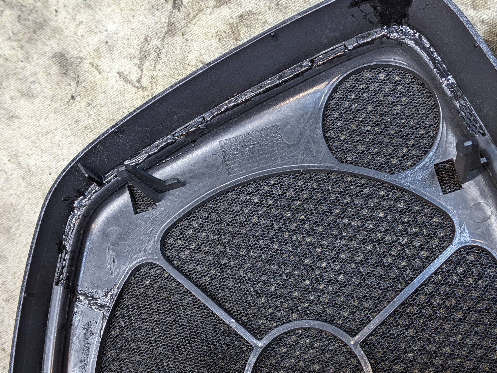

It is a devil! The whole outer section you can see comes off. I started at the back with a plastic 'bone' tool and a blunt flat blade screw driver.
Those pins do come out (or they did in my case), but then I had the whole dash pad off while re-building the lower dash mounts. I did spray some silicon oil on the pins first.
To repair the cracks, I bent the tabs back on the grille and carefully prized it off. I then had to replace the speaker cover foam which had totally disintegrated! I bought some suitable material off Amazon.
For the actual repairs I use JB Weld plastic 2 part epoxy.
