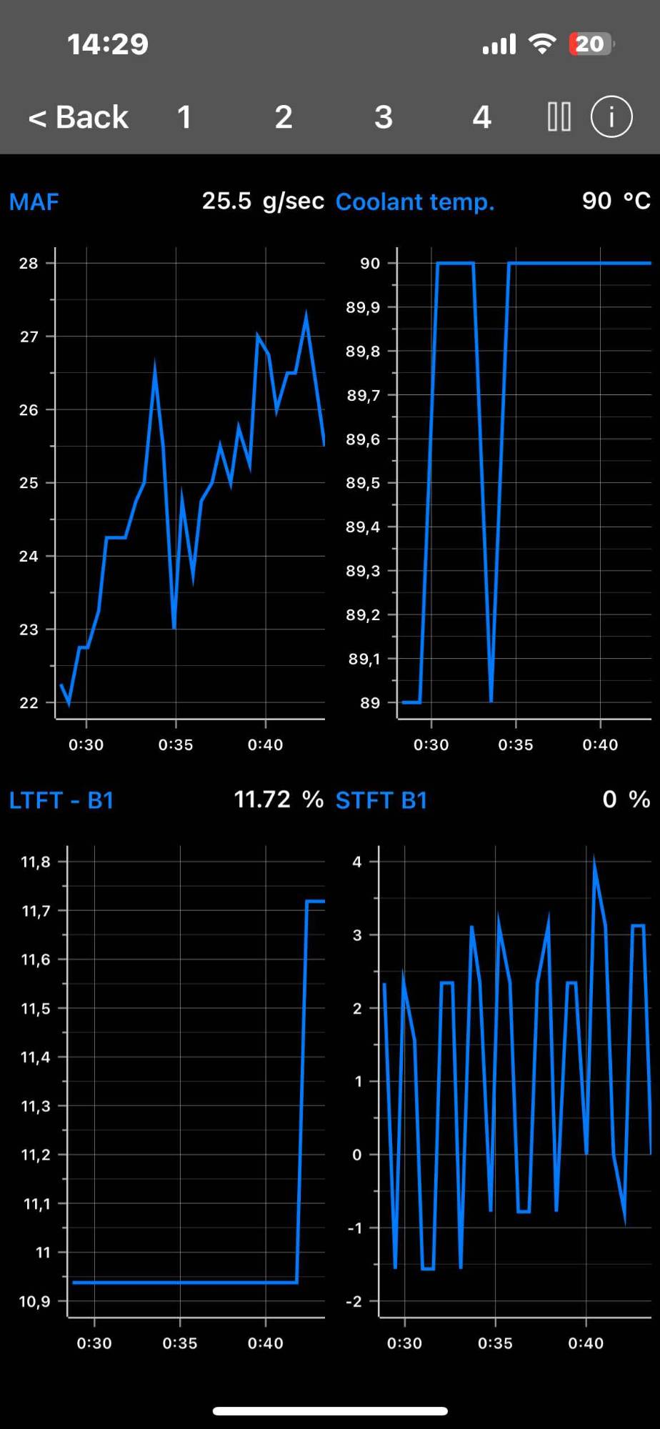

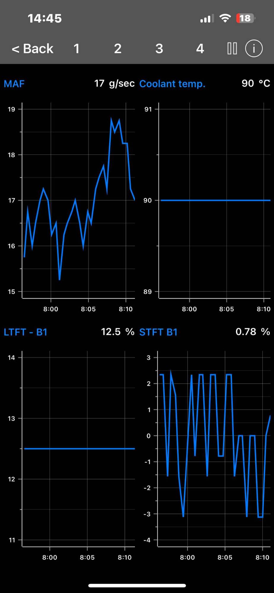

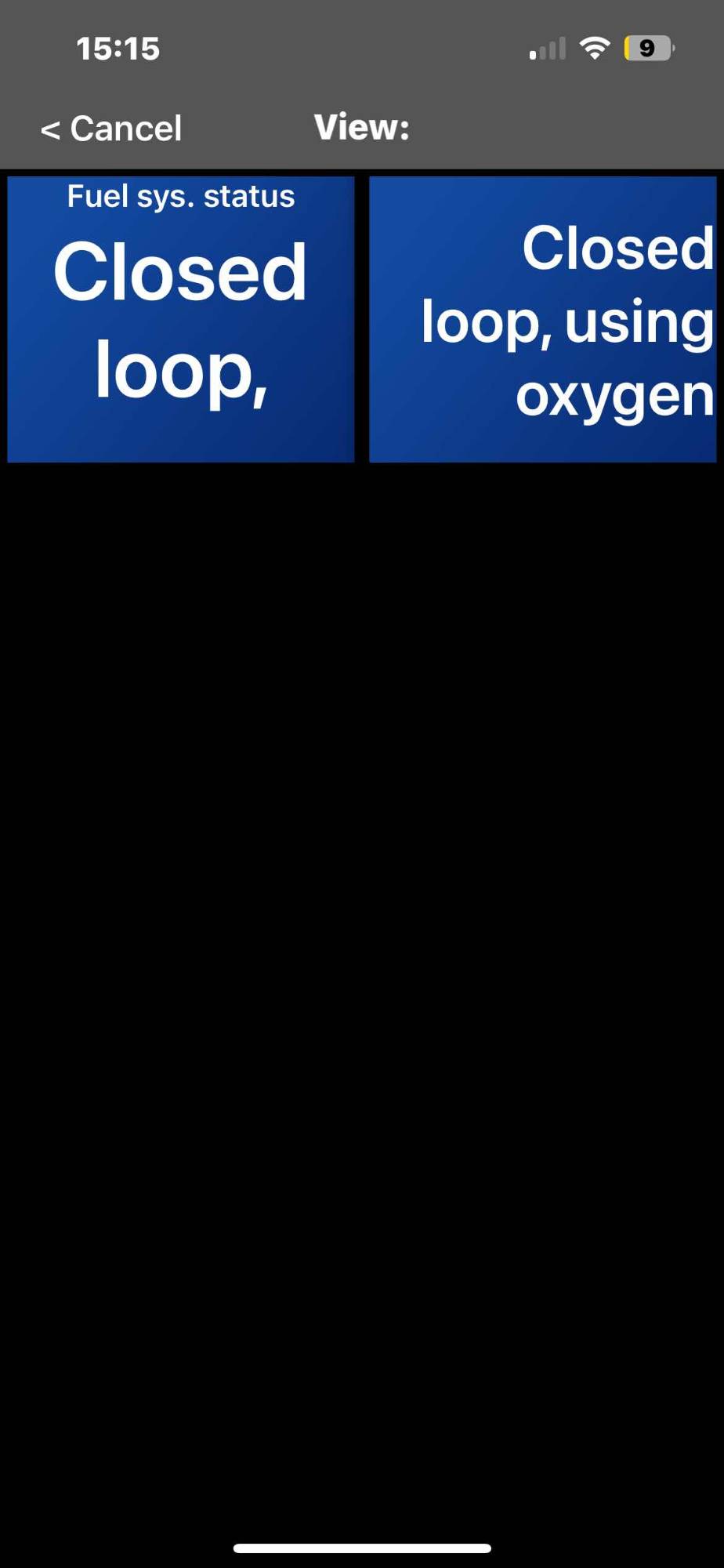

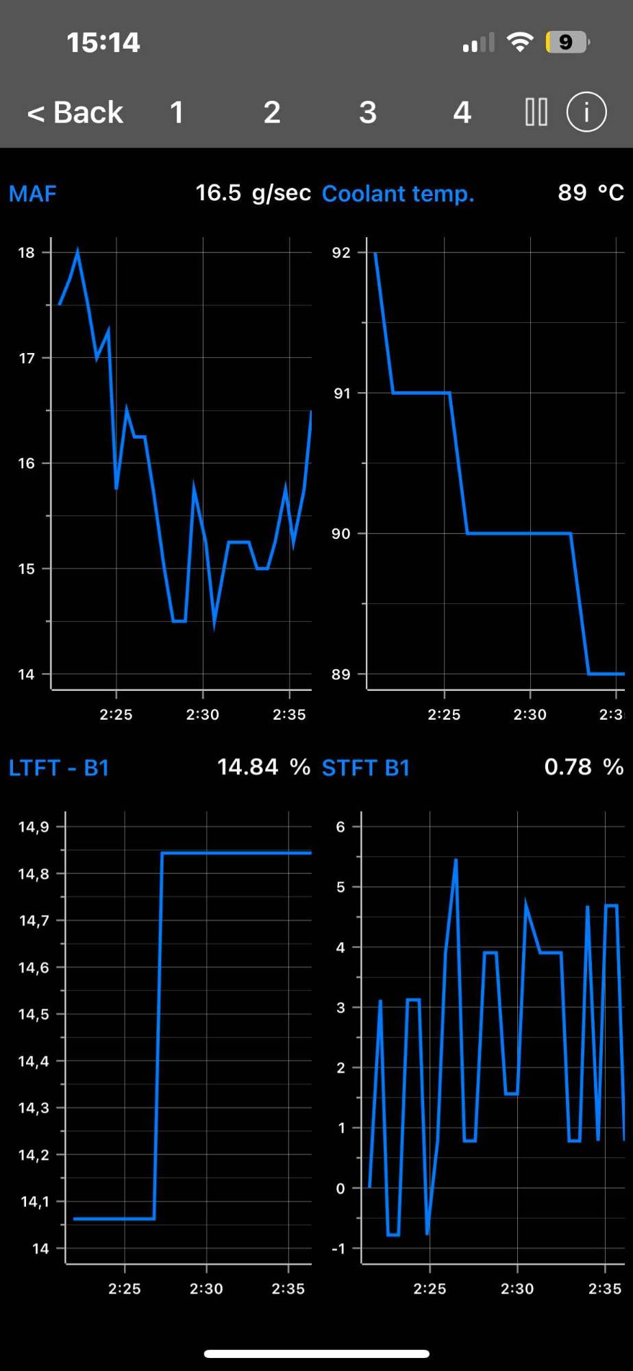

Small update, fabricated my own fresh air intake, With aluminium pipe and silicone hose, Welded nipples for the vac lines and PTC, I smoke tested the vehicle, there is no leaks in any hoses, no smoke coming out, also checked under the engine cover no smoke, when I open the oil cap smoke pours out, so its safe to say its not leaking? However, im still getting large Long term fuel trims around 11-12.5%! And Short term fuel trims at 4 to -4 % is this normalt for a tuned car? Or where should I start looking now? Will update pictures of the OBD TRIMS when I get home, as well as with MAF and coolant temps.
