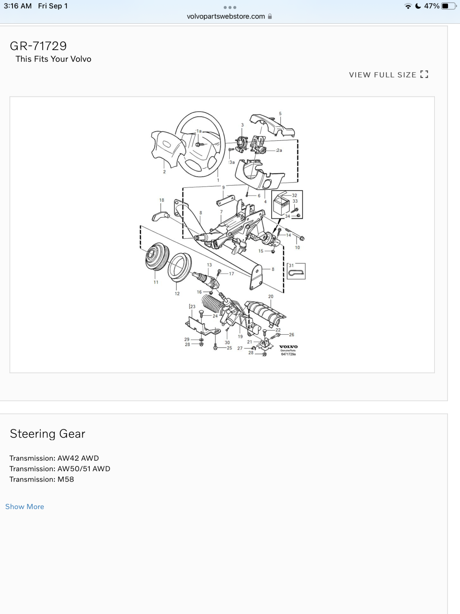

Part 986196 on this diagram, #6

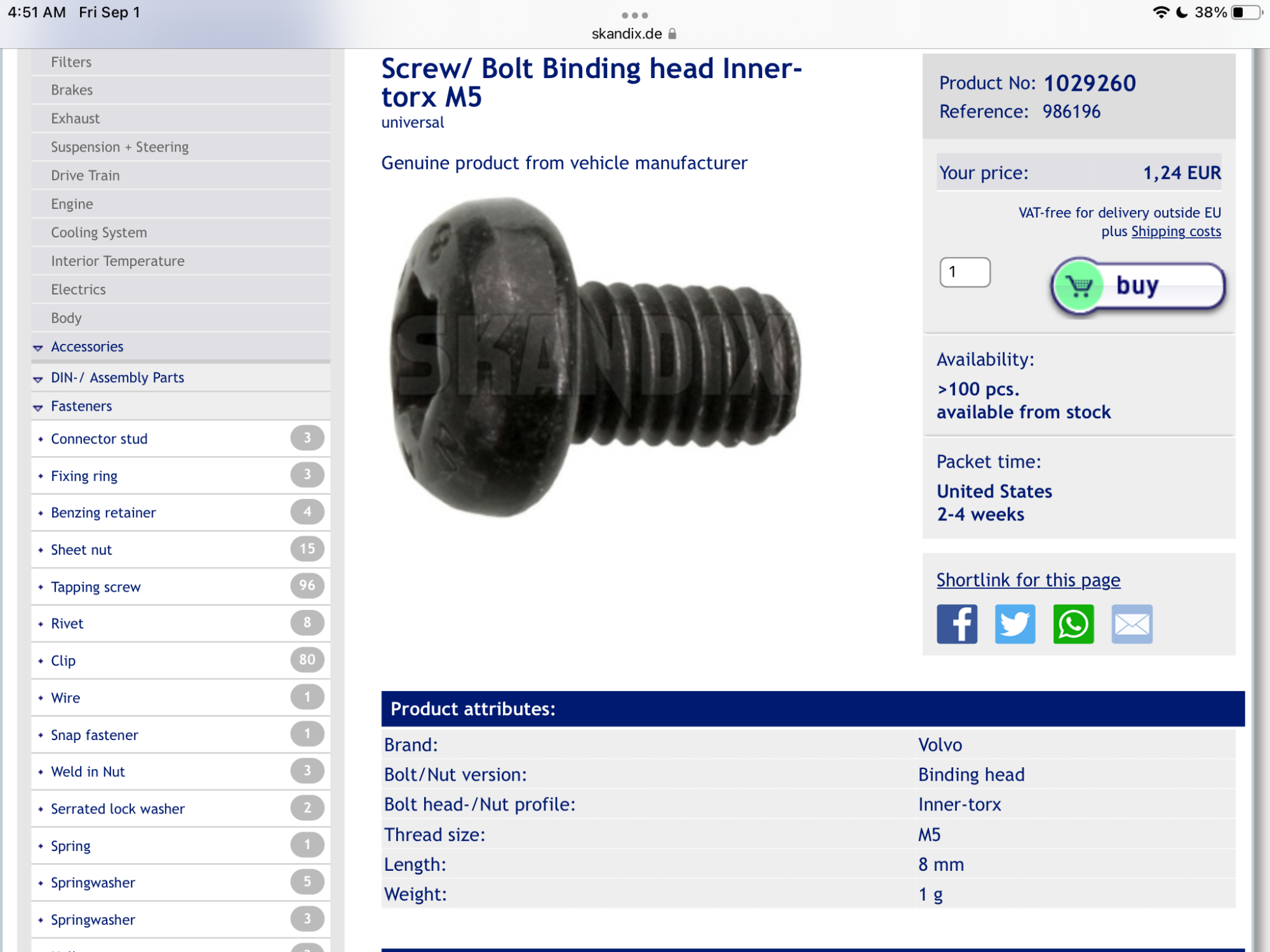

You need four them, three to put in one more to put iwhen you drop one under the front seat full of cheese fish
This is a notoriously hard bolt to find in the Volvo webstore , it hides under the whole steering column assembly, not in trim or body stuff
It’s a odd ball M5 binding head. Torx screw, 8mm thread length , per Skandix
