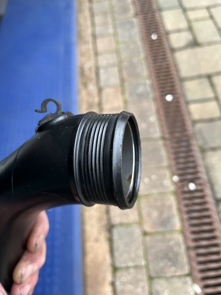

I understand this is a somewhat common problem as our P2's age, as the picture illustrates the metal sleeve falls out of the intercooler pipe down into the rubber coupling. As the plastic pipe gets heat cycles the hose clamp deforms the pipe while the vigilant owner continues to tighten the hose clamp, further deforming the pipe in absence of the sleeve. Eventually, as in my case, the hose blows off the pipe. I was able to harness a good used pipe from the wreckers and new hoses from FCP. The new pipe is $89.99 at FCP and is Genuine Volvo. It might not be a bad idea to check your intercooler pipe if you haven't looked at it in awhile.
Pipe 1.jpg (62.94 KiB) Viewed 964 times
If its not obvious, the metal sleeve should be down in the pipe about an inch and a half.

Gently heat the plastic pipe with a hot air gun and press the metal insert back into place
