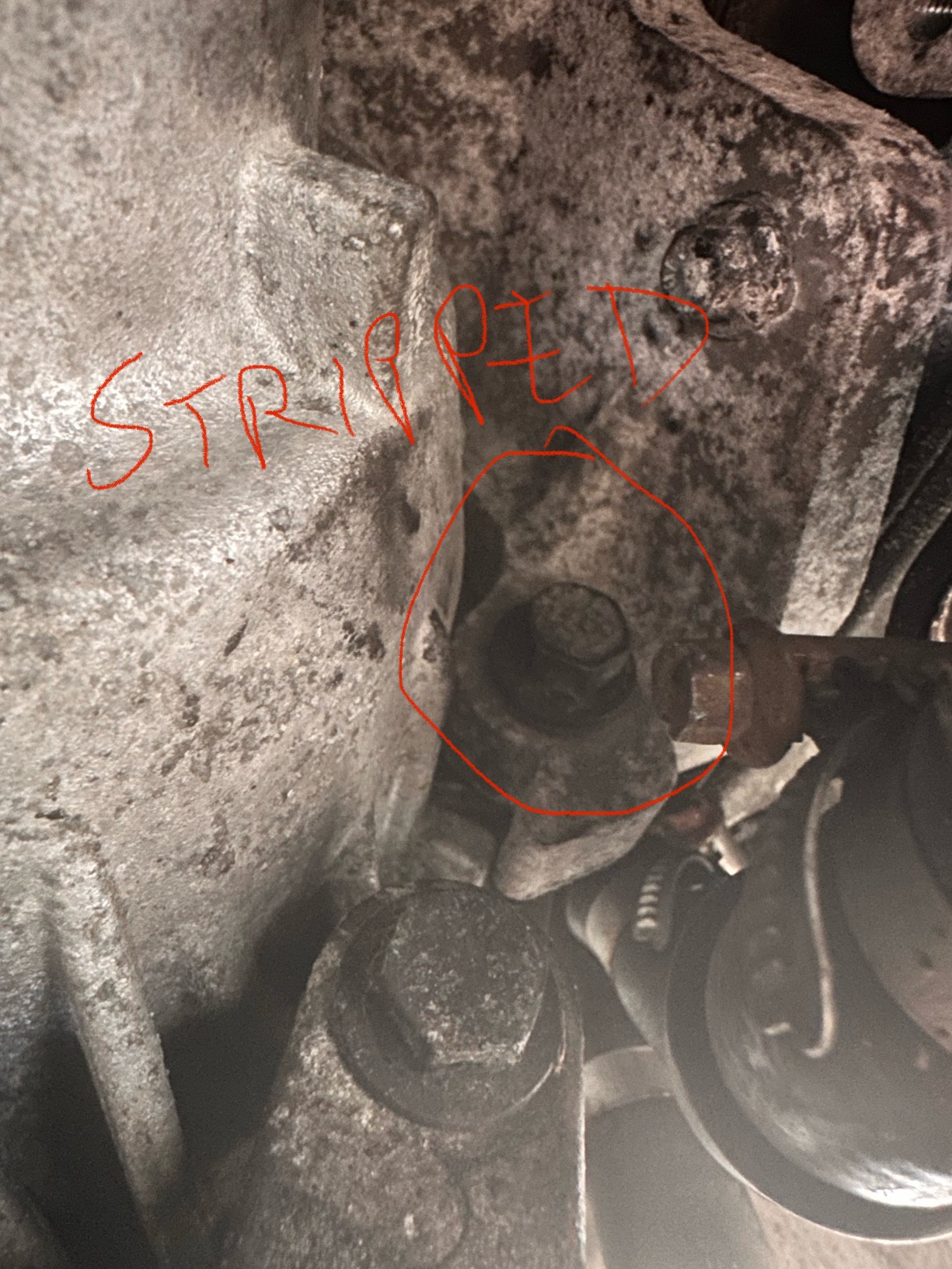

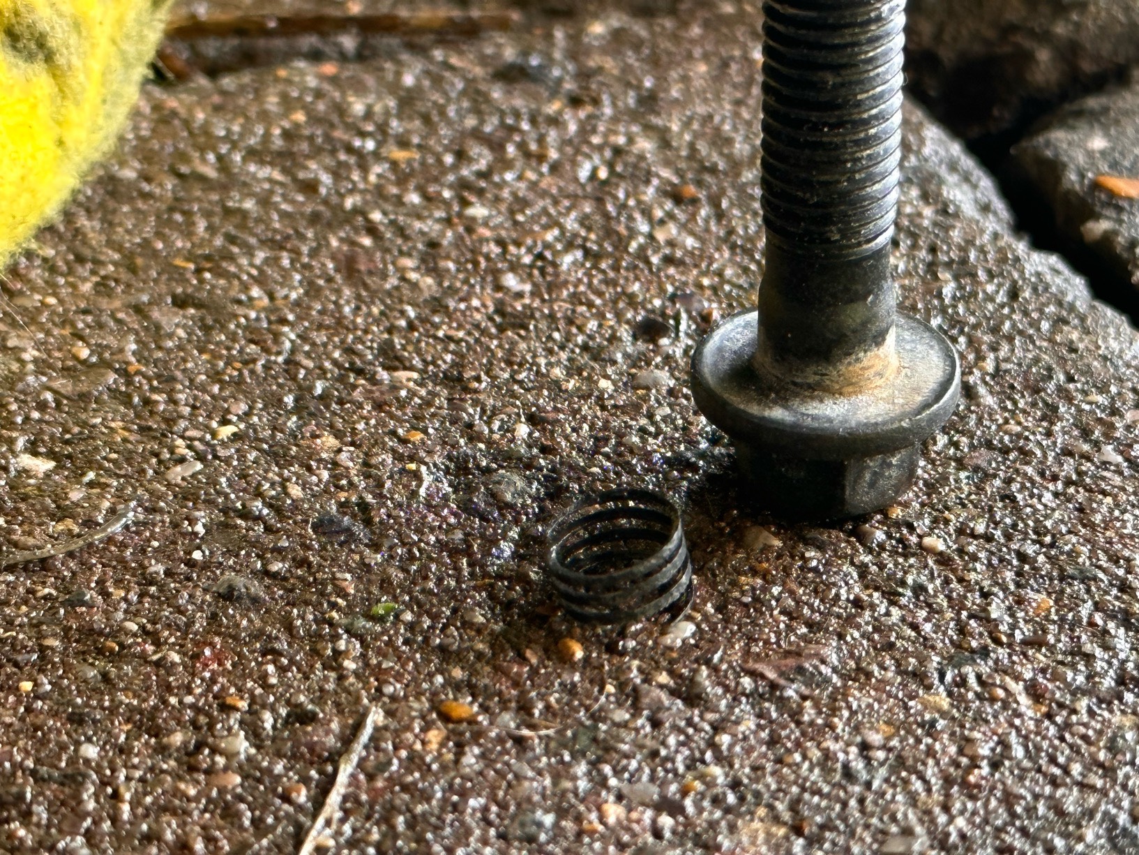

However it seems like a complete idiot has been working on this car. The drivers side driveshaft has a bolt overtightened, that has stripped the threads. Others seem pretty close to being stripped. and theres a leak from the front of the transmission , but i cant see where its from.

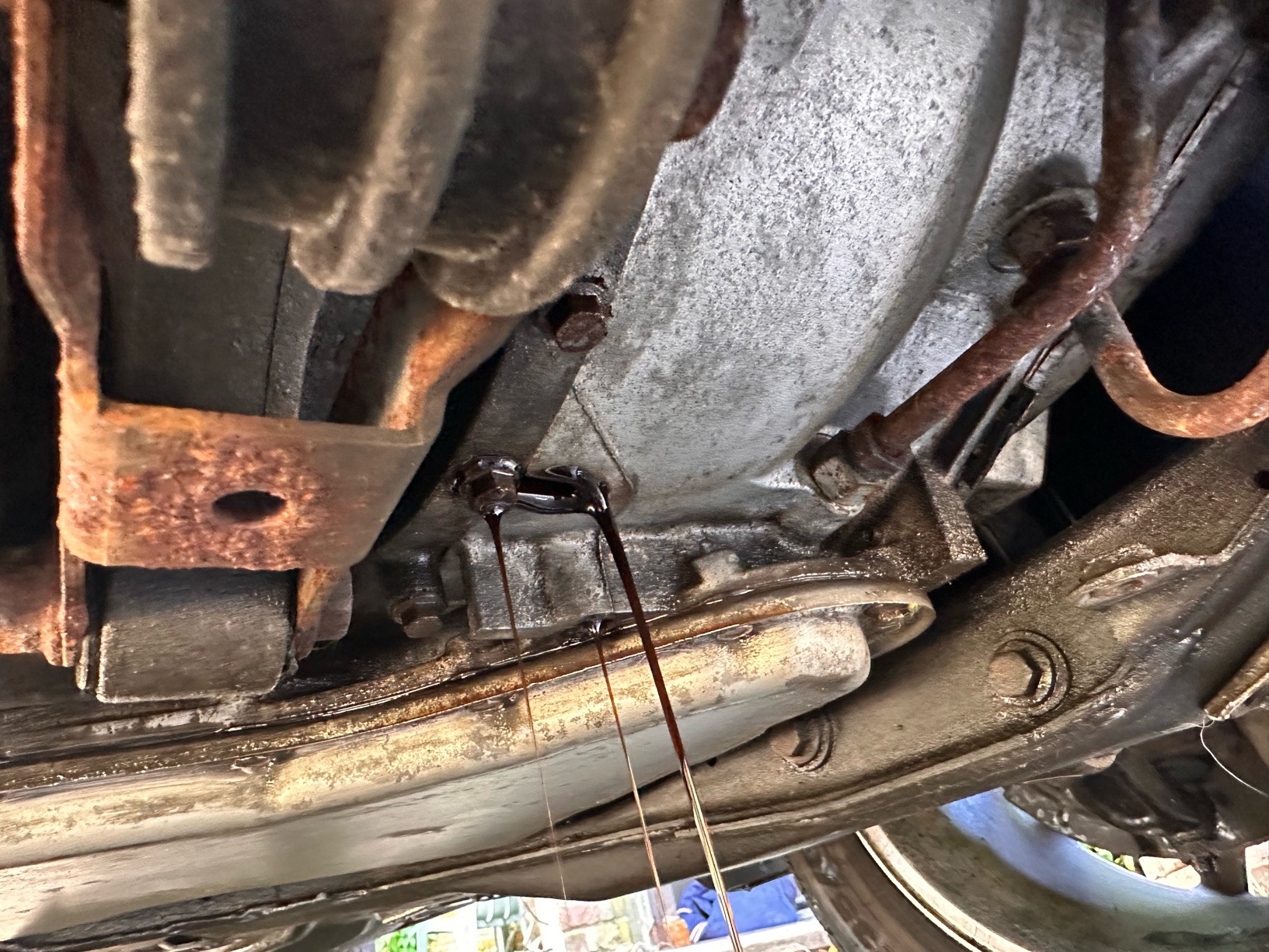

Ive tightened what i can see, and managed to get the car to move in 1st by adding 1L of fluid to the box and touching the throttle, but need to stop the leak before i do anything else. Seems like i will be using alott of threaded inserts / helicoils getting things tight.
Engine oil level is fine. Looks clean. Tranny fluid level is emptying itself. The 3 bolts in line with the leak feel like theyre bordeline stripped. Someone cant use a torque wrench, or has used an impact gun.
Where do you reckon this leak is coming from ?

Drivers side driveshaft
Driveshaft bolt
Driveshaft bolt

On the leak, is the housing cracked? I’d wonder if you pull that middle bolt if it would leak further, uncertain if that bolt needs to be sealed.
