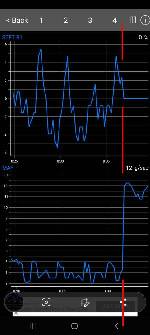

NEW DATA
Today the car has been transitioning to this ready to die state and back a few times. And I was able to record data while it was doing so. Basically, when the car suddenly decides that life is too challenging, the MAF signal instantly jumps from 4g/sec to 12 g/sec, see below marked with red line. Before the moment MAF signal jumped up, the car RPM was stable around 850. And right after it started struggling and jumping between 600 and 400.
Per my understanding, in order to keep stoichiometric ratio for lower RPM, air flow has to be lower, not higher. Right? Also, if it was a bad connection in MAF socket, the signal could only drop, but not go higher. My current belief is that something has either stuck to the sensor and causes incorrect readings or the sensor is on the way out.
Based on the data does the MAF theory sound legit?

Go hunting for a new MAF or junkyard one. These are no longer available from Bosch, so junkyards or ridiculous priced Volvo one are your options.

You don’t get good data during cranking , there are too many things fluctuating both mechanical and electrical. You can try a junkyard MAF ( Bosch for your turbo) but I doubt that is it.

abscate wrote: 20 Sep 2023, 04:14 You don’t get good data during cranking , there are too many things fluctuating both mechanical and electrical. You can try a junkyard MAF ( Bosch for your turbo) but I doubt that is it.
Hello! Thank you for the advice! The data on the picture has been captured when the car was idling. The jump in MAF signal is what it does on its own with me being outside unable to touch any controls. And when it happens, the RPM goes down, not up, it almost stalls.
