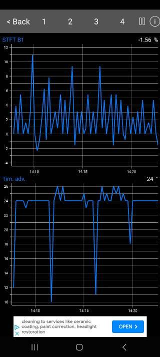

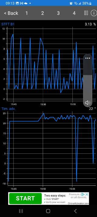

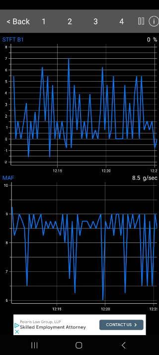

The car is 1999 S70 GLT. Starting today morning it experiences the following symptoms.
0) Check engine light is off. There are no trouble codes I can read.
1) It is needed to crank the engine for considerable time to make it start. May be it is about 3-4 seconds.
2) RPM is unstable, pulsating, feels like multiple misfires, sometimes it is almost ready to stall.
3) When starting cranking, sometimes right at the moment the key goes to position II, RPM needle instantly jumps to a very high value like on GM or Chrysler and then goes to actual cranking RPM. OBD2 doesn't register this jump though, plot is first at 0 and then at idle RPM. When this happens, it is necessary to crank it for about ~2 seconds longer than usual for the engine to start.

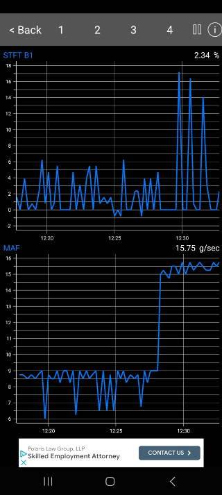

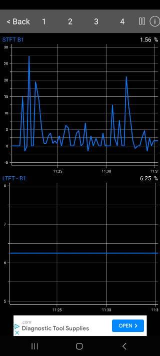

4) When pulsating and experiencing what feels like misfires, STFT exhibits massive spikes.

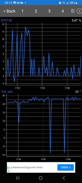

5) Timing advance also shows some spikes.

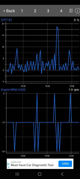

6) Engine RPM signal wiggles up and down and looks like matches to what RPM needle shows.
Please see the pictures attached. BTW, I'm very sorry, I don't know how to make attachment images collapsing/expanding.
I'd appreciate any hint!
UPDATE: The above phenomena was observed at around 9am when it was mild ~70F (19C). Now, at around noon, when it is close to 90F (32C) and the car body and internals are very hot, I've re-tested the car and it feels perfectly fine, no visual issues. The crank time to start the car is <1 second. Data doesn't show any pulsations neither.

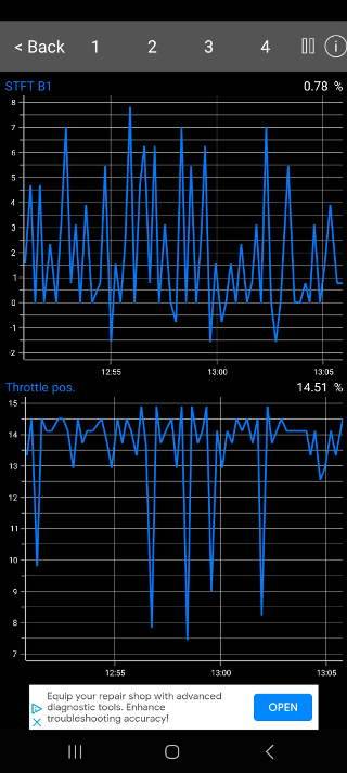

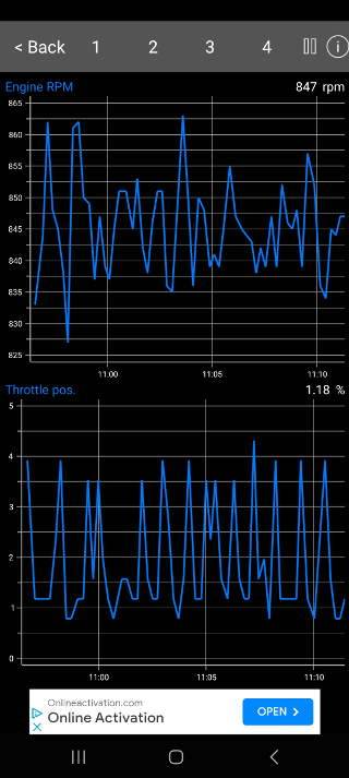

6) When the car was fully warmed up during the day and working normally, it's suddenly lit up the ETS light. I've replaced the position sensor with a contactless one in the throttle body about a year ago. After I've restarted the car with the OBD scanner attached, the ETS light went away and didn't come back but I've recorded the throttle position sensor and RPM data anyway. Please see below.
My suspicion is the two problems (rough RPM in the morning and ETS) might be not completely independent.
I'd appreciate if one could compare it to what it looks like on a healthy car to see if the amount of throttle wiggle I observe is normal or excessive.

Just for clarity, when you said you replaced the throttle position sensor (as in one) was that what you meant or do you mean you replaced the pair (one either side)? Sensor #1 and Sensor #2

Hello!scot850 wrote: 17 Sep 2023, 16:57 Just for clarity, when you said you replaced the throttle position sensor (as in one) was that what you meant or do you mean you replaced the pair (one either side)? Sensor #1 and Sensor #2
I purchased a contactless sensor kit, I guess it is a Hall sensor-based one. The kit instruction was to replace one of the original sensors (on the side with 3 terminals) and override the signal of the other sensor (side with 5 terminals) by routing the wire to the appropriate terminal. I guess, it is to make the throttle module to believe that both sensors are in perfect agreement.
So the second sensor is mechanically still in place, but its signal is ignored and instead comes from the replaced sensor.
And it was about a year ago.
