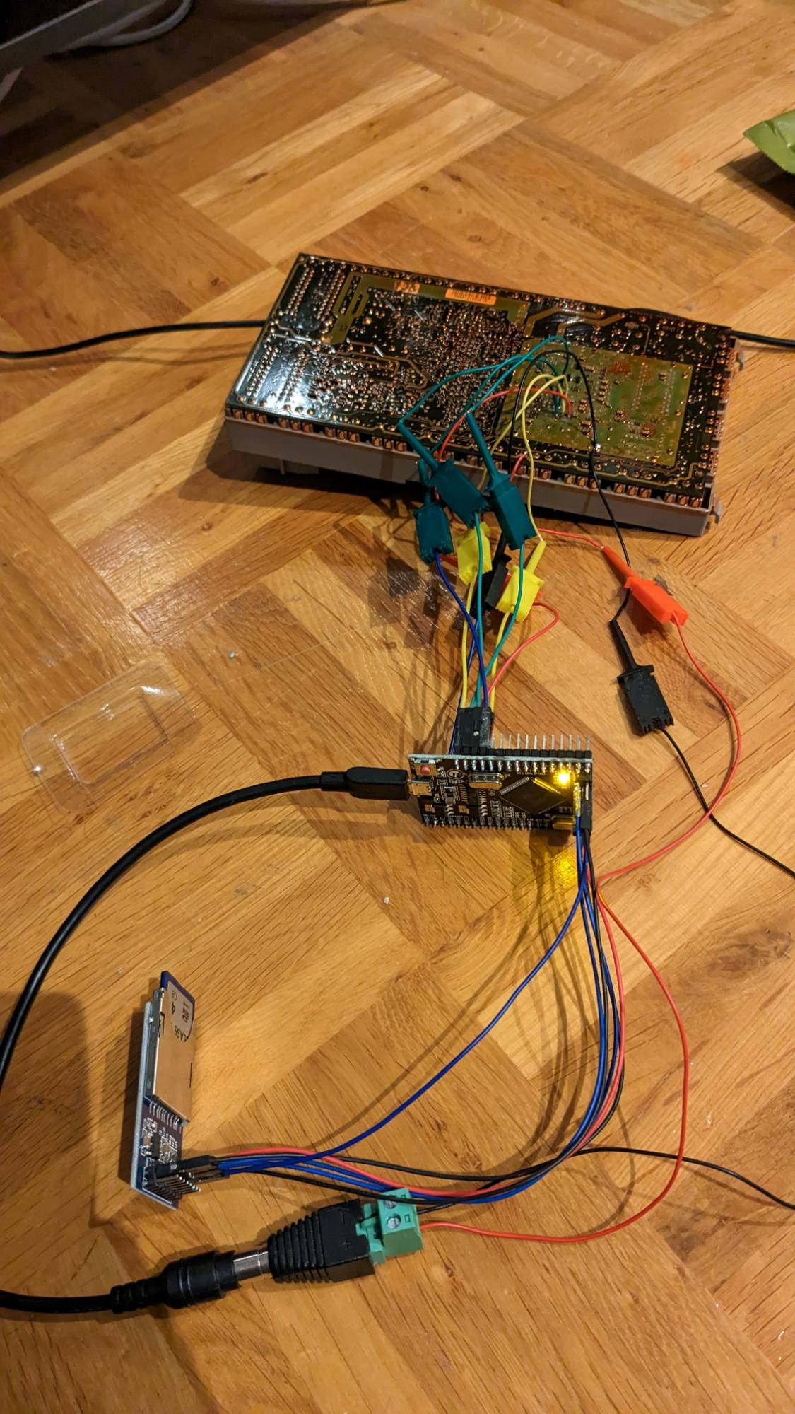

Hey,
I found a Russian forum where someone created a programmer for the brick style CEM with the MC68376 and 29F400 flash:
Russian: https://www.drive2.ru/l/582381898370814 ... 0#comments
English: https://www-drive2-ru.translate.goog/l/ ... r_pto=wapp
Russian: https://www.drive2.ru/b/608492825629183654/
English: https://www-drive2-ru.translate.goog/b/ ... r_pto=wapp
I built the version based on the Arduino MEGA (which doesn't require the LCD) and can confirm that it works.
My russian skills are... limited..., which is why I translated the source code to English.
You can find the sources attached.
Happy hacking :)

You can run it through an online virus scanner like Virustotal if you are afraid I put anything in it that shouldn't be in there.
But since it's just source, text files and images with no executables, the chance of anything bad being in there is very slim. :)

The connections look very neat. It's great to be able to understand more technicalities while repairing circuits.
